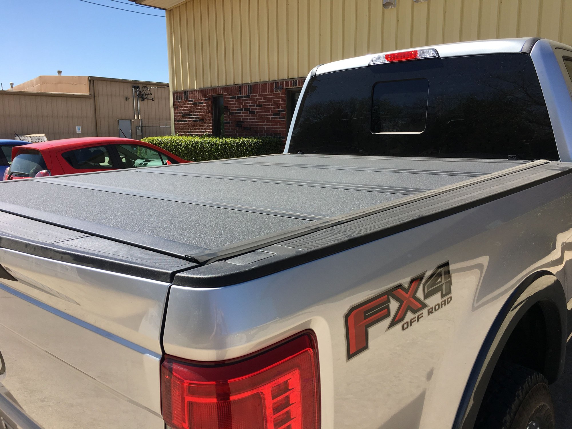

Here is a quick video and photos for reference points on how I did my install. The picture with my knife is pointing to the gap where I used some 1"x1" 1/8th inch thick shims (cut up plastic dealer tag) to get the tailgate to open and shut smoothly and not hit the bed cover lip. It may not be correct because I think the seal under the cover is suppose to sit on top of the tailgate but like you, I didn't like the way it hung up slightly when trying to open and close the tailgate. I go to automatic car washes and always toss my hitch in the back and replace it when I am done and never see any more than a drip or two of water if that.
