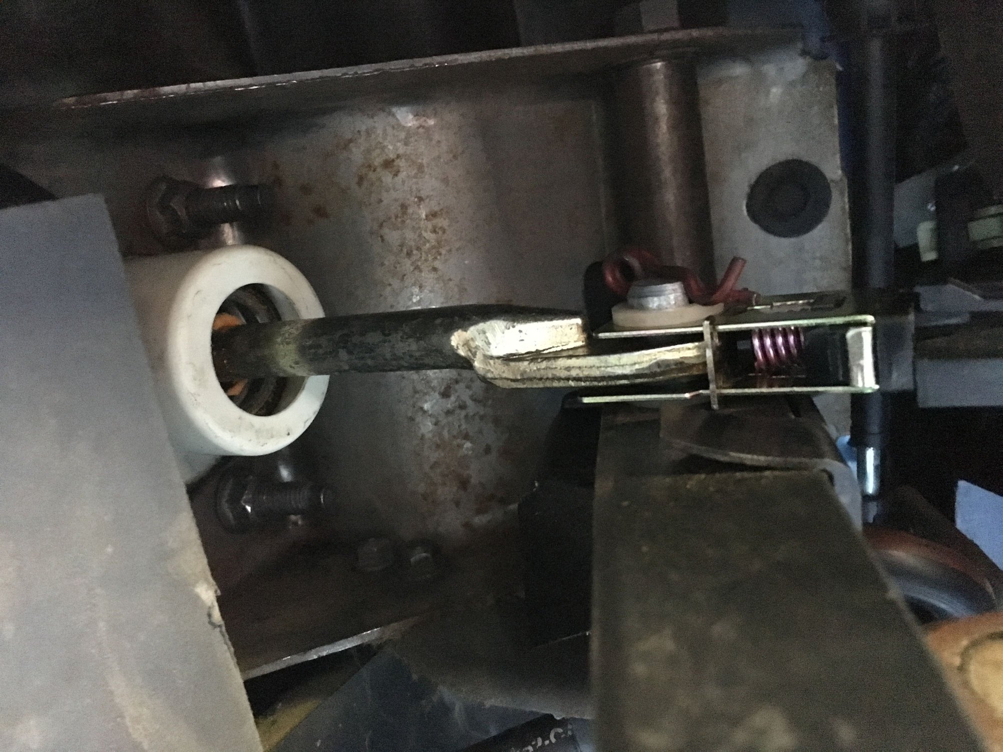

Normally I'd be fine with the pedal travel. The truck does come to a complete stop and stops efficiently. However, the soft pedal is causing my brake light switch to only activate when I'm coming to a complete stop. This has caused some close rear ends and some people yelling at me.

The brake light switch is at the pedal. The soft part of the pedal travel does not seem to have enough force against the brake light switch to activate it.
I thought the way they were set up is that the pin on the brake pedal arm is sloppy in the hole in the brake booster rod. That's how it works. The switch fits snug on the pedal arm pin, and the switch surrounds the booster rod. The booster actuator rod hole is way larger than the pin on the pedal arm. So when you push on the brake pedal, the pin and the switch move forward in the sloppy booster rod hole, and the spring part of the switch ends up hitting the outside edge of the booster rod, and it actuates the switch. After that, all the slop is taken up in the hole, so continued pressure starts applying the brakes.
So this all should happen in the first 1/4 inch of pedal travel regardless of how soft the pedal is as you press harder.

Steve: that is exactly how the brake switch works, however there is not enough pressure for the booster rod to press the spring until about half way down the travel. With the truck off and the pedal pumped up hard, it will activate within the first 1/4th inch. I've since replaced the switch with a new one just in case.

I ended up taking it to our family mechanic for a look and he confirmed that the Brakes themselves were mounted/bled properly and that they were fully functional. He did note that the brake lights were coming on too late to safely drive around.
He added a shim to the brake light that helped slightly but ultimately didn't fix anything. I did some searching on other forums and found that my brake switch spring (Although new) could be too stiff. It was a long shot but I purchased a switch that was designed for an F350. According to some folks, it had a lighter spring that activated much easier. I was skeptical, but when I compared them by hand the difference was obvious.
Hooked up the new switch and now the lights come on with even the lightest tap.
