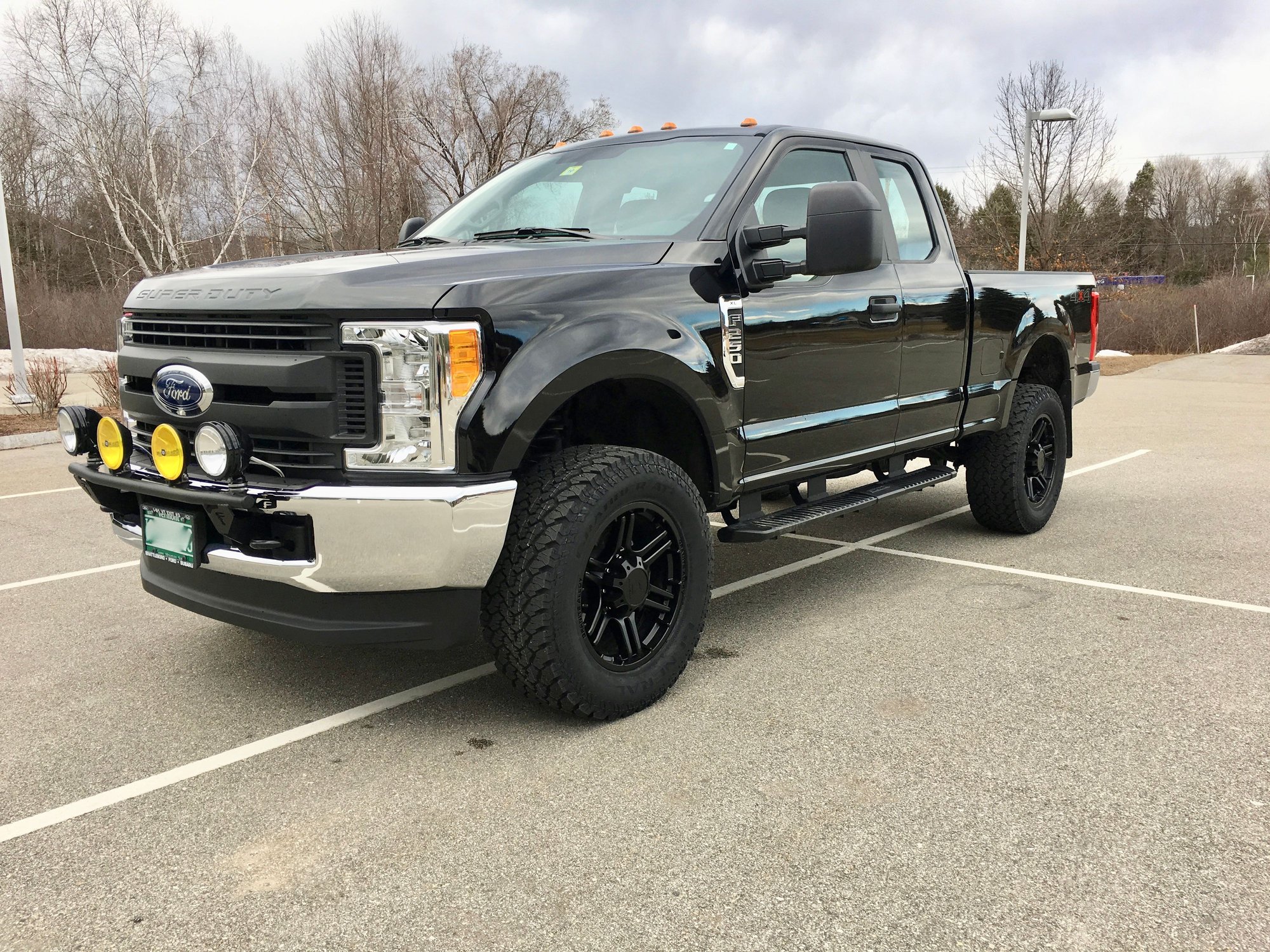

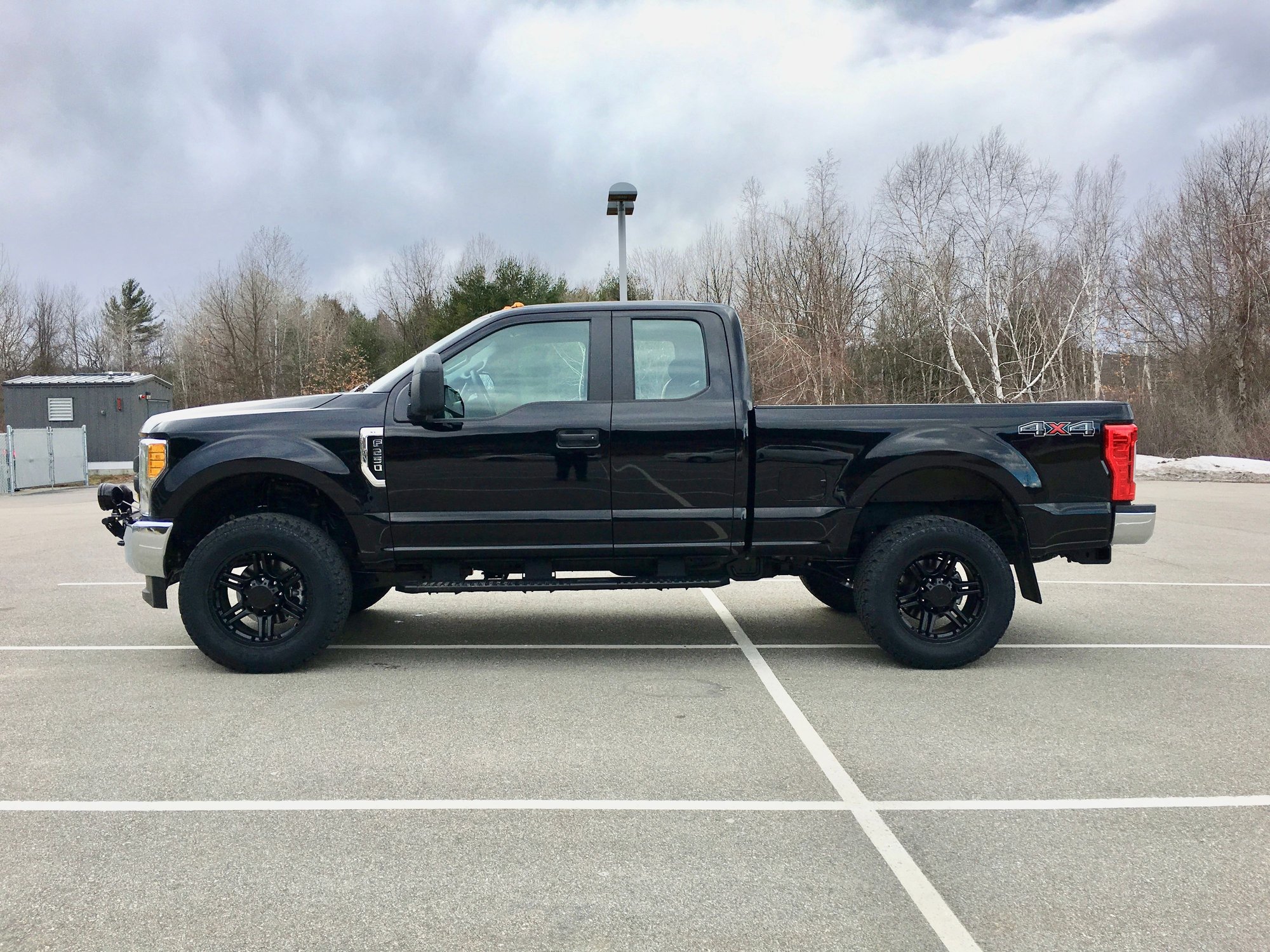

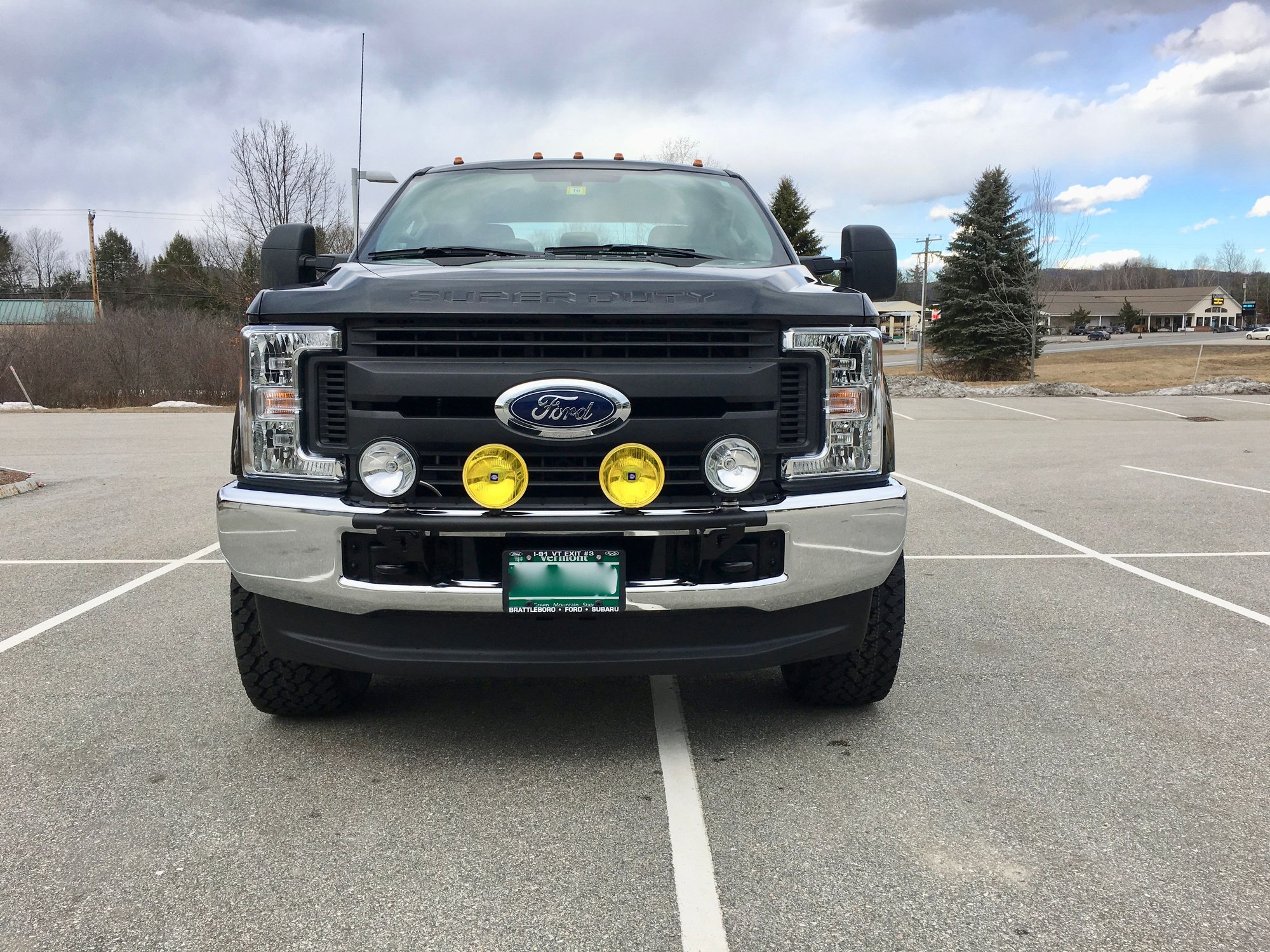

my new 250

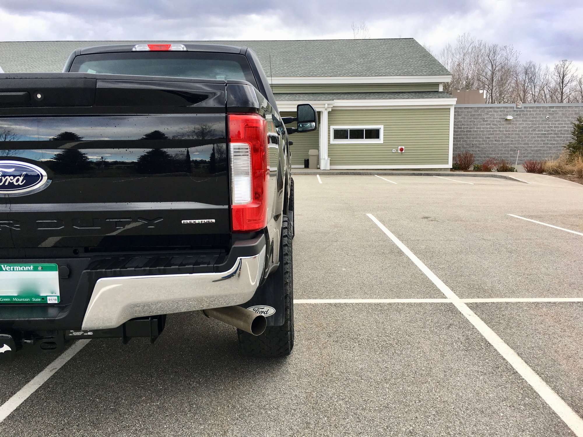

'17 F-250 gasser. I did the N-Fab lightbar with 130w spots and 100w amber drivers, 20x9 Granite Alloy rims (+19mm) with General AT2's, 35x12.5R20's (No lift, no level, no rubbing, but I do have the snow plow package and ditched the front mud flaps.) Mos def my favorite truck ever. Loving it.
Fairly level right off the lot with the snow plow package.
The KC 130w spots are hard core retina burners. The amber drivers are 100w amber Hellas and make a huge difference in snow and fog.
I do like the rims, too. Look better in person, and really makes the truck. And you can't beat $163.00 for 9" 20's at the Tire Rack!
The 35x12.5R20's barely stick out. Visually, I like the offset a lot.
I really dig the '17 Super Duty. Best looking trucks out there, IMHO.

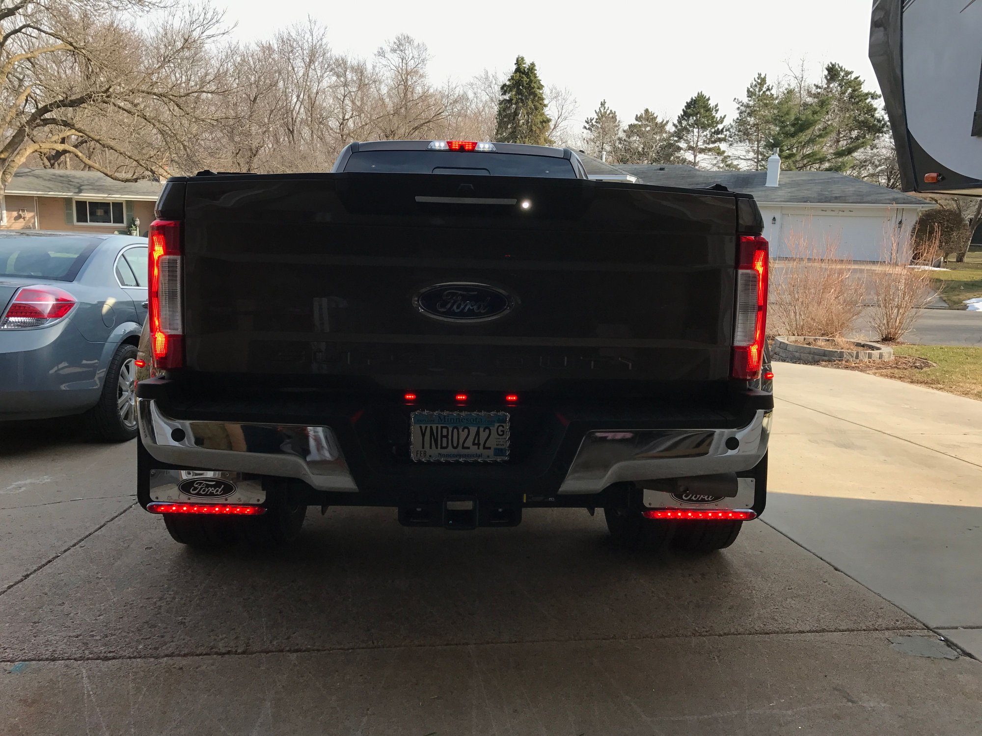

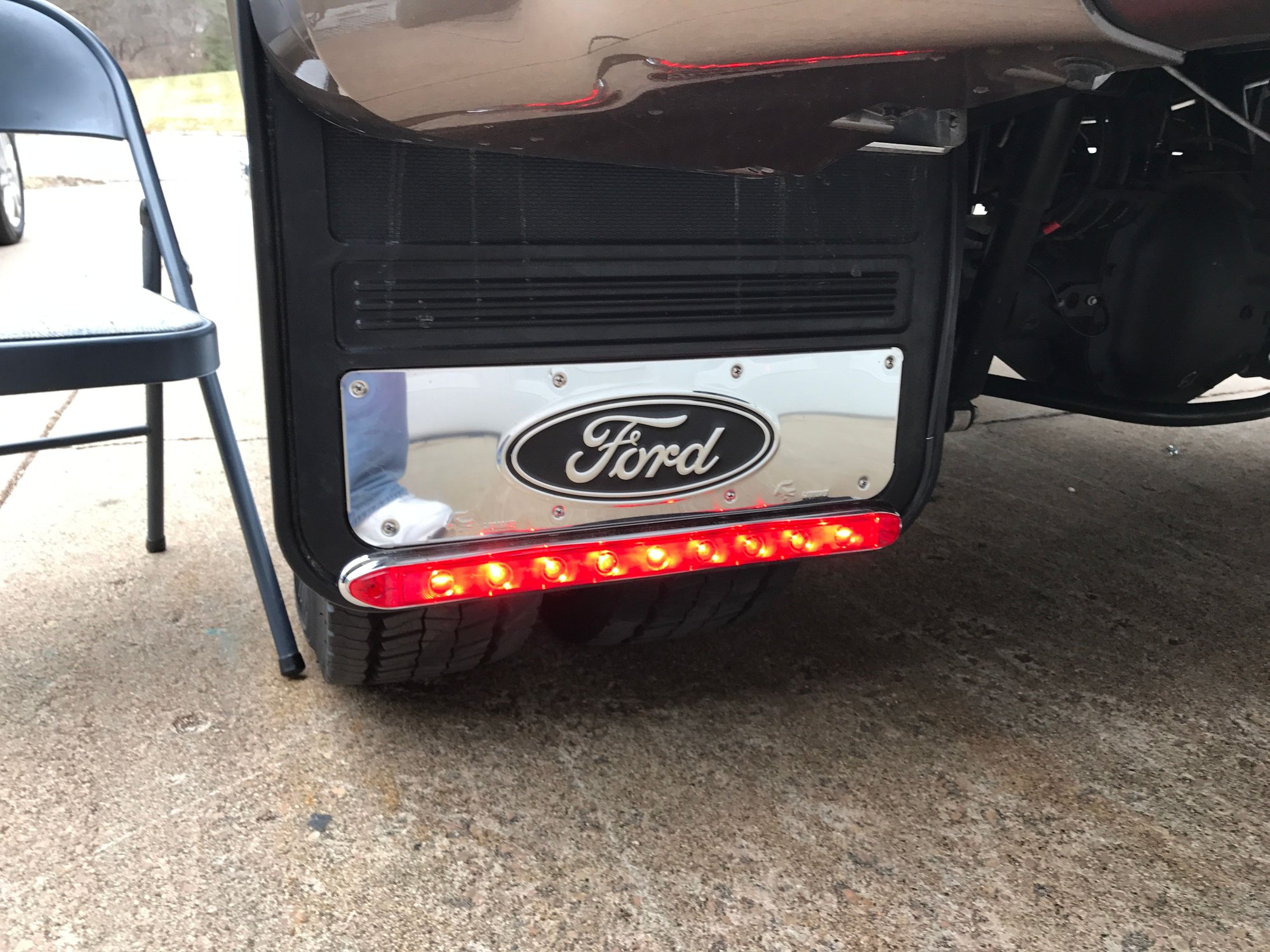

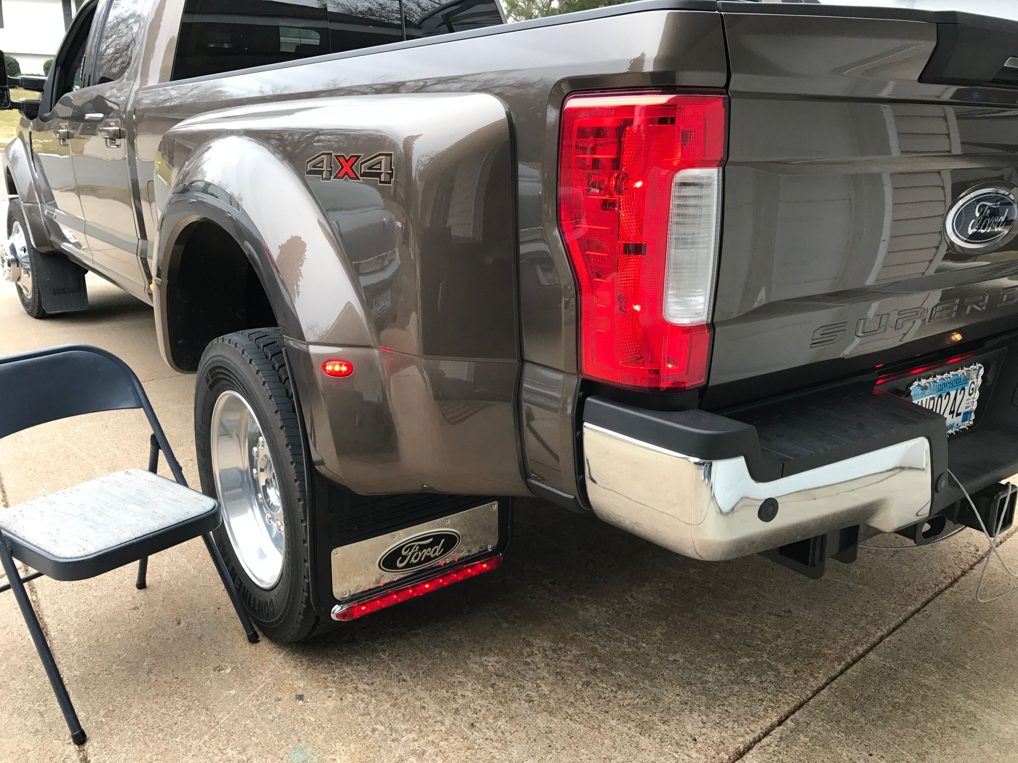

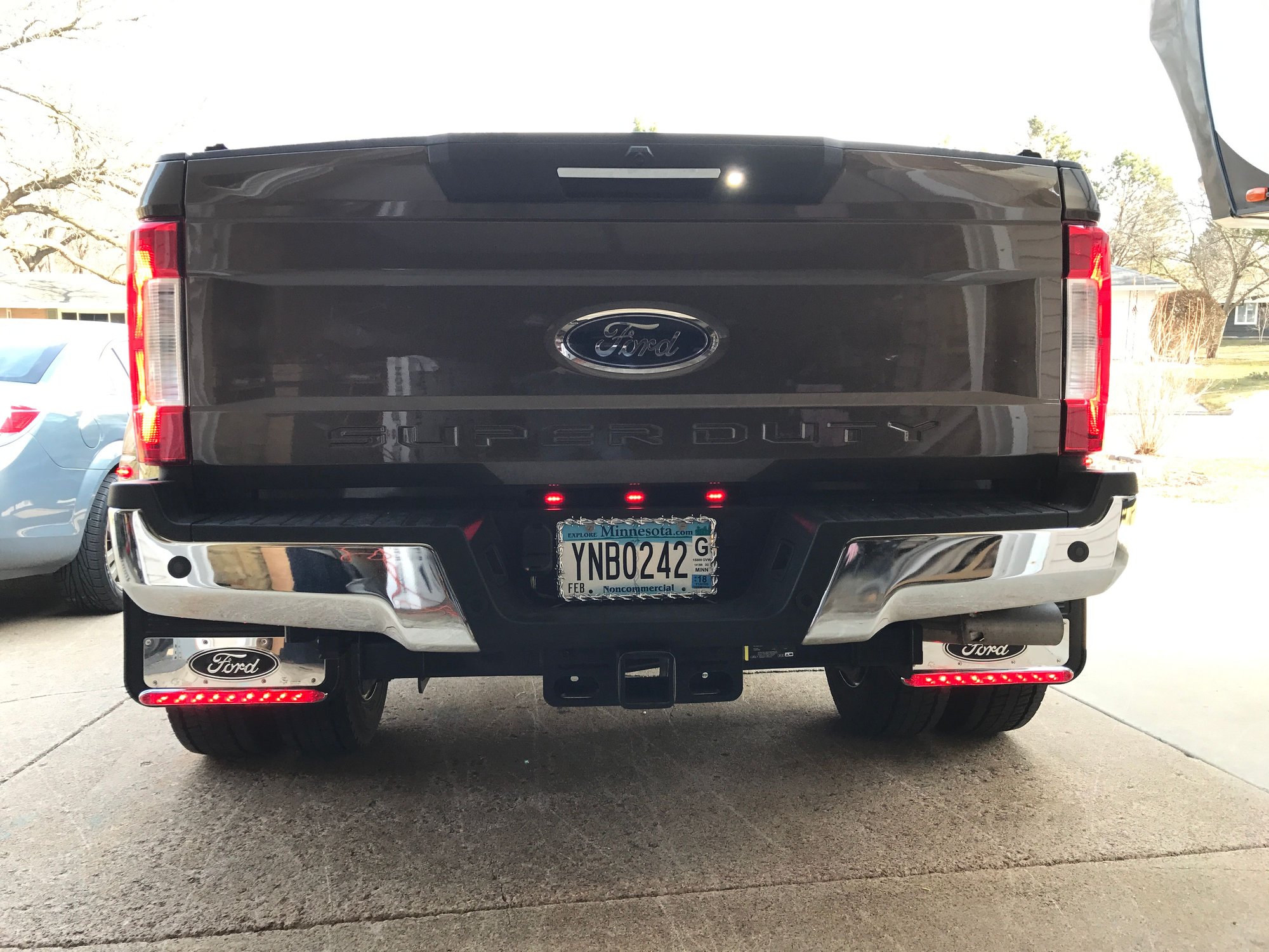

Added light bars to the mud flaps

Looks nice Popeye.. how did you run the wire such that it isn't going to get destroyed?

I ran the wires through 1/4" black pvc tubing and placed the tube in the grove on the edge from under the light up to the mud flap brackets. I had to stake it at the curve with .020 stainless tie wire. If you zoom in you can see it. I had to add one more tie at the top just below the brackets. If you use a needle nose you can push the wire right through the rubber pretty easily.

That is cool, I have seen that done on a lot of big rigs on the front but this is sharp
