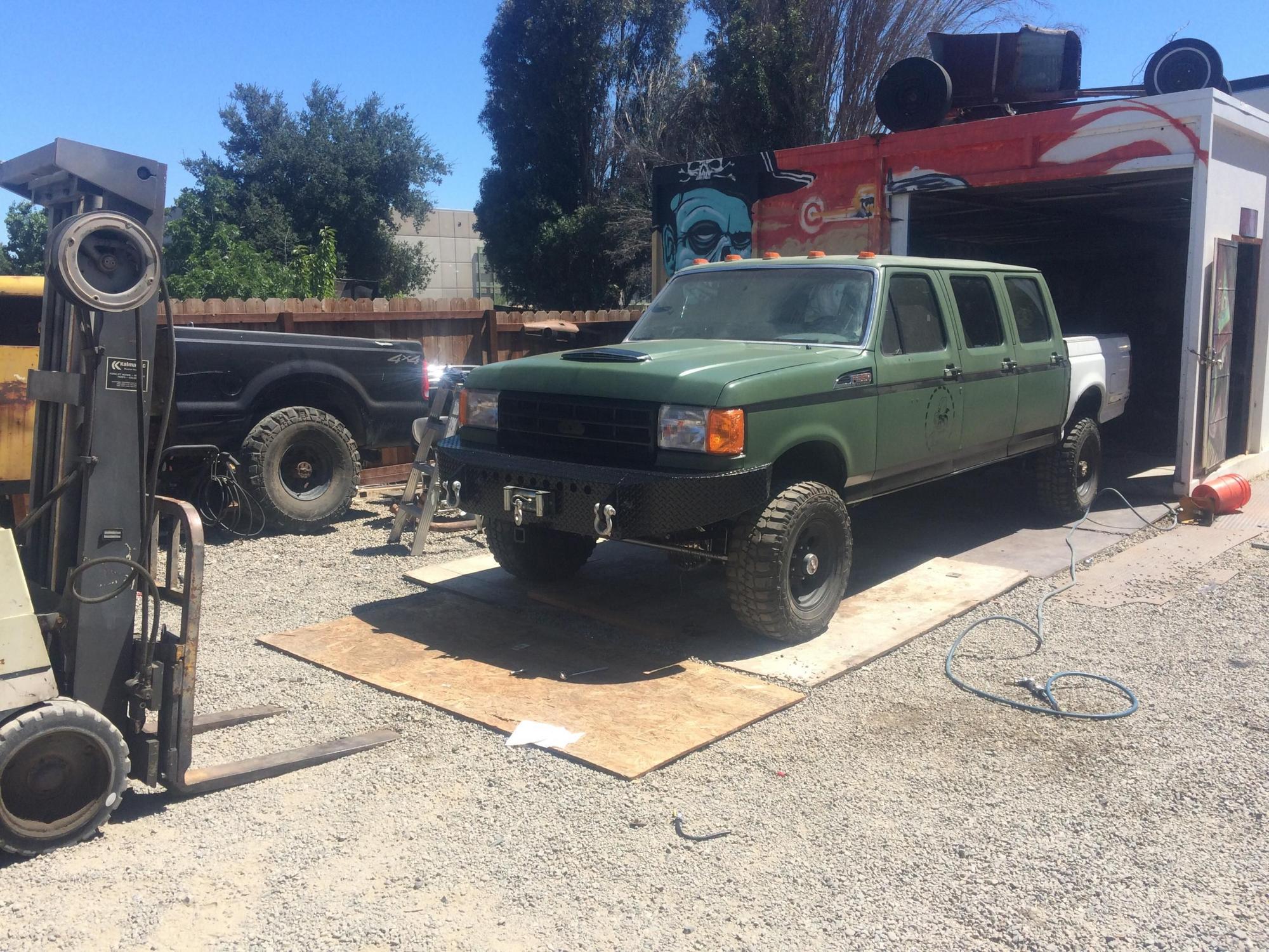

Figured some folks here might be interested in this project. I liked the looks of most aftermarket bumpers but being a fabricator I knew I could come up with something for much less coin. Started with some 3/8" plate and made brackets, they use the huge factory tow loops. Next was the 4" sch40 pipe, that was fun at 21' feet long... I cut it, bent it in the middle and swept the outsides up towards the lights to keep from having to stick a filler plate under the lights. The 1/8" tread plate was cut according to some cardboard templates I'd cut, everything transferred pretty well and I got the shape is was after. I was hoping it would fit the front end like a custom piece and got the gaps just right I think. The center opening is wide and deep enough for a winch, but I don't have one yet. There's also enough room to mount the factory fogs on their brackets and still have room for a winch. Let me know if you have any questions. I'm building 2 fronts and should have enough material left for a rear when I feel like it. Yes, it's heavy.

If I need a battering ram I'll give you a call! Looks good!

I envy your talent. Your design fits the truck perfectly !! I'll take one .. just make it in plain steel, without the diamond plate and deliver it to Tampa. Thats all !!

Very nice job. It's a good looking bumper. I'm curious, how many hours do you have in that project?

Thanks guys. That one sold so I'm working on another one now. Same shape more or less but tried to suck it into the truck 2 more inches, going to be cutting it close on winch room but protrusion is 7", minus the reciever. I may try and get the reciever flush with the pipe and cut an access for pin installation into the back side of the pipe. I guess I could build one in a weekend but I never have that much time to spend on one, just a few hours here and there. Fab work is fun and rewarding at times but good grief it's messy, especially after a bunch of plasma cutting.
