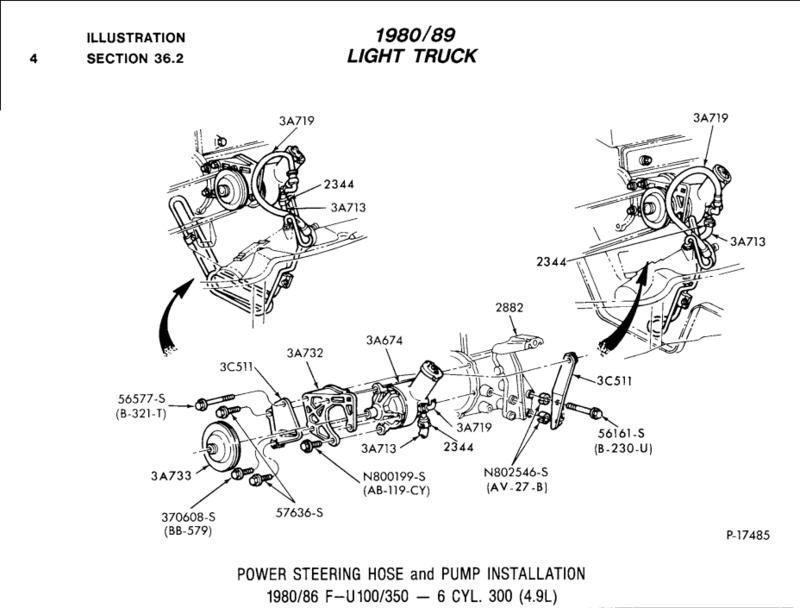

1983 f100 4.9l straight 6. Does anyone know where i can find replacment studs for the power steering bracket that attaches to the timing cover?
Like the ones on the right.

Thanks but I'd like to find the proper studs. It was rigged and caused the bracket to be at an angle throwing the belt. Home cheapo and the auto parts stores did not have it

Posts: 49
It's a 5/16 stud. Not sure what thread it is. Also not sure what spacing is needed between the bracket and timing cover hence the reason im looking for the correct studs.

Hmmm i wonder why the previous owner had a spacer betwen the braket and timing cover when it looks like all that is needed is bolts

They didnt have the right spacer on one of the bolts on the back bracket and added some to the one on the timing chain cover. Took some washers and matched the one for the back bracket. Bought a couple 5/16th bolts for tne front on and all is good now.
