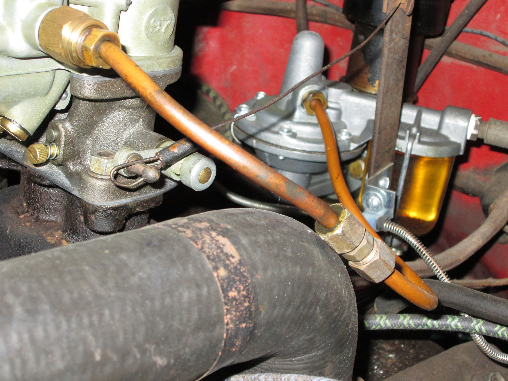

My 1940 1-1/2 ton panel fire engine has a locking t-handle manual throttle to maintain engine speed while pumping. It has a cable looped around the throttle ball connector. I want to adapt the cable to a female ball connector. Any thoughts? Sorry, I missed the cable/sheath end that should have been at the upper right. The cable sheath is anchored to the bracket just visible in the picture.
