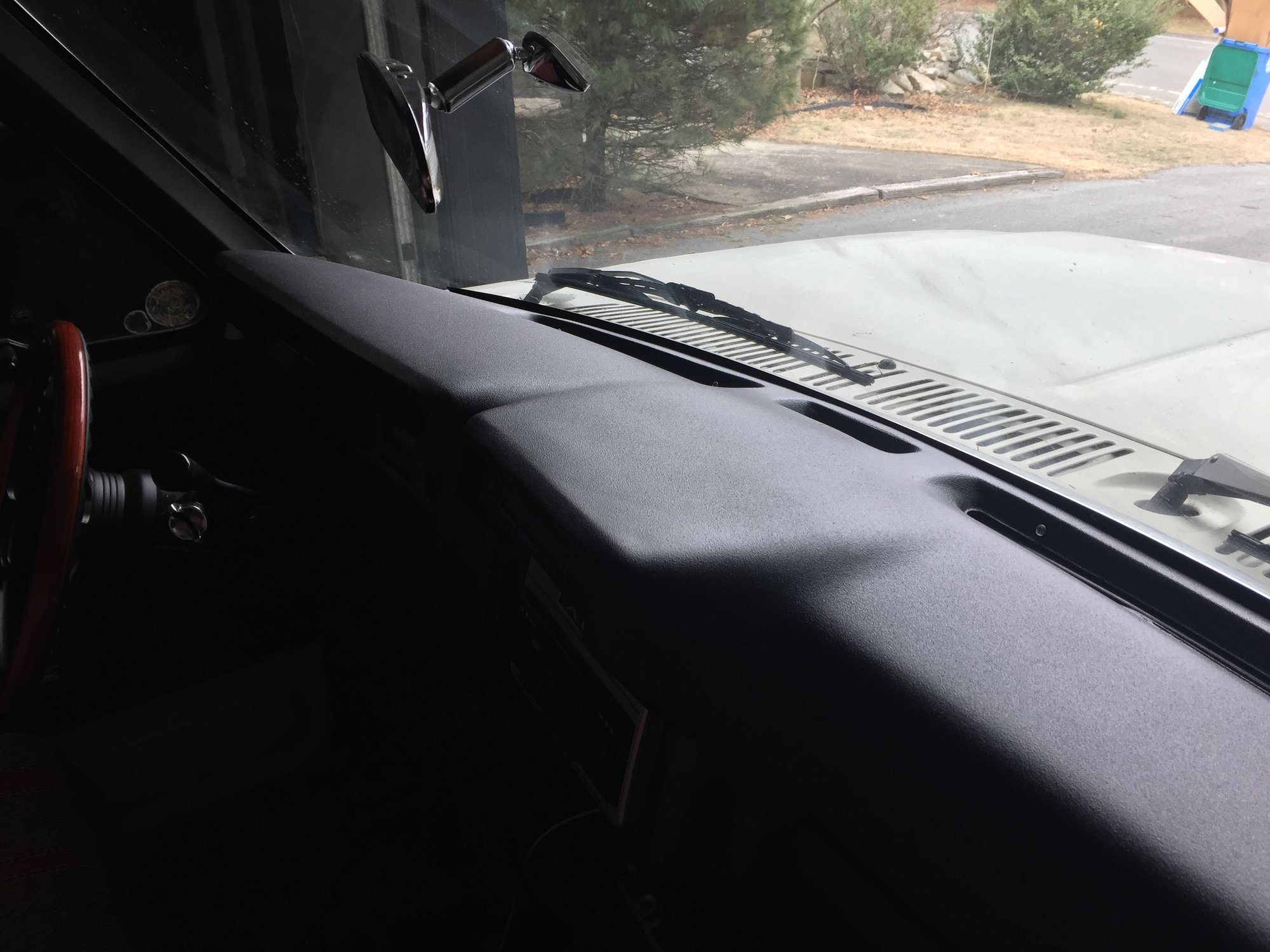

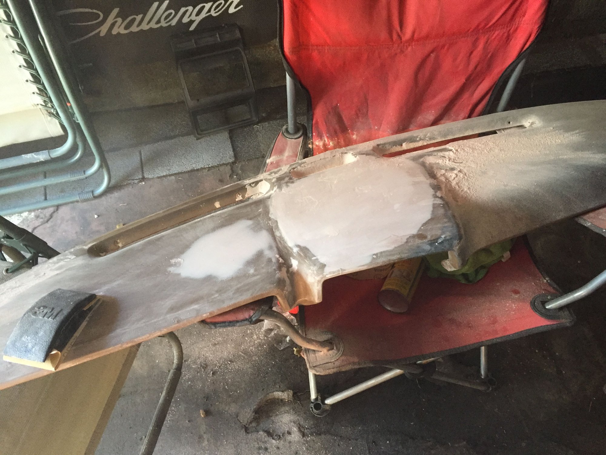

To everyone who asked about my restored dashpad.
Ok here is a few pics of the dashpad restoration I did. Sorry I didn't post them sooner, I just bought a house that I'm restoring and things have been crazy. Anyways, I used Hilti spray foam to fill the holes and cracks and pressed it in using cardboard templates and weights. I then used bondo to fill the imperfections and sanded the whole thing down. I used Duplicolor spray on truck bed liner to mimic a factory texture. It has a pleasant rubbery feel to it. My Bullnose and my neighbors Fiero pic is a bonus lol.

The photos are there, now. Nice job and thanks for sharing. Has the reworked dash been through a Summer, yet? I was just wondering if it handled the thermal expansion of direct sunlight?

Looks good. I'm also curious how it'll stand up to the heat.

Heat review pending lol. It's been through the tale end of summer but not a full blown summer.

Could you paint that, to say blue, or red?

Thanks for the pics. I was going to do the same but intended to spray the pad with red duplicolor. I kinda like that now that I see it.

that is amazing. needs to be in the DIY Section

That's quite good. I imagine that the rubberised texture would 'give' a little in the heat. Hopefully it goes the distance. Let us know.

I got to say that does look really good.
I may have to steal how you did it with a little change......see below.
Instead of using body filler as I don't think it will expand/contract as much as the rest of the pad and crack.
I would first use the expanding foam to fill in holes and get a general shape. Then think I would use brush on seam sealer to coat that, only because I have it. Get it a smooth as you can and do the bed liner over it.
I don't see any issues with painting over the liner as I think you can but as they say "read the label".
