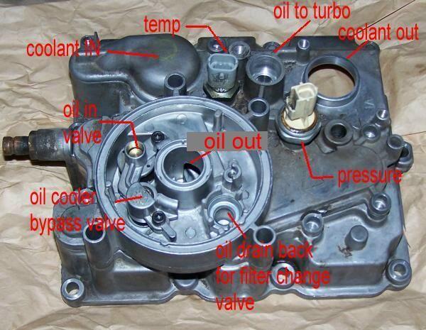

That area is the coolant cap on the oil cooler cover. Where exactly on it is it leaking and are you sure it is oil? That wire looks like it's coming from around the IPR, but the pic is not too clear. Where does the wire go to? I have not seen a wire connection like that near the FICM.

What year is the truck? There should be two gaskets there. There is a cover and a small housing under the cover that is sandwiched between the oil cooler cover and the small cover you can see.

The gaskets you are looking for are labeled the 9N693 and circled 2 and 3. You should be able to get the gaskets separately at the dealer versus having to buy a gasket kit for the whole cooler.
FICMRepair.com has the ovalish looking one: FORD OEM 6.0L V8 OIL COOLER CAP GASKET 3C3Z-9N693-EA
They might be able to help you with the other one too.
Easy to do and hopefully just coolant coming out of there because there should not be any oil at that point. Simple Green the heck out of the area before you do the job.
