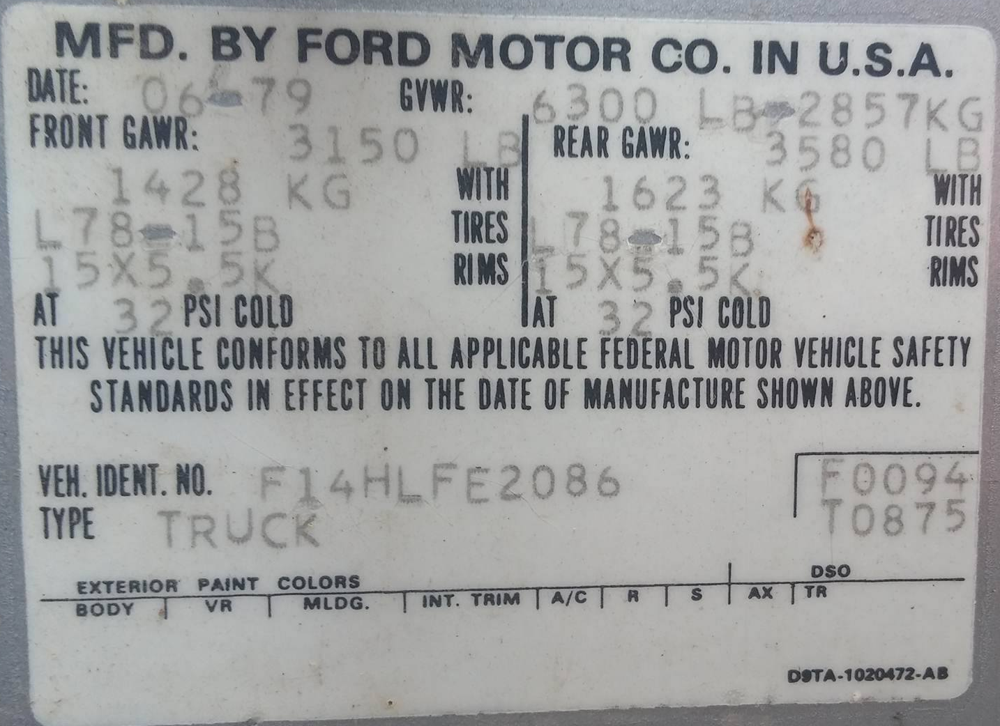

Old Feb 12, 2017 | 08:32 AM
shameless's Avatar
shameless
Joined: Feb 2009
Posts: 555
Old Feb 12, 2017 | 08:50 AM

so how do I know weather its been lifted or not? according to the code, its a L78-15 which is about a 29.3" tire is that right?
