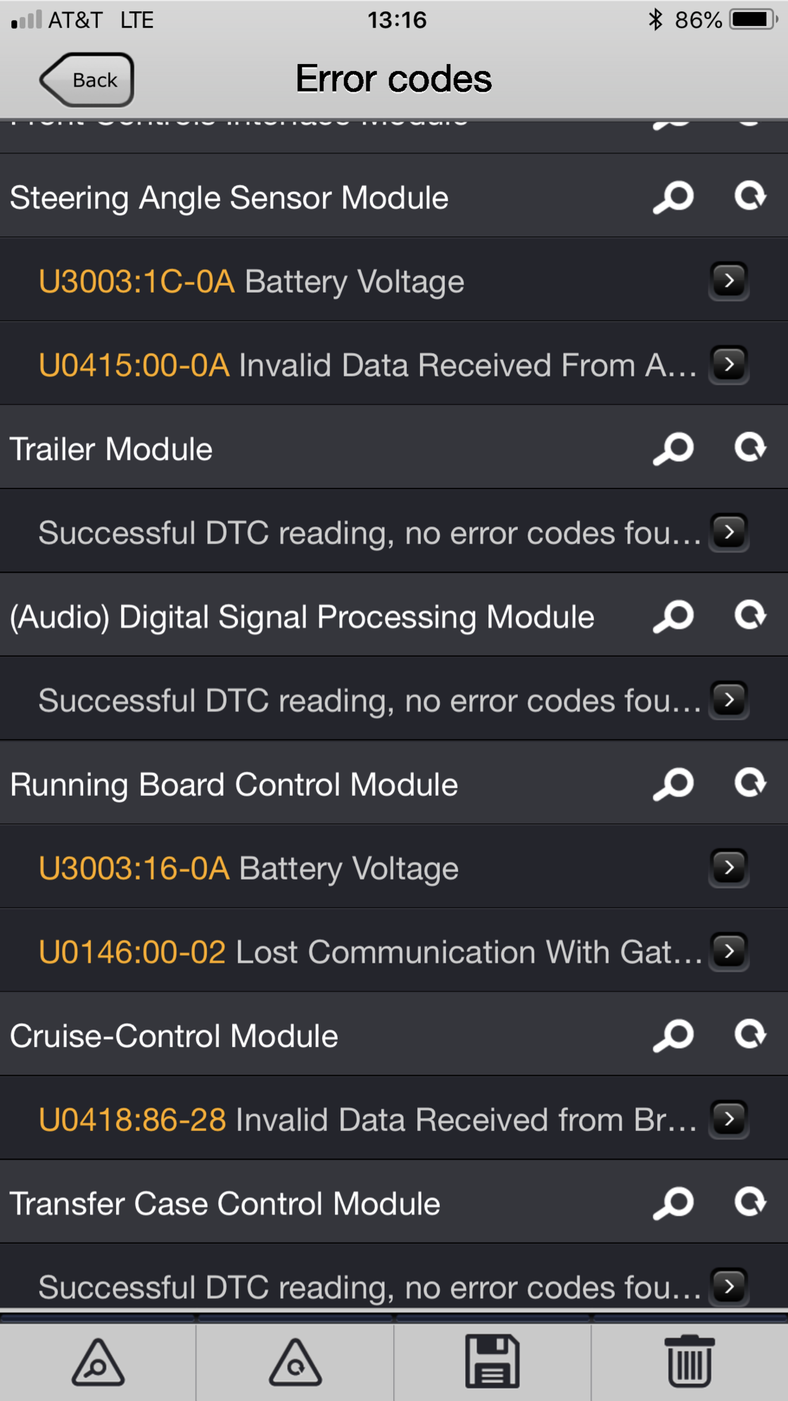

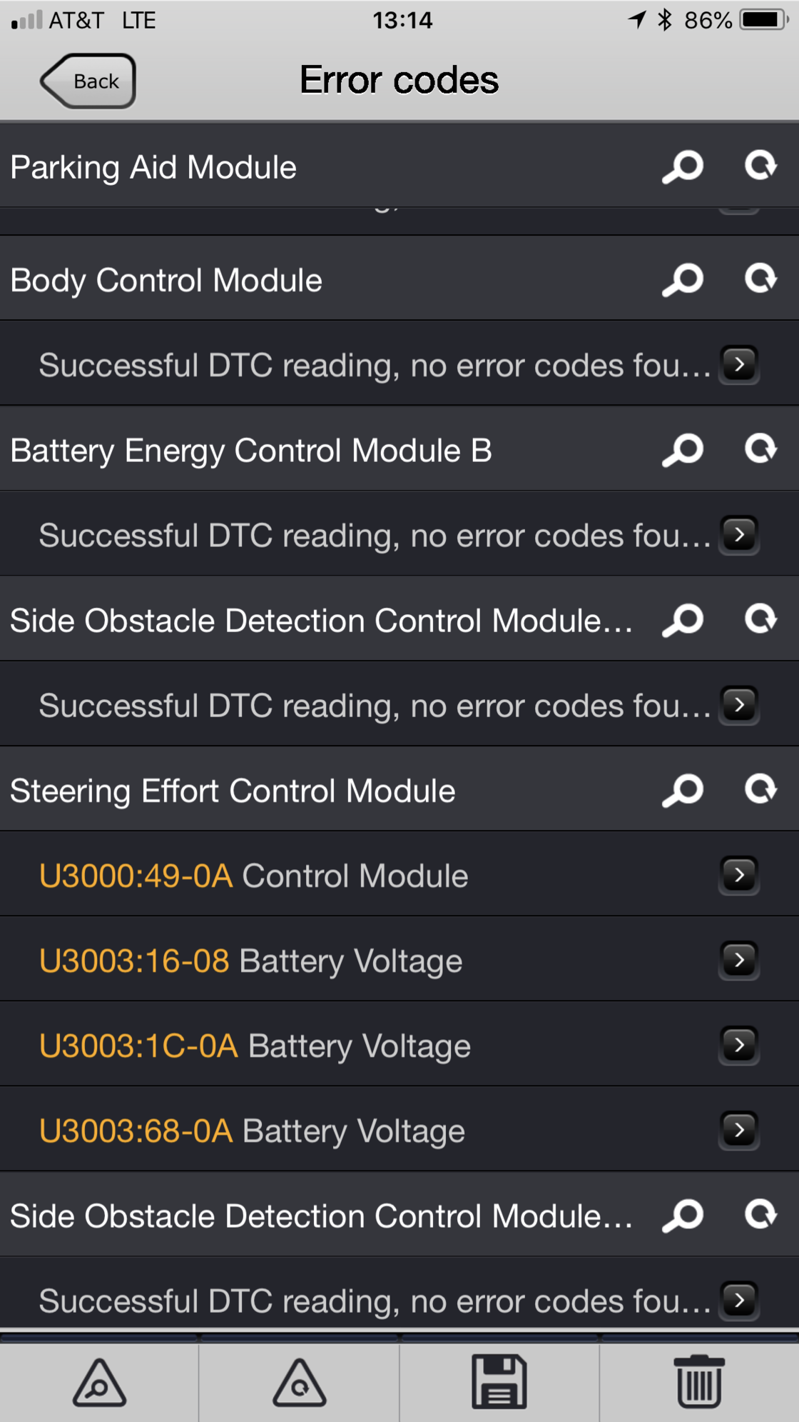

I just got this error today....
It clearly a battery voltage issue (I have been in several times for battery leakage - which I believe is a symptom of the problem).
2017 F350 Adaptive Steering Fault

dealer diagnosis of the Adaptive Steering Fault -
is said to be caused by the lane assist module (located inside the steering wheel) and they have a steering wheel ordered (should be here tomorrow).
I did notice pulling a very small (3 rail) motorcycle trailer that the steering effort was unusually heavy, upon detection of the trailer/lights plugged in.
The steering level/effort returned to "normal" when I unplugged/disconnected the trailer - and the error didnt occur until the 3rd drive (after dropping the trailer).
I had reason to pull the trailer again for several miles (with one bike on the trailer) when I returned it to storage and didnt notice the (previously) increased (heavy) steering effort that time.
