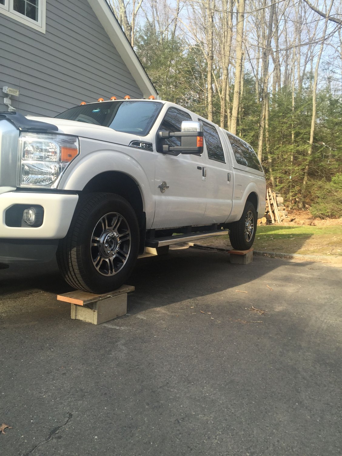

Those cinder blocks under a 7,500 lb vehicle make me wince with pain. Even with the newly enacted import tariffs, a set of four jack stands from China is still a small price to pay for piece of mind.

I agree. definitely get the truck off those concrete blocks. Wouldn’t want too anyone get hurt. Quality jack stands are a worth while investment.

Ouch! Solid wood is better than cinder blocks. Be careful!
