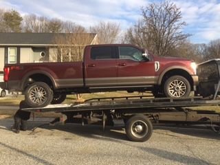

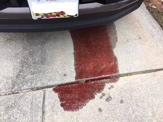

Went out this morning to go to church and the steering wheel would not turn. Backed back into the driveway. We jumped out to get in the other car and look what awaited us.
Came back from church got under her for a bit and couldn't determine (didn't try too hard) if it was a hose or a connection or something else, then called Ford Roadside Assistance. They don't want to come and get it today, since it is in a safe place (my driveway). They were concerned that the closest Ford dealer couldn't work on it and they may have to send it to a further one. Seemed odd to me because it is a Ford and any Ford dealer should be able to fix it.

Bummer, hopefully a hose connection some gomer pile forgot to tighten. Still, if I'm going to have a fluid leak better it be in the steering vs engine or trans. Let us know how you make out with the repair.

Off we went this morning. Good news the dealer was extremely helpful, even though I did not buy it there. A hose came off, they reattached it (correctly) filled it with fluid, bled the system and I was gone in about an hour.

I haven't opened the hood to check (epic fail on my part) but is this a hose connection that I can tighten, like a worm drive hose clamp?
I was told it was a squeeze type clamp, but I did not check.

Glad it worked out sounds like it was on the return line low pressure side
