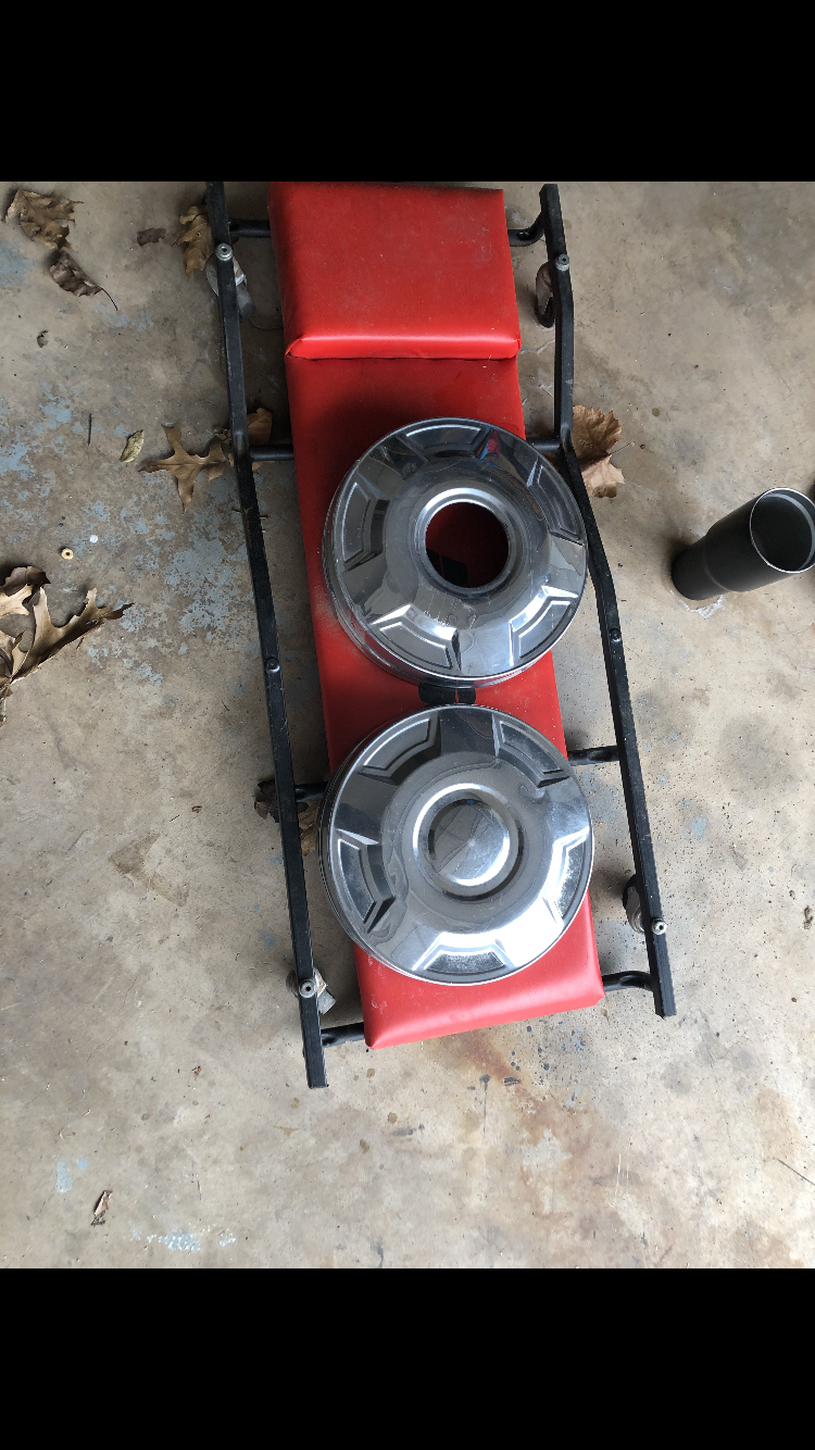

Decided to try something temporarily till I get my adapters
2/4 of the dog bowl caps I have from the SRW wheels
Side view
Painted and “Simulated” for the Dually look. I know I’m not fooling anyone. But hey it works for now
