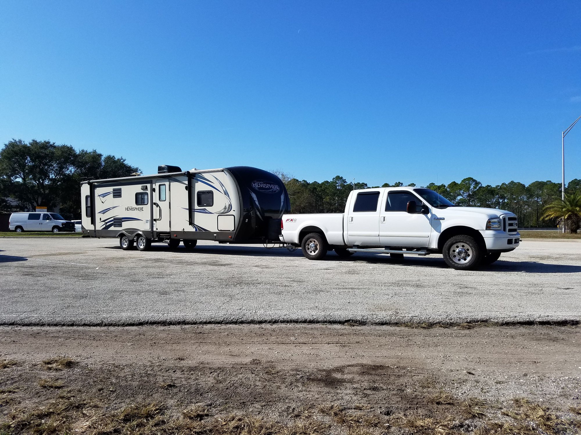

Well, I finally got it on and fine tuned. This was not a 3 hour job. It took me about 6 or so. Kept playing with the stinger height. Man is this thing heavy. But I got it. What I found. I did need need the chain extenders. Also if you don't have the battery in. You will need the cord extension for power from the truck. I'll hit the scales later. After I got it all set. I took it for a couple hour ride up and down I4 here in Central Florida. There is a big difference it the handling. I had the old set up really good. I would still get pulled a little bit when semi's passed. Now I don't get pulled. I can still feel them pass. Changing lanes is effortless. Trailer goes where the truck goes. Overall I am glad I spent the money. Well worth it to me. With the exhaust up grades and the 5 star tune. It pulls awesome. Power is really good. I can now pass also more comfortable. Gears next. Here are a couple pics.

I'll be interested how your scale numbers look.
It looks like the front is a little light, but looks can be deceiving.
I'm glad you are happy with the propride. I've never heard anyone say that they regret the expense, so to me that says a lot.

That pic was an uphill incline. The old hitch gave me a 1" drop. The ProPride goes 1-1/2". By the tape I am within a 1/4" on the front. When I fine tuned in a level parking lot by my house. It drove and handled great. Very impressed with the stability that this thing gives.

Looks like the rear is dropped quite a bit. Why isn't the Propride lifting the rear upwards instead of dropping it more than your previous hitch? Sounds like the spring bars need tightened up more to transfer more weight to the front axle

I'll get it out again soon. Take some pics with it setting on level ground. Truck is going in soon for a gear change. With Eaton true trac's in both axles. Already have it scheduled. Thinking about a set of air bags now too. See what happens.I had the front at about a 1/4". So I could go more on the bars. It rode really good as it was though.
