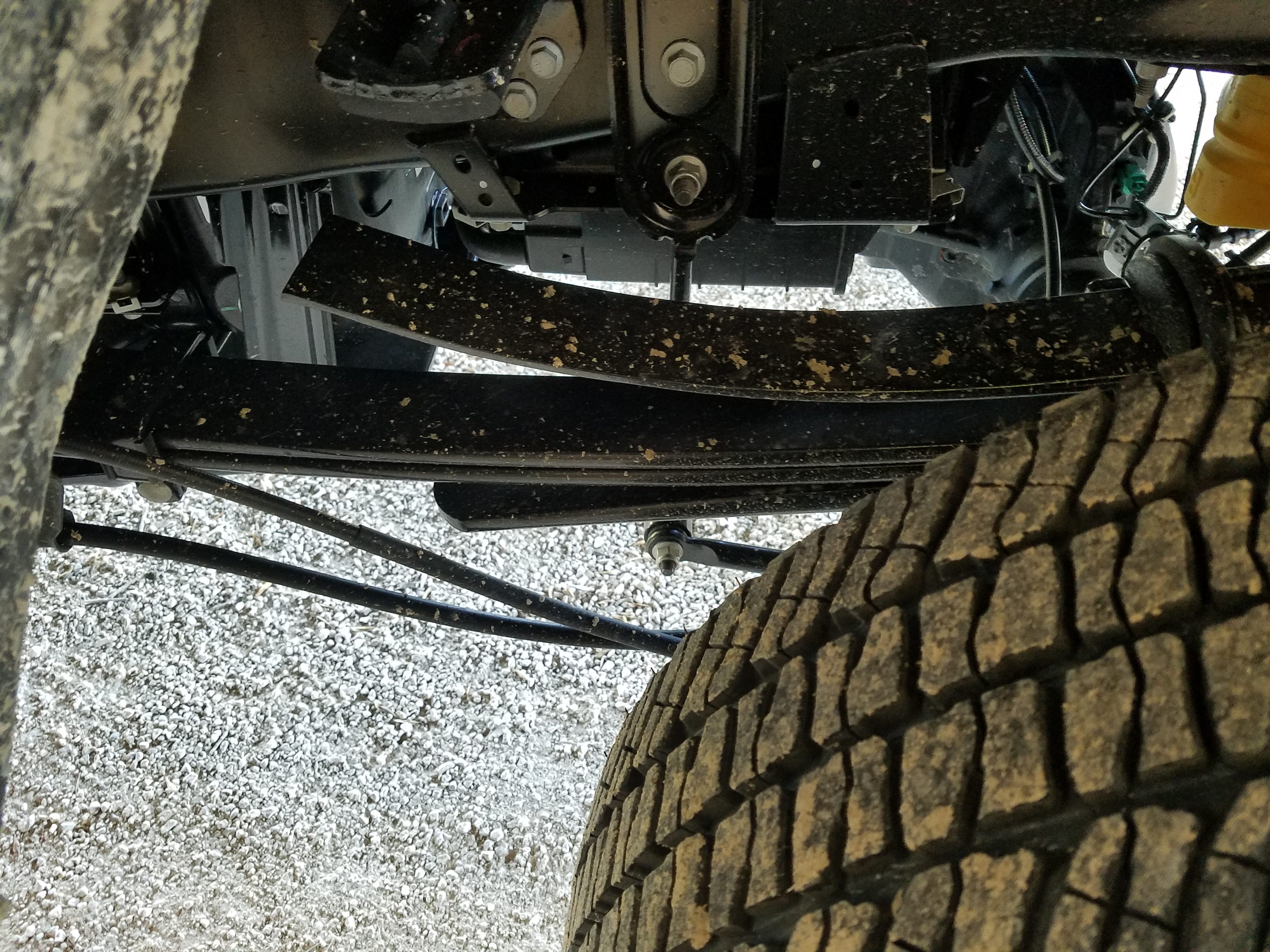

Hi David, I have a 250 CCLB FX4 with the 6.2 and the Camper Package, but no snow plow prep. Let me see if I can answer a couple of your questions:
- Slide in camper cert does not affect GVWR. It is just a piece of paper saying the truck is certified for X, Y, Z pounds/ratings. These will change according to your specific options ordered and the rated payload of a specific truck.
- The Aux springs from the camper package are just overload springs. Here is a picture of my rear suspension:
- The rear sway bar only affects sway, and won't have much if any affect on the ride quality.
- I have only driven a CCLB with and without the camper package and could tell no difference between the two as far as ride quality. My truck has the 5200 lb front GAWR.
- The size of the wheels/tires and wheelbase will probably have a much greater effect on ride quality than the specific spring package - I have the 17" wheels with the 245/75 Michelins, and so did the other truck I drove without the camper package, so the comparison between the two was overall pretty equal.
Let me know if you want more info about this, my truck is a uniquely optioned XL model I had to order to get exactly what I wanted.
Attachment 171311
Hello 17CCLB250, Thanks for your input, it is very helpful. As I mentioned above I have been debating the Plow Prep but have been hesitant because my wife has had Spinal Fusion and is sensitive to constant jarring so I was concerned about the stiffness of the ride with the max springs. I do not have a slide in camper, but thought that the mid weight springs in the Camper Package would be nice compromise for capability and ride and the rear Aux Leaf spring would be nice for towing a gooseneck to reduce squat.
The only question I have to get answered yet is if I order the Camper Package will it prevent me from getting the Gooseneck Prep package? If they can't be ordered together I will probably just order the Heavy Service Front Suspension package which also comes with the mid weight front springs.
Thanks again for your reply.
David
