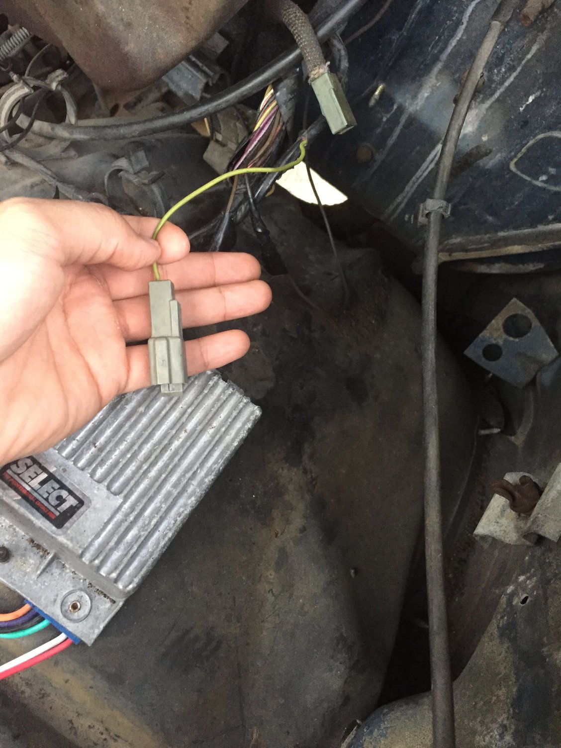

I found this wire hanging loose outside of the firewall. I mean its lime green and not being used should that work?
Yes, you have located the correct circuit; that plug there is to power the optional underhood lamp (pic below). If you look at that wire closely, you should be able to discern two colors.
That same circuit exists inside the cab, just gotta trace that wire.
