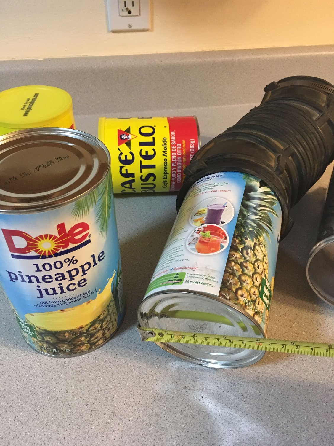

I know, but I've been meaning to make a boost leak tester for a while now. Last time I tried to find PVC at the hardware store with no luck. This time, I tried the grocery store!
