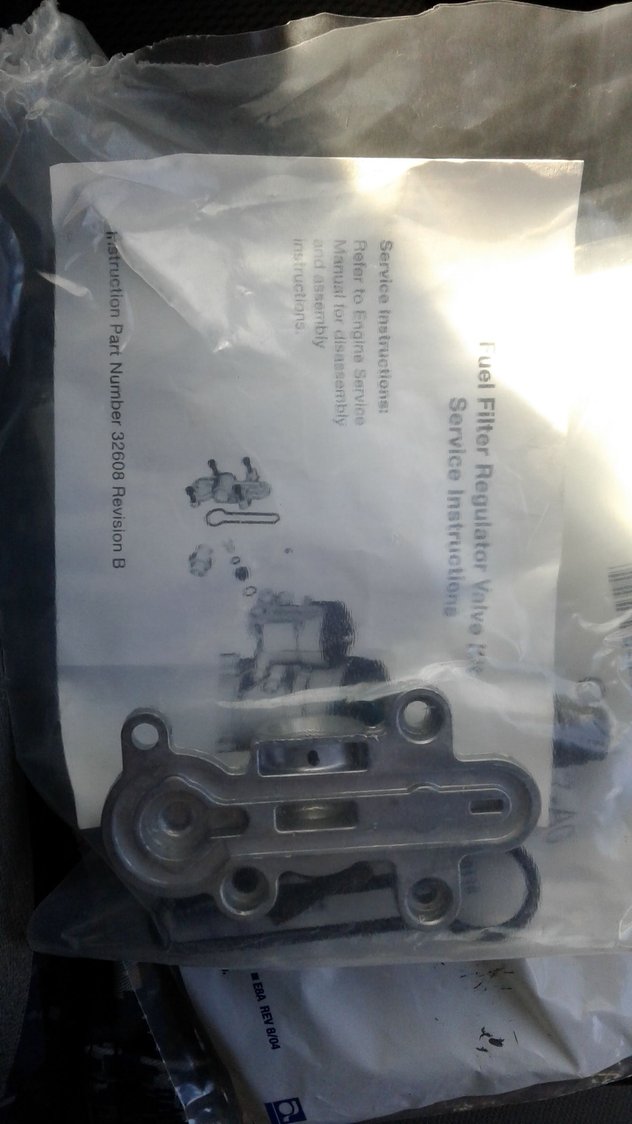

Found this from a local seller. He purchased his new truck and found his new one already had it. So now this is going on my truck finally. I already had banjo fuel bolts so I would think this will help?
Anyone with experience on installing this should I be looking for anything in particular when I do and assuming it's pretty straight forward with exception of small parts?

I knocked out mine pretty quick with no issues. Only thing I would say is when you're lining it back up with the spring in there, just be sure to evenly apply the pressure as you push the housing toward the bowl so you do not kink, bend, or shoot the spring out. And no need to go ape**** on the bolts because I've read of guys torquing too hard and breaking them.

The kit probably comes with the small o-ring seals. Be careful as you break free and remove the fuel line - there is a small o-ring between the two couplers, have your hand/fingers below for when it drops.
Looks far more intimidating than it is, very easy to accomplish in 20~30 minutes.
Also, as you pull the pigtail connector off of the EBP sensor, look for the yellow plastic pin alignment cage, just don't drop it.

And you probably won't be using each and every o-ring in the kit. Just use and replace the ones you can match up, chances are the kits are made for a lot of different applications but just easier for them to package it under one part number/kit.

And the old spring could be yellow.

You'd need a gauge to tell and the idea is to not let it drop below 50psi as 45psi is the lower limit on injectors. Banjo bolt won't make any difference, the flow rate is minimal.

I'd do the blue spring regardless of whether you check fuel pressure before or after. It is a Ford updated part for our engines. The 6.4 banjos are not...
Another way to do the bluespring is to take off the fuel hard line hold-down on the head. You don't have to break the fuel line nut at the cover that way...
