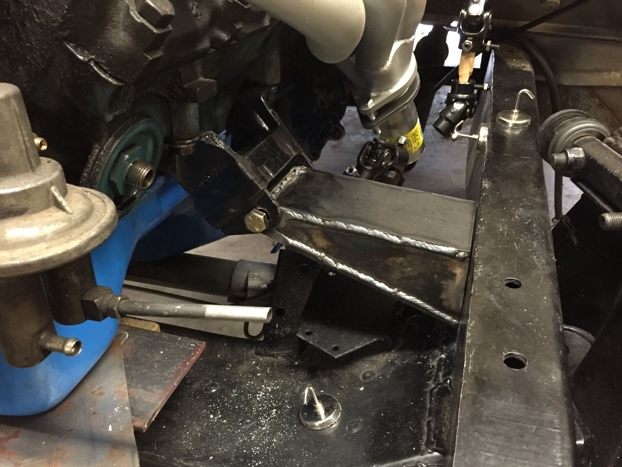

Do you have photos showing what engine you mounted and how you mounted it?

Engine mounting
i actually made a video of the engine mount process and just need to finish editing. But Here are some pictures along the way. Noting that I boxed first.
Template mockup with cardboard

Thanks TZ, would love to see the video when you have it done. Are you going to You Tube it? Do I see a modified stock front axel used for a modified cross member back there?
