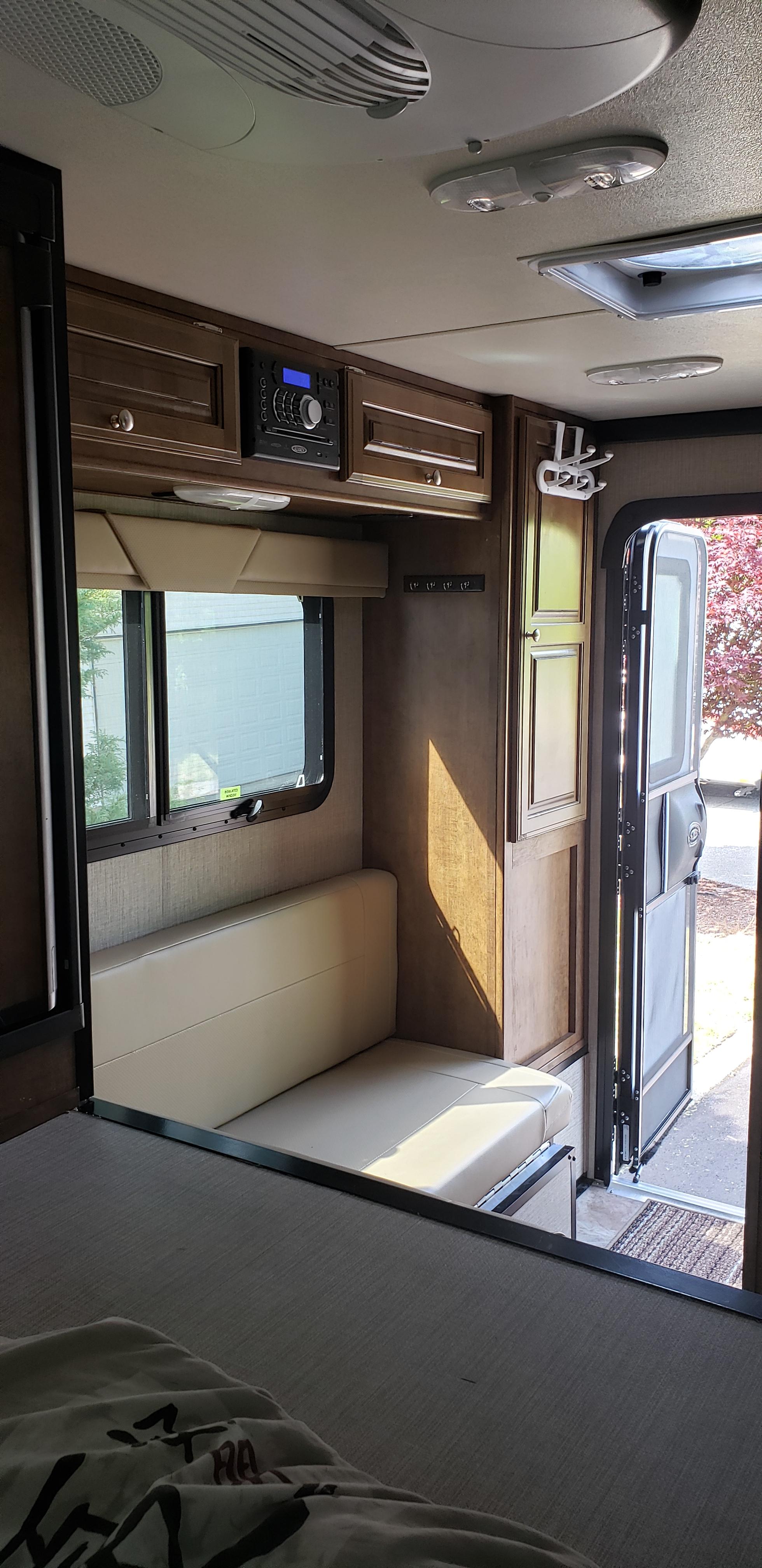

Steve, here are a few more pictures. It's a small camper, but great for just me on long roadtrips. We have a travel trailer for when the Mrs wants to travel.
​​​​​​Attachment 280320
Attachment 280322
Attachment 280323
Attachment 280324
Attachment 280325
Dry weight of under 1800 pounds before optionsAttachment 280326

Tony that camper is completely amazing right down to the Ford emblem in the upholstery. Woodwork is dynamite. Very well done that speaks completely of being first cabin.
You are a lucky man to have this. Thanks for the pictures. BTW, did they make one in a long box model?
