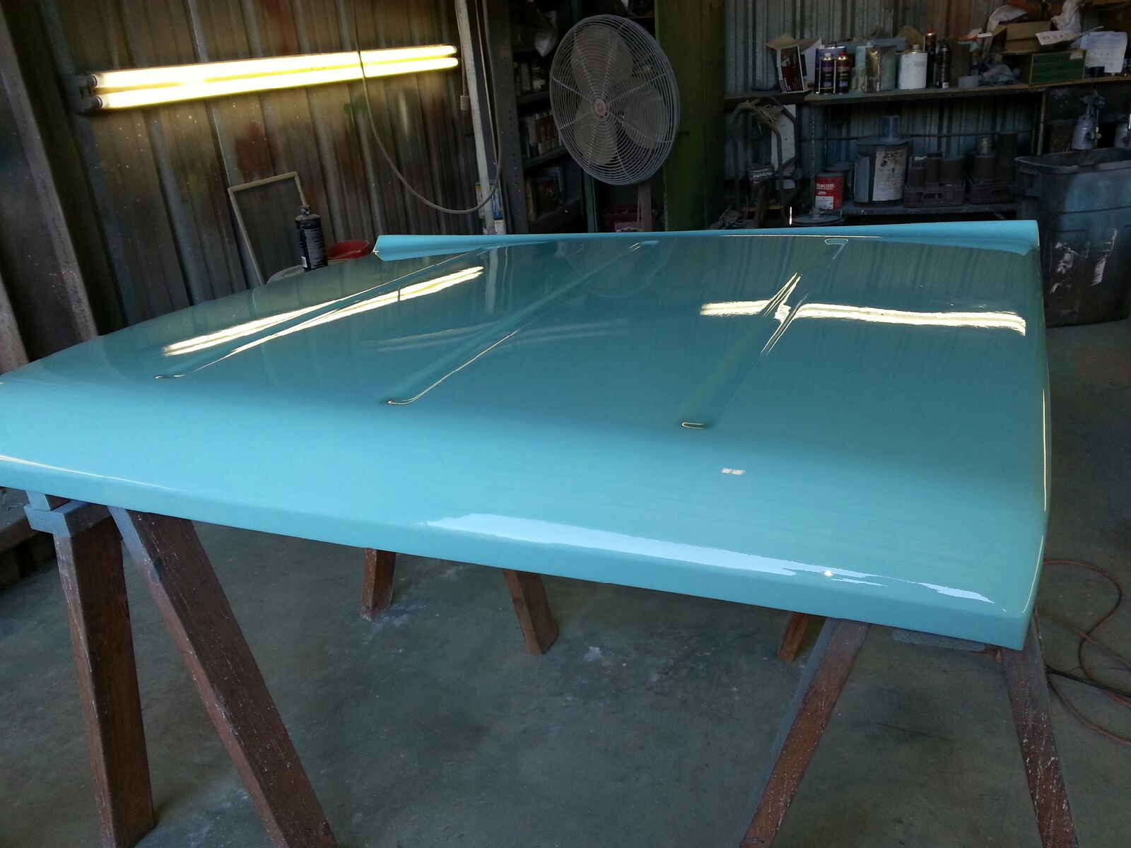

before any color sanding
I've used a sharp #75 since the early 80s and always had great results...... until recently I tried to spray some Sherwin Williams basecoat clearcoat . The guy at the store told me the gun I was using would not spray the new paint as well as a new HVLP gun. I was skeptical thinking it was just sales talk. A while back while at harbor freight I had a coupon for their HVLP purple spray gun for $4.00 . I took a chance and bought it. Now , I'm pretty set in my ways but the new gun works way better at atomizing the thicker paint. I went back and bought their top of the line gun for $ 69.00 , so now I have one for primer and color ,and the better one for clearcoat. I have since retired all my old spray guns.... never thought that would ever happen. I did research on all the new guns and by what I read, the Devilbiss was the best , although I don't own one. The HF guns work very well for the part timer like me.
