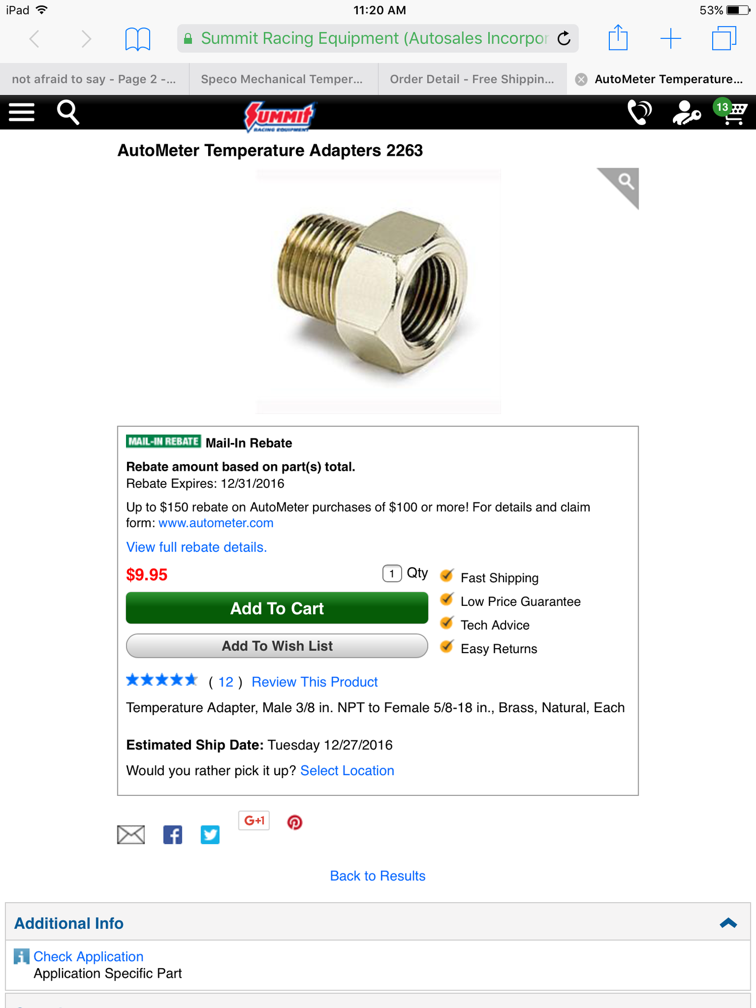

I found this by chance just now.
Adaptor
5/8 UNF x 3/8 NPT - Ford & Chrysler V8?

Old Dec 25, 2016 | 12:21 PM
PapaBearYuma's Avatar
PapaBearYuma
Joined: Nov 2011
Posts: 3,354
Likes: 49
From: Great American SouthWest
Old Dec 30, 2016 | 05:55 PM
