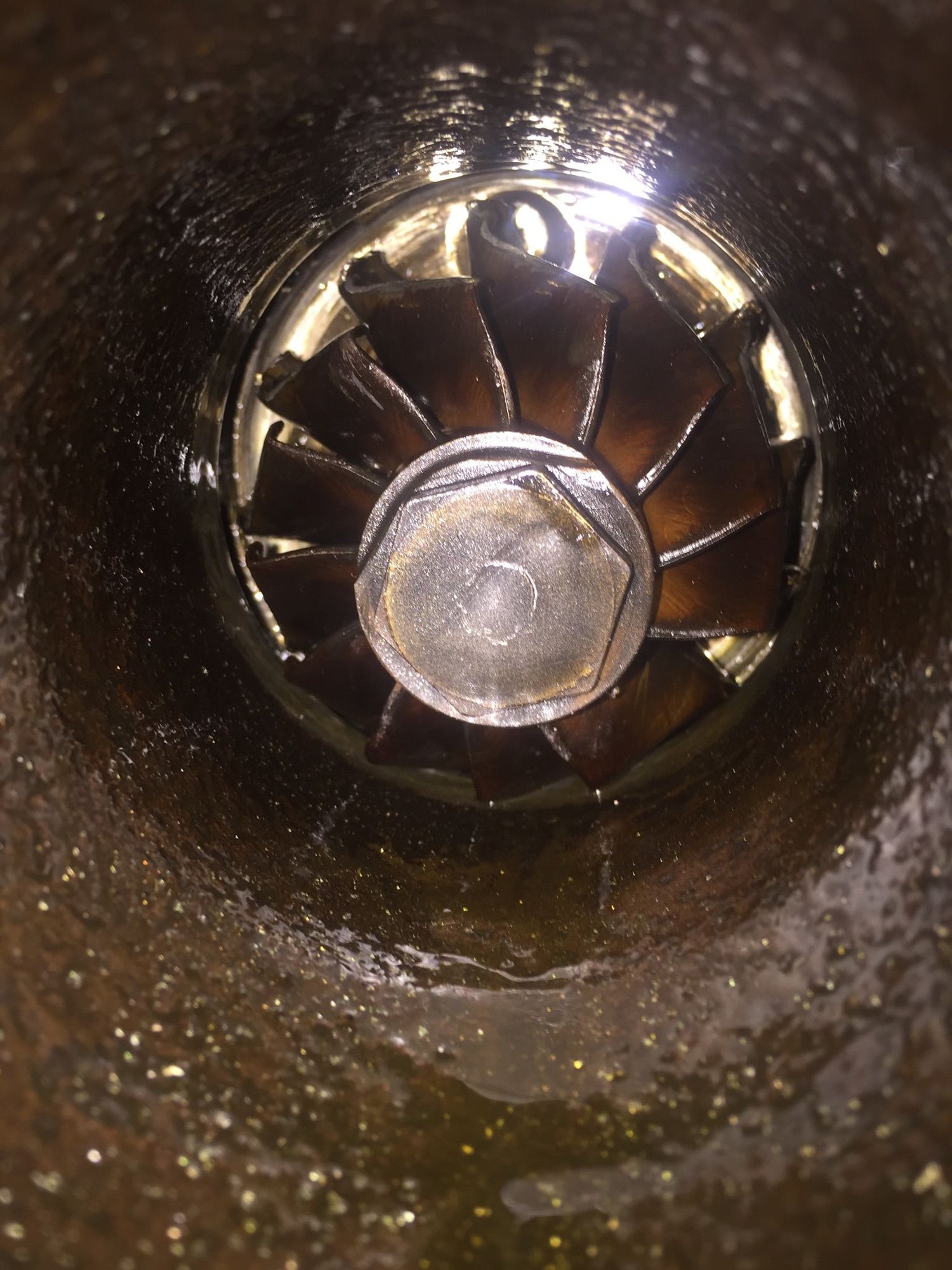

Turbo rod snapped in half. Some went down the exhaust. If it's anything else I'll report back.

Originally Posted by Tideman
Thanks for posting update. Post pictures if you can. Merry Christmas
Only one I've gotten so far.

Now follow the path backwards on both circuits, exhaust and intake. Look for metal particles inside the intake manifold before you start collecting replacement parts. - as is you might need a motor and CAC from a donor truck.

CAC should catch most of anything on the intake side. Depending on what you find in there, you may want to replace it.
