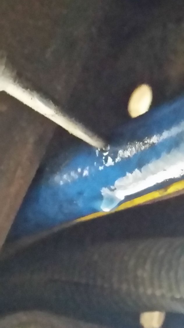

While wiring up the e fuel pump I noticed a metal object on my blue fuel line running along the frame. I took a closer look and saw a small drip of fuel and it appears the object has pierced thru it. It looks like a very small flat head screw driver. I don't have the time or funds to replace the fuel line right now. How can I fix it? I was thinking a zip tie over it but I'm not sure if that will work. I'll post a pic in a few mins

Easy enough but Im not sure what size it is. I'll cut out the bad section and take it with me. Here pics as well

Got it fixed. Couple hose clamps and the repair kit posted above. I had to cut some old hose out so I didn't have enough to push all the way on the barb shoulder. But I got it on pretty well and clamped it down hard. And boom she fired right up no problem! Here's a picture of the culprit. I believe the previous owner intentionally stabbed it. It was a weird angle for something to fly up from the wheels. Im not sure but it's fixed :-) hopefully it was my air intrusion issue

Odd, almost looks like a chip rake for a lathe or mill...

Wow what a strange thing to find! Who on earth would intentionally do that??...
That definitely would let air in, if it's the supply line. Air can get in places liquid can't leak out, so any drip means air can get in for sure.

that looks like a dental pick.
You have a brutal dentist Tom!

dental tools are stainless lol
not aluminum. I have several of these picks,
there great for replacing O-rings on injectors, keep it and use it!
one of those tools you don't really need, but when you find a use for them, they are invaluable

yes, true dental picks are stainless. but the aluminum ones used by wrenches turners are also called dental picks.
