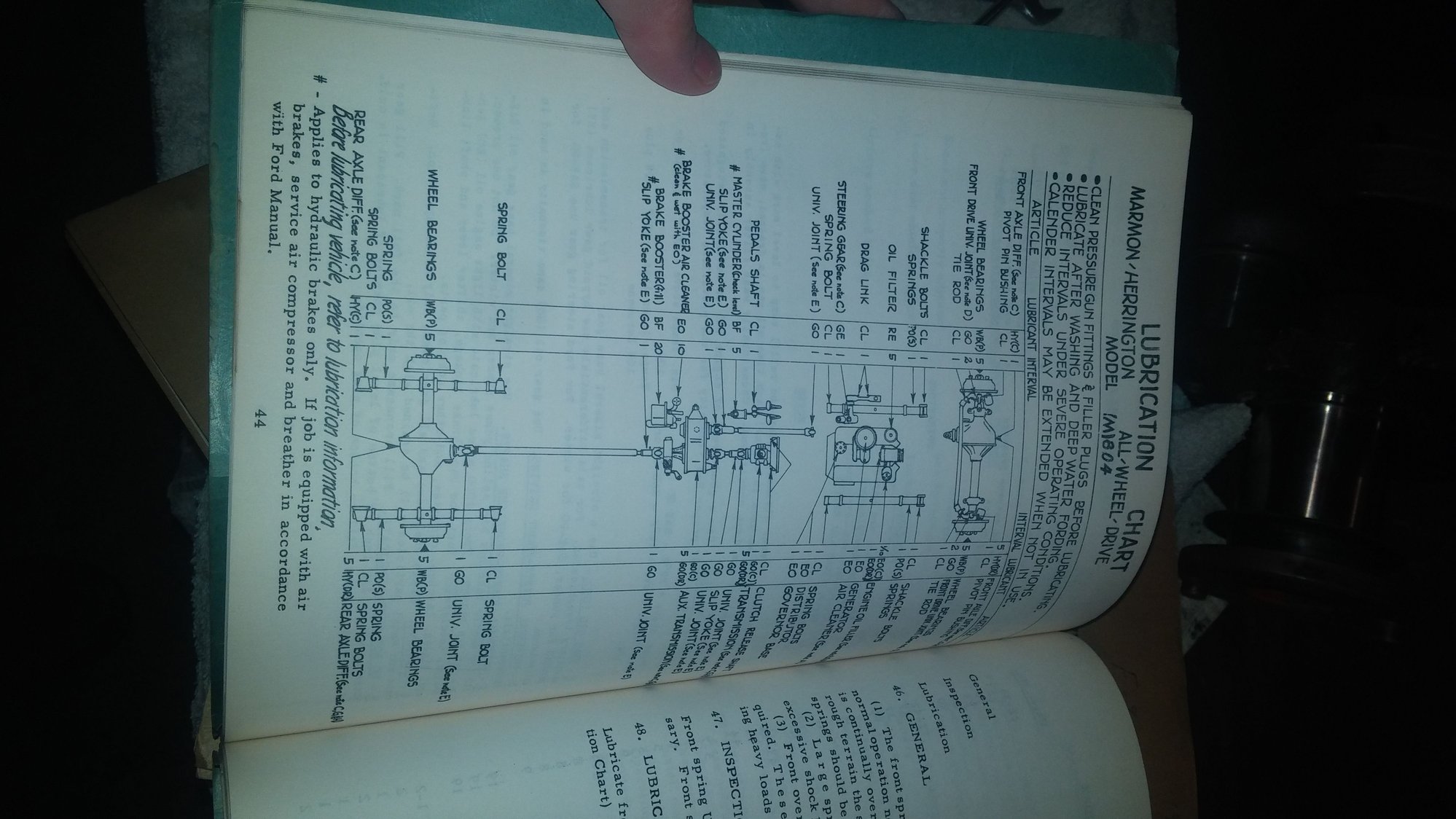

Hey, Look at that. Ive got your manual. And the other M series. M 704, M 904, M 906. Manuals incase you find your trucks big or little brothers down the road in the future? you cant have just one. Haha
This is not a first print of the manual. Its the October 1957 edition printing for your truck.
Lube chart from book
