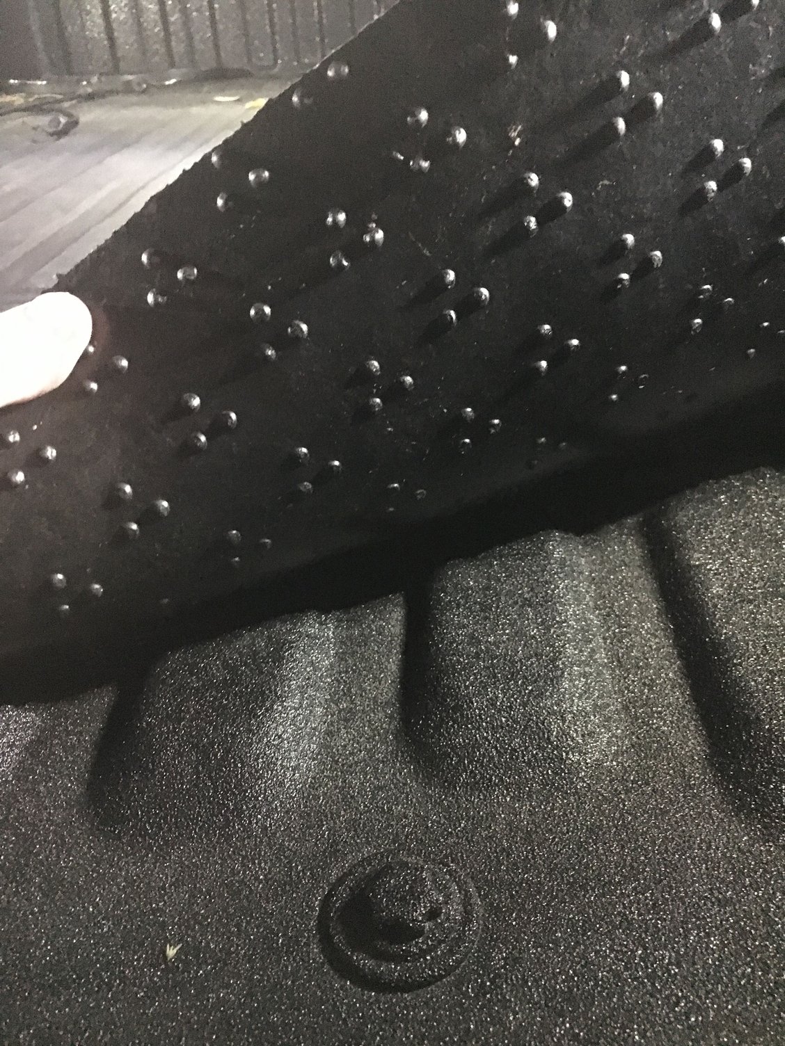

If the mat is thicker than the head of the bolts, chalk the head of the bolt, lay the mat in the bed and then lift it back out. The bolt heads will have deposited chalk to mark their locations. Take a drill and bore out the bottom side of the mat just a bit to give the heads clearance.

yes and make bed very flat
Looks great Clean you can see super duty nice and has a texture on bottom to fill in groves of bed and makes flat like i have said dog likes it to better than line x its about 7/16 thick almost half in areas things slide on nice as well wit no marks

LOL...it wouldn't matter if the mat was thinner or thicker than the bolts...because the mat sits on top of the bolt. Ya see what we're saying???? Doesn't matter how thick the mat is...it still rises at that point that it touches the bolt in all four spots. BUT....you have a great suggestion to take a little rubber out of the mat on the bottom to get it to at least sit a little more flat.

Ford already made a spot for bed bolts sits perfectly level

No they didn't...what mat and truck are you looking at...

Cant even tell the bolts are even there and its non scuffing kind of, stuff don't slide all over its right sweet.

LOL....what the heck are you talking about dude....where did Ford "make a spot on the bed mat"??? Are you not looking at the pic? The mat is level on the bottom...AND sticks slightly up on top of the bolt. That was the WHOLE purpose of the comment. Yeah...it's not that bad...barely noticeable.....but it sat FLATTER with the old female bolts. Nothing more...nothing less...but there is no "Spot" on the mat to compensate for this....LOL

I guess they took a dremel or something and removed a little bit ...yes bolts are gay they should be flush mounted but mine are also not sprayed over
