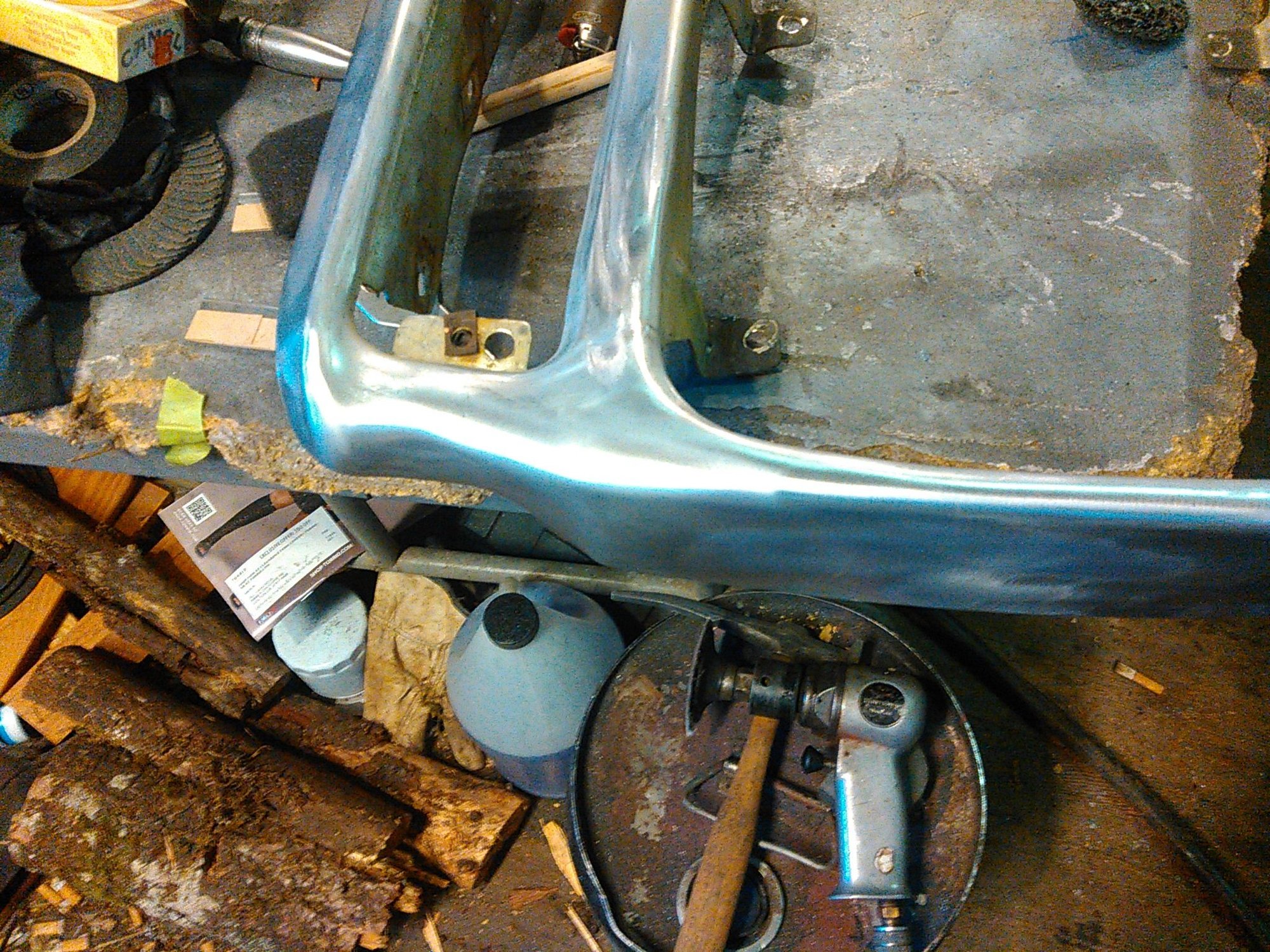

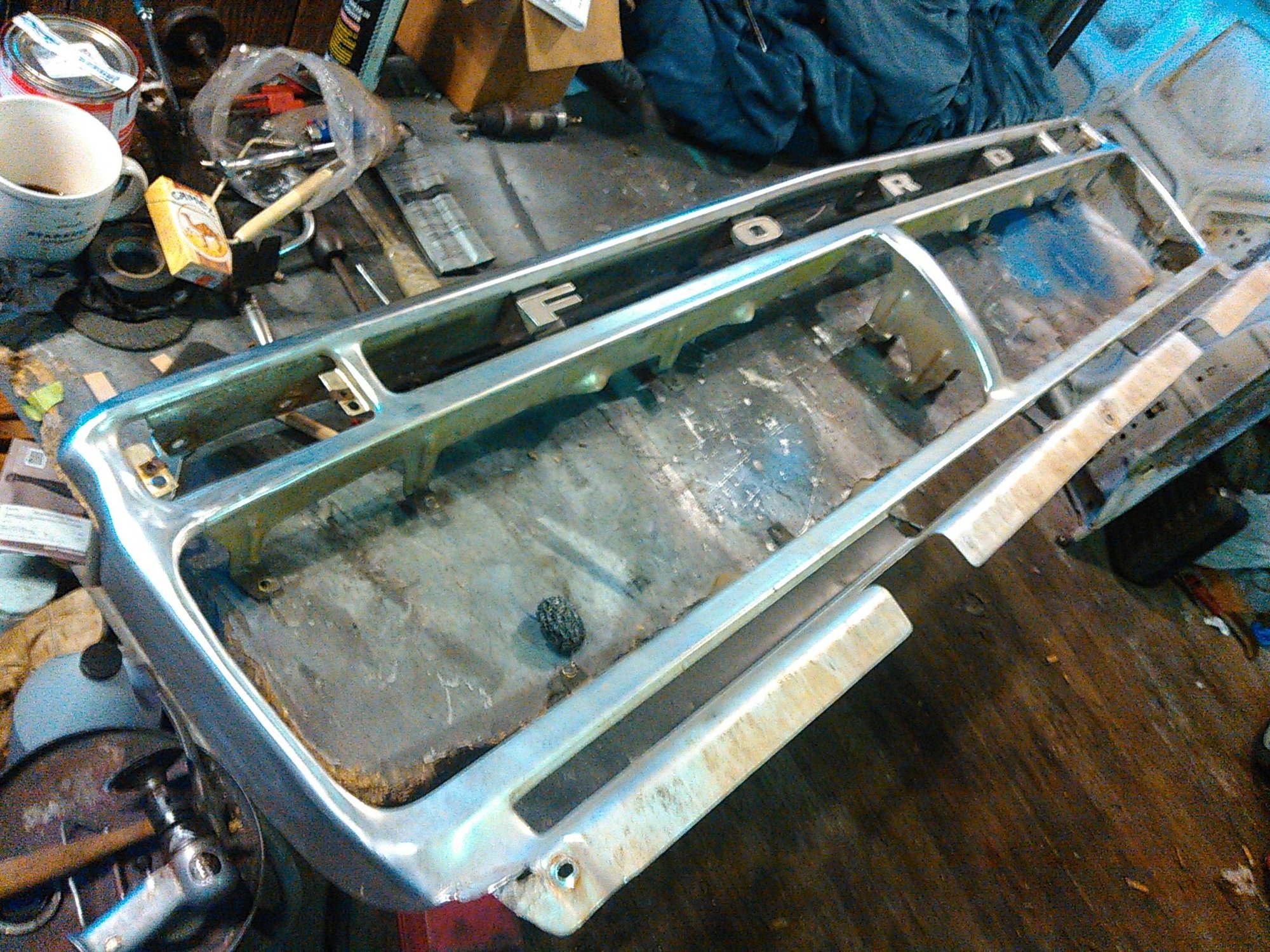

Well after drooling over the grill shell 500 has. And wanting it. And my wife not letting me offer to buy it. I went and grabbed a grill shell I had deemed unusable. The driver corner was dented in about a half inch wish I would have taken before pics. And had several gauges. With it being cold and snow outside and bored out of my mind I started working it with my body hammers and dollies. And got to this point. I have some tight welding to do on some cracks. And a lot of polishing. This is what I have some far . Not to bad for killing time After reshaping and some polishing. Think i did a ok job. No dings or gouging
A close up of the corner after i took the dent out
The grill so far lots more to go

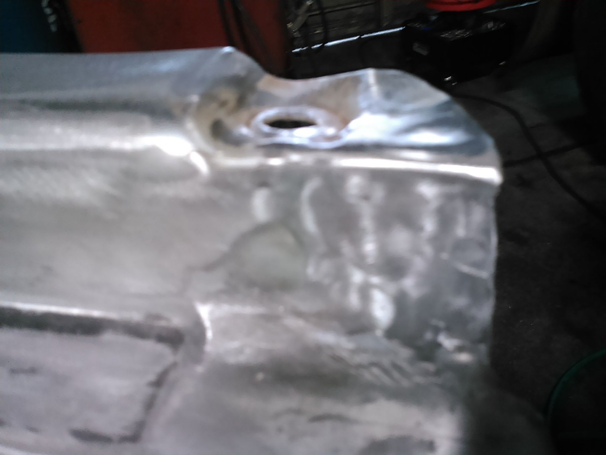

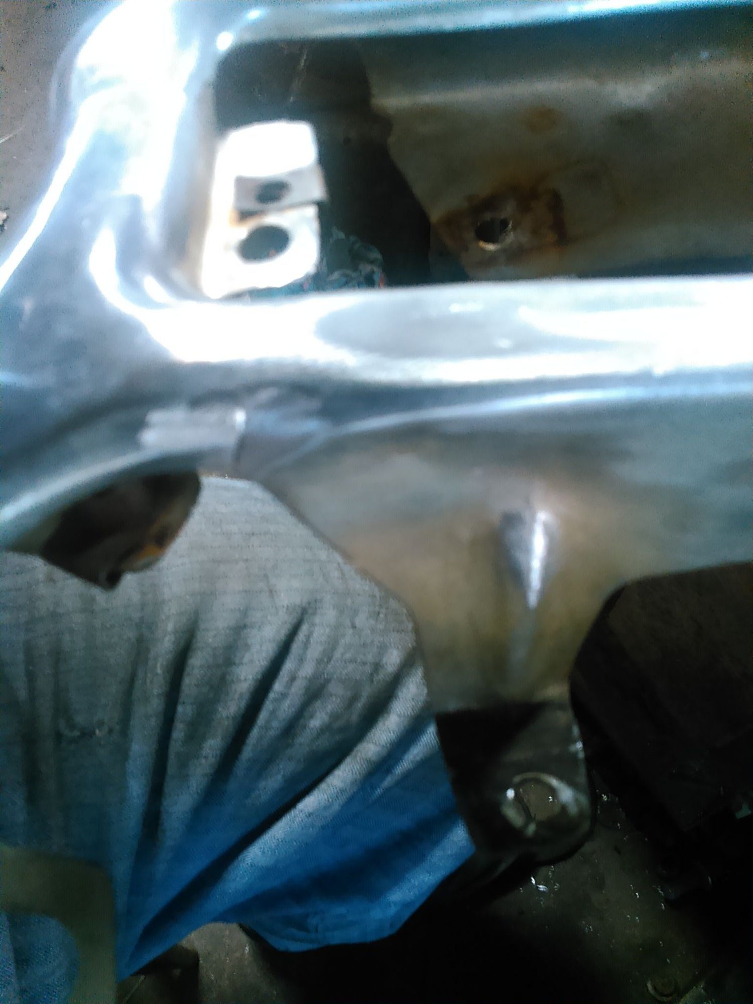

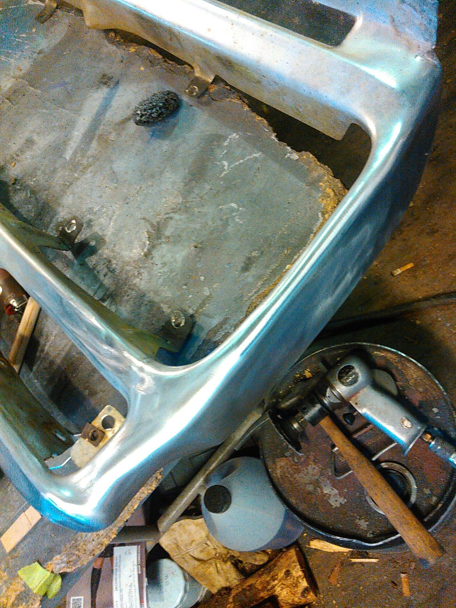

Well did some more work on the grill .welded some cracks and went over it with a polish pad we use to polish the inside of stainless steel tanks after repairs are done. Got a lot of the imperfections out now ready to polish. Here is a few pics The worst crack before welding
Bad pic but same spot after welding before final smoothing
Small crack
Area of crack after weld and final smooth
Grill shell ready for polish
