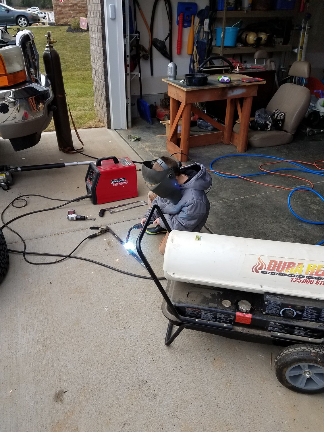

I did finally get the y pipe off after cutting one of the bolts. still cheaper than paying someone.
I found out that there is enough room to get the welder in there, it's just really tight and awkward, and frankly I am way too pissed off at it today. it's a good thing my 6 year old was there to keep me calm!
I ended up putting my tools away and teaching the little one to weld lol

Kids welding is always worthwhile. I like the bottle strapped to the tow hook !
