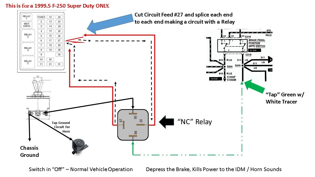

I use a Revelco for when it sits in my driveway for months at a time.
I also have a switch wired whereby I can leave it running, when the brake is depressed the engine shuts down and the Horn sounds. When I was doing roadside service, I never, if ever, turned it off the entire day, literally.
Can you share the diagram? When I am on the road I do not like to shut down either, presently I put the Club on and lock the doors if I am going into the restroom or something. Especially in hot weather.
Check wiring diagram for your model year - Brake Lamp Switch
