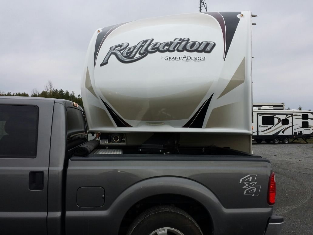

I broke my rear window doing a tight turn a couple of months ago. I just wasn't paying attention. I've since replaced the hitch with a B&W set to the rearmost setting. This gives me an extra couple of inches over my old setup. I just don't like sliding hitches. In 5 years I only had one mishap. With the extra 2" I should be good now.
My kayaks are 10' long. I place them as far forward as I can. I also place them in the middle of the roof racks. They usually hang over the back of the cab less than 12". No problem with clearance with my old hitch so it should be much better now.
When I first got my B&W hitch I experimented in the storage lot parking lot to see my limits. As you can see above I can make an extreme turn but would contact if I don't pay attention. I would never have a requirement to get to this angle anyway. I'm very pleased with the Super Duty and the Reflection. It's a great combination. I know you'll be one happy camper!
