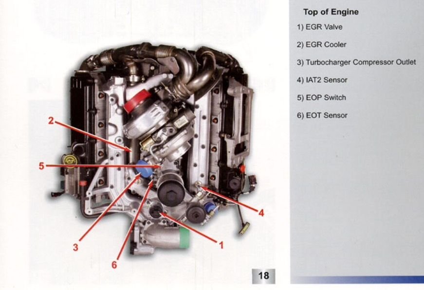

Thank you. I will check the Maf and IAT2. Where is the IAT2 located?

Rusty Axlerod's Avatar
Rusty Axlerod
Joined: Feb 2011
Posts: 8,241
Likes: 155
From: L.A. (Lower Alabama)
From the Tech folder. (It is your friend)

wrxin's Avatar
wrxin
Joined: Jan 2013
Posts: 658
From: Parker, CO
Thank you sir!
