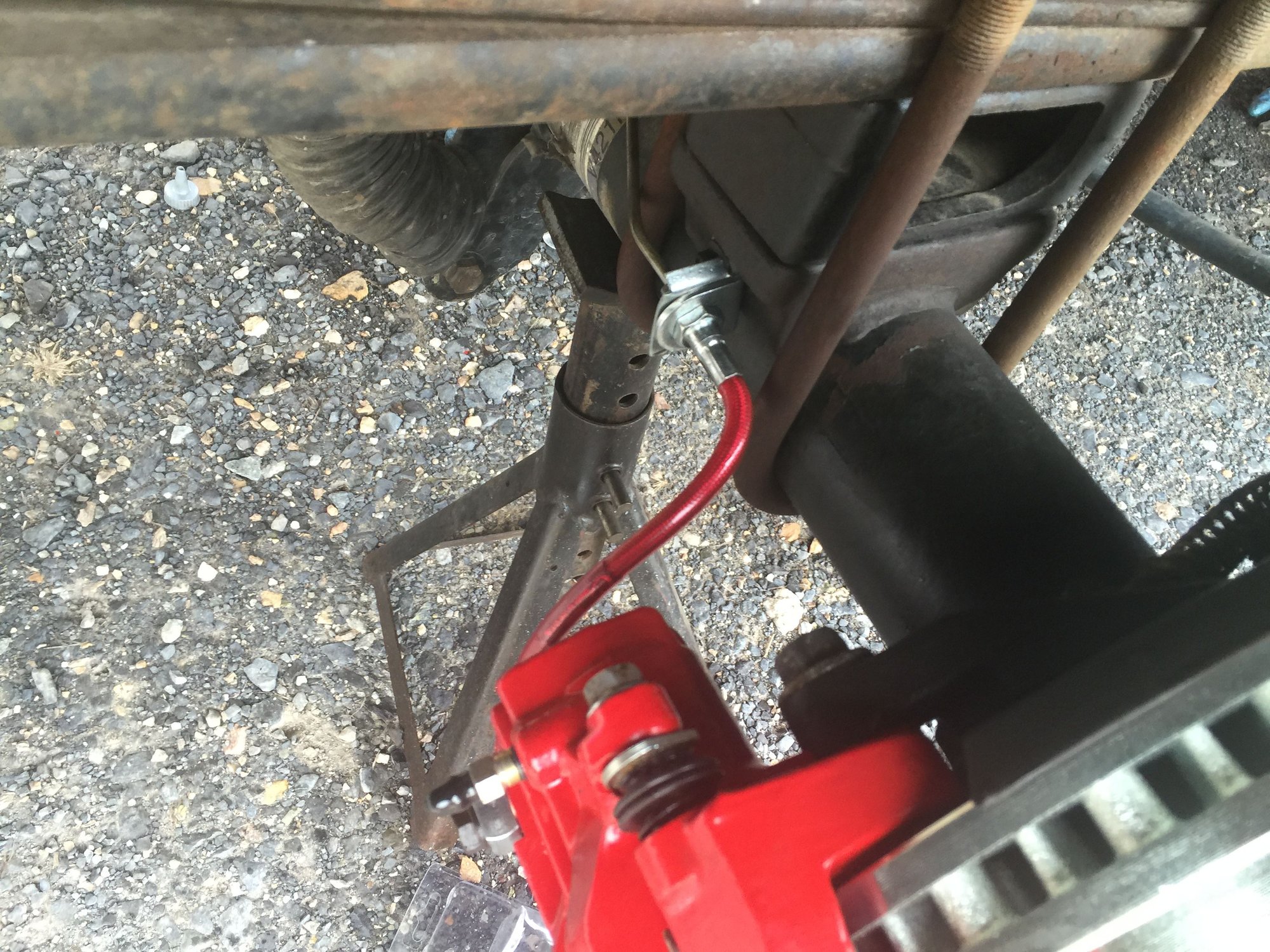

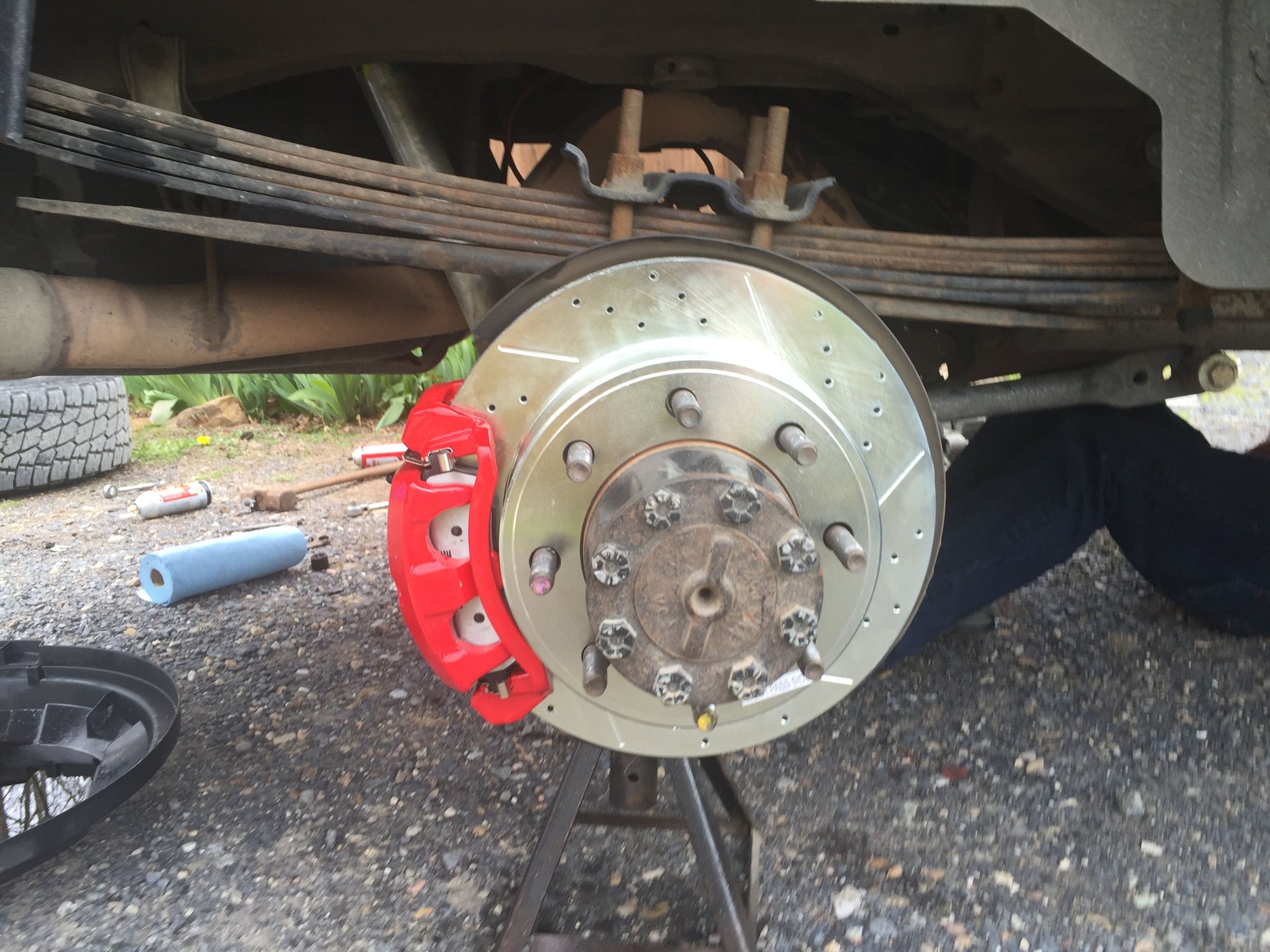

I have the braided stainless steel lines from Dieselsite.
http://www.dieselsite.com/1999-2004f...ofhosekit.aspx
For an Excursion make sure to get the set for the 1999 to 2004, even though mine is an 05 I had to get this set.
