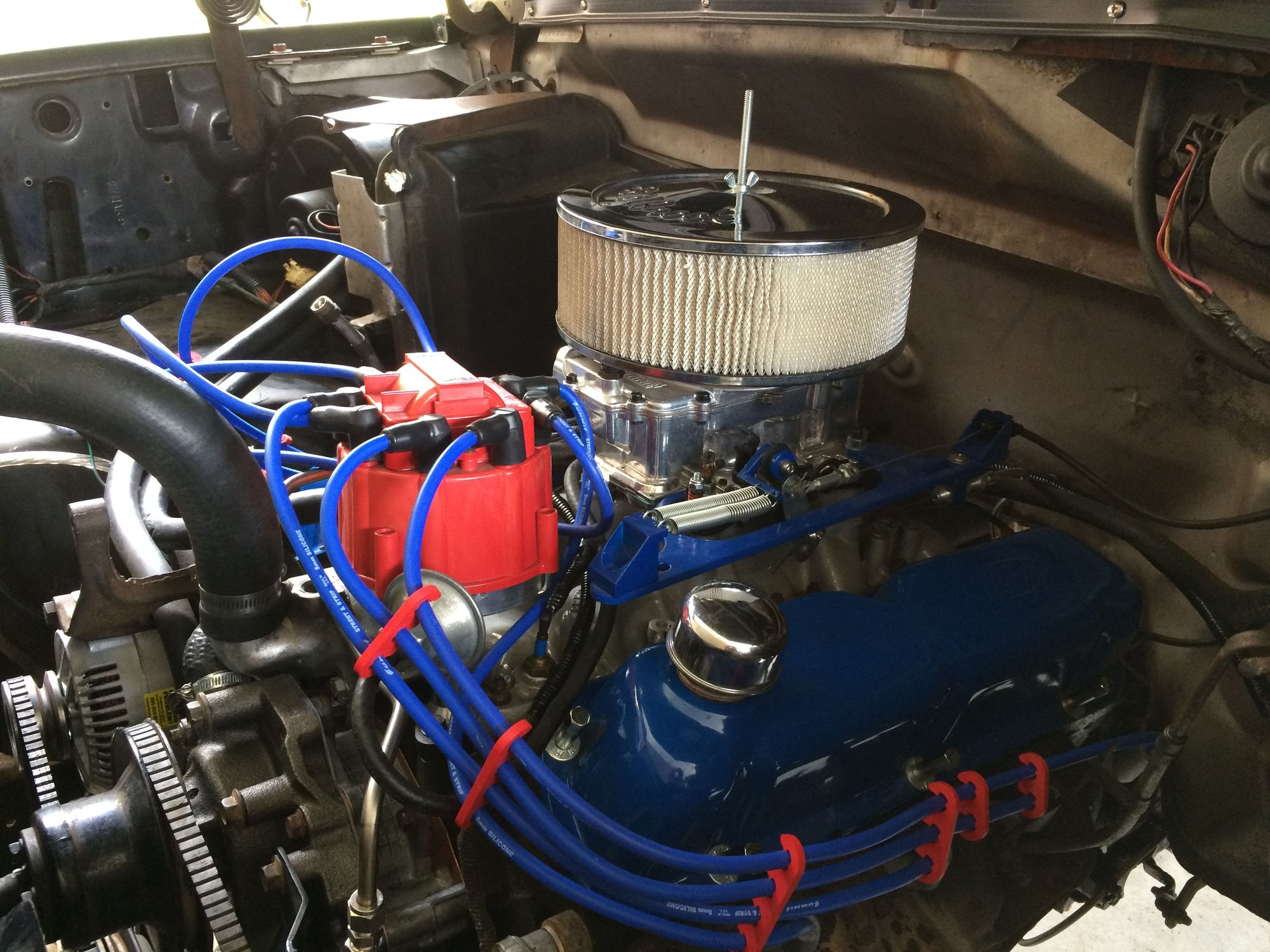

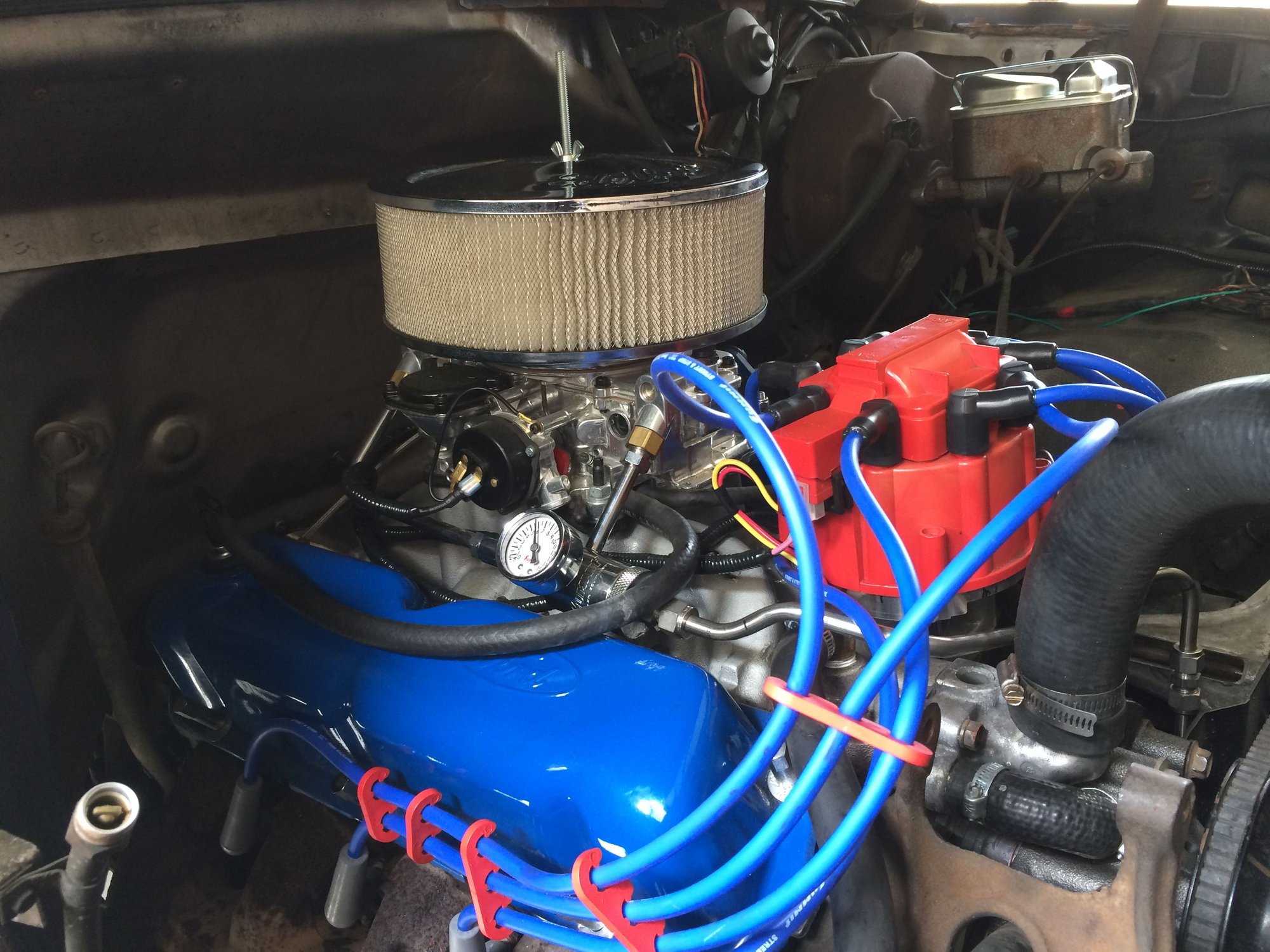

I actually did the same thing to my 82 F100 a couple years ago. I replaced the ignition system with an HEI. They actually make 2 different versions... one with a cast gear and another with a brass gear (I think). If I remember correctly, one is for roller and the other is for flat tappet. I can't remember now which is for which though (been too long). I wanted to clean up my engine and get rid of anything I really didn't need.
I ended up buying a Summit Racing 600CFM carb (sum-m08600vs) and the aftermarket fuel pipe with the psi gauge.
Those were literally 2 of the best investments I've made to this truck. The HEI only needs 2 connections (1 if you don't use a tach). The power to the HEI I used the exisiting 12v power that was originally going to the ignition module.
Like I said, I've had it this way for going on 2 years now and it's been working great and my engine bay is uber clean! (of course other than the dirt!)
Here's some pics... it's a work in progress..
And BTW: Another good mod is to go ahead and do the 3G alternator upgrade. You can see mine in one of the pics. Another great investment!
