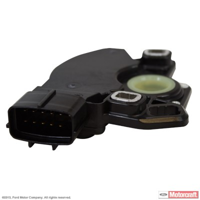

To answer your real question, on the drivers side of the transmission, you'll find the Neutral Safety Switch / Range Sensor (NSS) that controls about what the name is........ The connector can be corroded or the wires.
If your having problems with the shifting, or the trans going into the correct gear, this would be caused by a bad NSS.
Should look like this -

Yes, the gear selector "rotates" the NSS and the contacts inside the NSS feed back to the ECU and other sensors to what gear is selected, and when reverse is selected, the contacts energize the back up lights.
Most of the problems are the NSS itself, inside corrosion, burned contacts, The connector can become corroded, and in some cases, I've tapped off the correct wire for the back up lights, and ran a new wire back to tie into the back up light circuit.
Other problems to look for, sloppy shiftier on the steering column, there a "shiftier" tube that the bushing wears out, or the 4 screws holding the shiftier tube become loose, you'll notice this more with the shiftier indicator not sitting in the proper place on the dash, then the shift cable is not turning the NSS in the correct contact, the trans will shift into reverse, but the NSS will not be at the correct location, if you notice the picture, the mounting holes are somewhat large, to allow for adjustment on the mounting.
