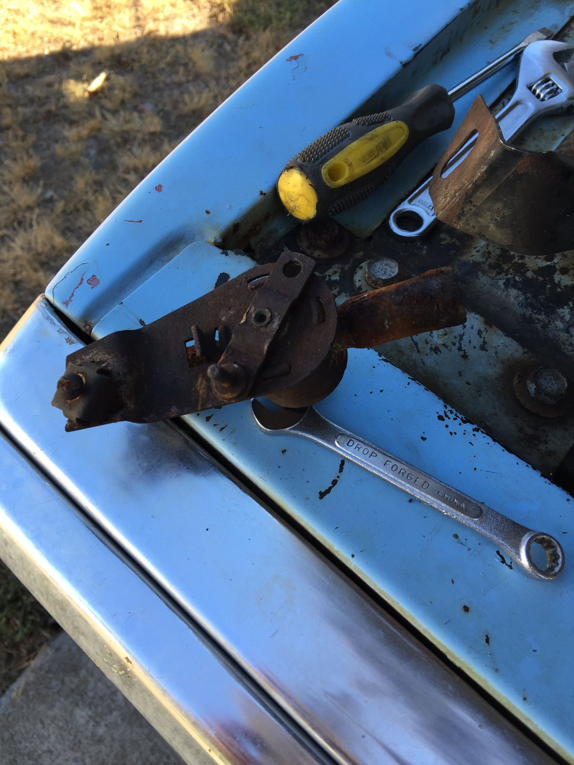

I started with the blatantly obvious things which took me to the heater valve which was stuck closed ... shown below

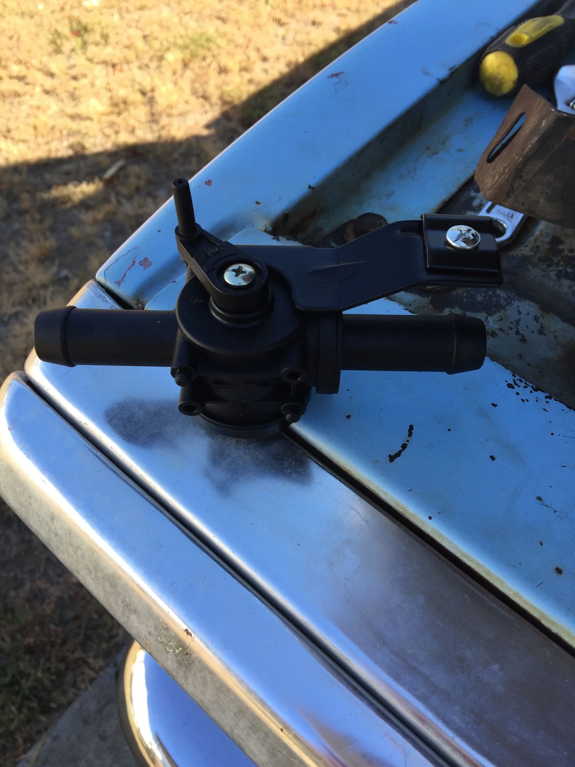

Which I replaced with....
I got her nice and toasty and turned the fan to the HI position for about 10 minutes.... and nothing happened. Not one ounce of heat. I double checked the valve to make sure it was open and it was.... so if I have flow what could be the no heat cause ??

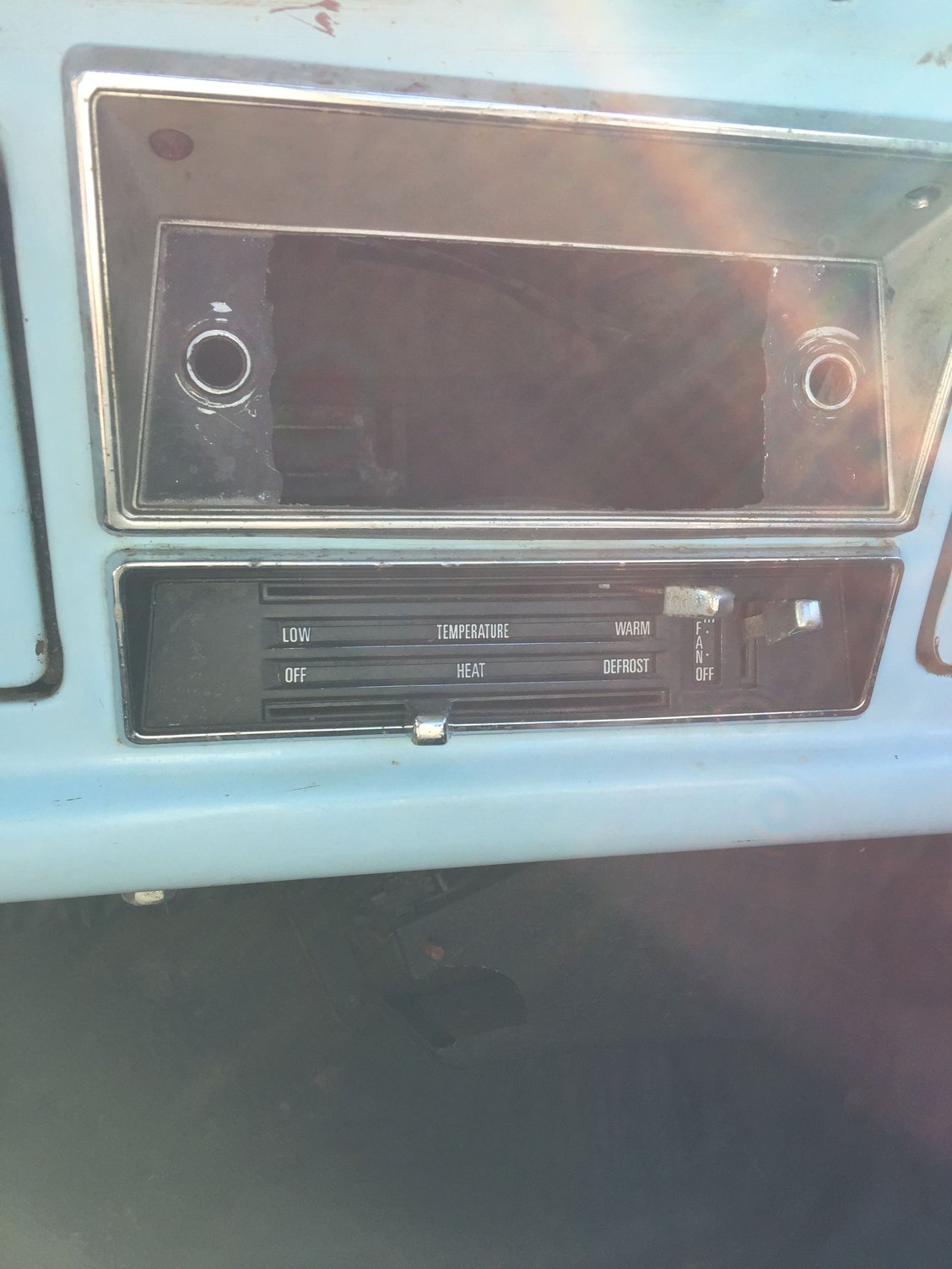

Cables needed
I have similar issues however I found the cable for the heater defrost selection has snapped
Been searching for a replacement cable and can't find it
Any one found a replacement?
Since I can manually turn the valve to on without the cable for testing I'm not really concerned about it at the moment. NPD has the cables in stock as I checked a few weeks back

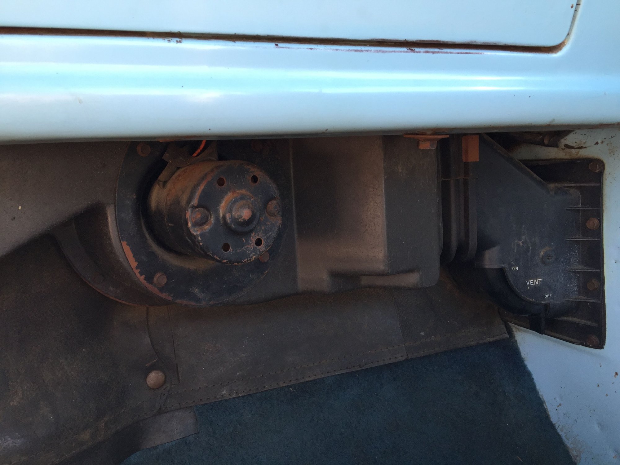

DUMB QUESTION
So the lever on the passenger kick panel side that says vent on it should be in the on or off position? I figured off for heat you'd want it in the off poison.

Where did you get that valve? It doesn't look like the stock one I got from a Ford dealer (they still carry it).

Any 1/2" cut off plumbing valve will work. I have used manual valves where you raised the hood to turn it on in the fall and off in the spring. I have taken a 2 in piece of copper pipe and bypassed the heater core to stop hot water from getting to the core. 1/2 in pipe fits the 5/8 heater tubing.
