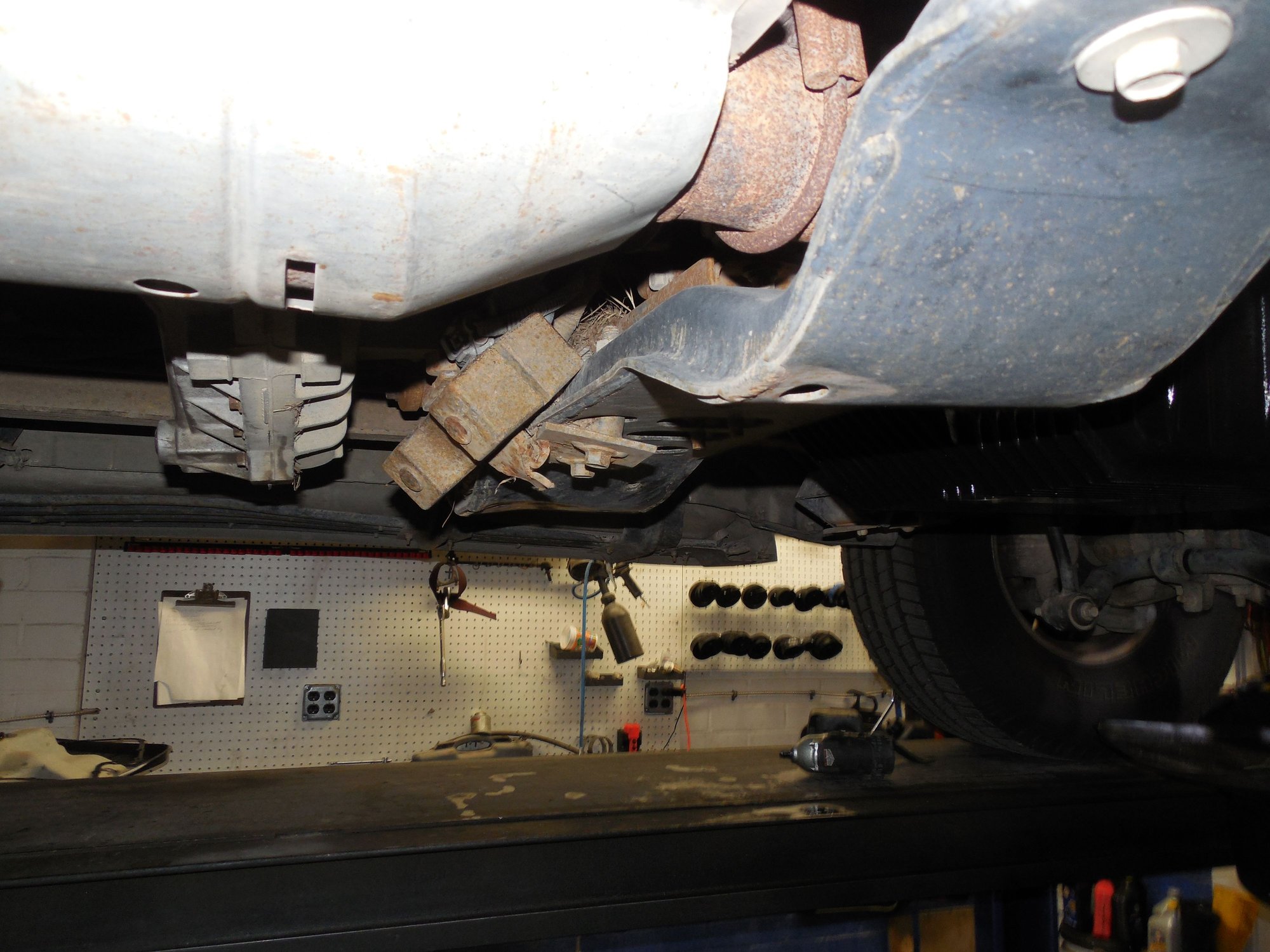

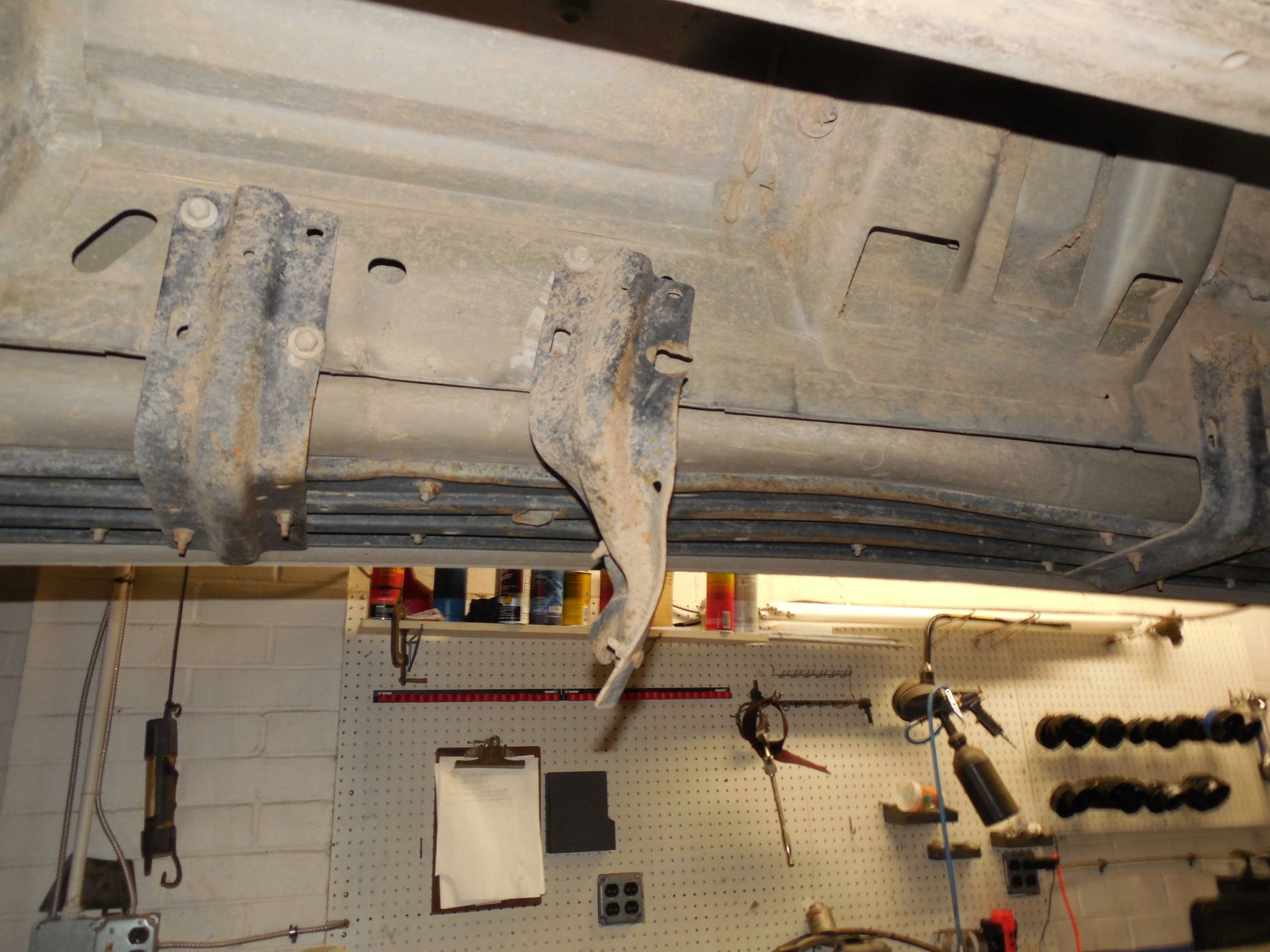

While I was there, I took three pictures of minor damage underneath the truck. The first is a drivers side running board support.
drivers side running board support bracket - not supporting anything now - it will be replaced

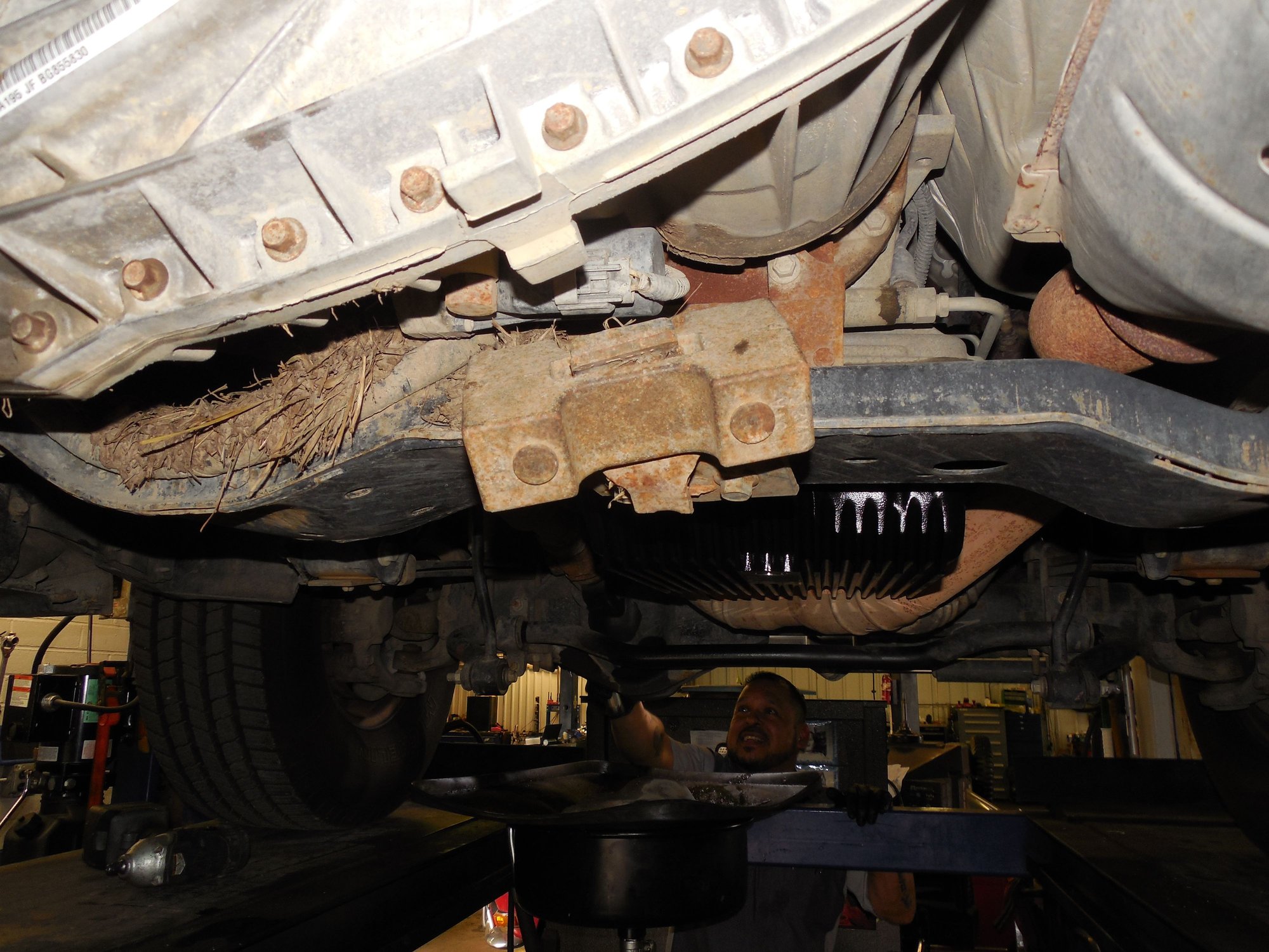

The other two pictures are of a weight attached to help with 'vibration'
weight attached to cross member - if you look you can KINDA SEE the transmission pan that has been replaced
Same weight from the passengers side it's NOT supposed to be at that angle - note the bolts holding it in place are almost pulled out.
Both of these items will be fixed or replaced. If not now then after we get back from our Colorado trip.

That crossmember has quite the dent on the side where all the dirt is packed in. Might just be better off replacing the entire assembly from a salvage yard. Looks to have been in an involuntary off road excursion, or high centered playing off road.
Oh and dont forget to change the transfercase fluid. Its a an easy drain and fill. Make sure to use the XL-12 fluid and NOT ATF in there.

Thanks for the suggestion. Transfer case fluid change is 'on the list' but as they were replacing all the covers they started with those.
And DANG IT. I didn't even know that subframe member was dented. But this is our first EX. Can any one else confirm this. I can probably find one at the yard not five minutes from my house. Will a 2004 F250/F350 4x4 have that subframe member?
If it's not one thing it's another. And it HAS to be right before we drive it well over 2000 miles in 10 days.
05MilMachine, thanks for catching that. I'm funny about my vehicles be in 'good working order'
