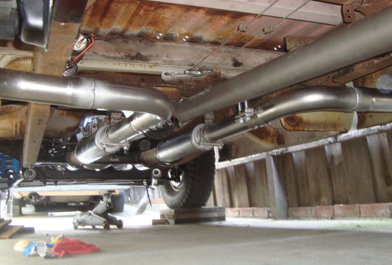

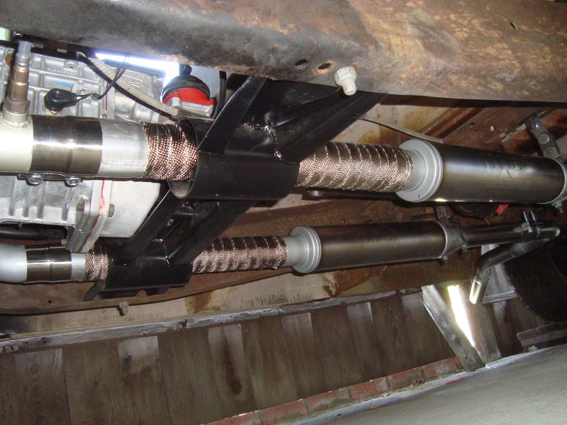

Originally Posted by Harley Hill
Nice I like your setup. Verry clean. how does it run. before and after?
Originally Posted by imradlol
nice!! hows the drone? ive got my exhaust running on both sides like right under the doors and exiting just after the cab. drones like a prop plane
It runs great
But performance improved by leaps and bounds because the truck went from a two-barrel 360FE/NP435. stock manifolds and merged tubes to a single 2.25 tube with a long, heavy, rusty muffler to a 4V, dual plane intake, TKO five-speed, Sanderson headers, and the 2.5-inch exhaust system above.
It drones a bit... the cab could use more sound deadener but there is an in-cab tank currently in my way.
