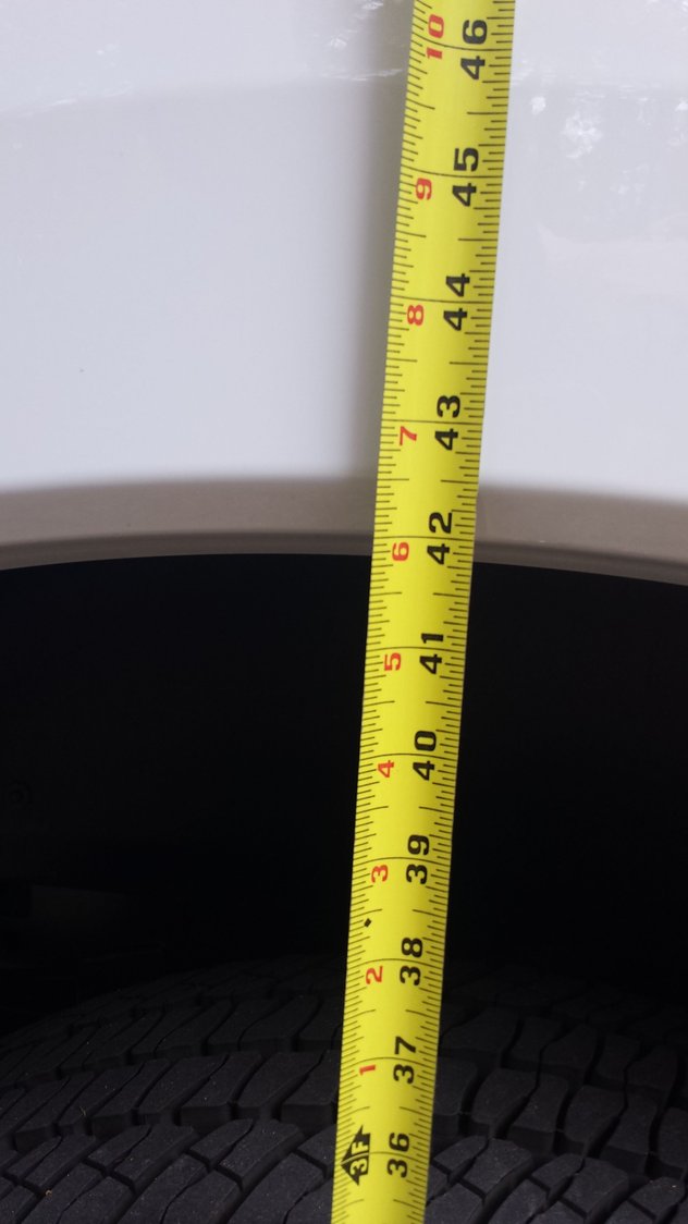

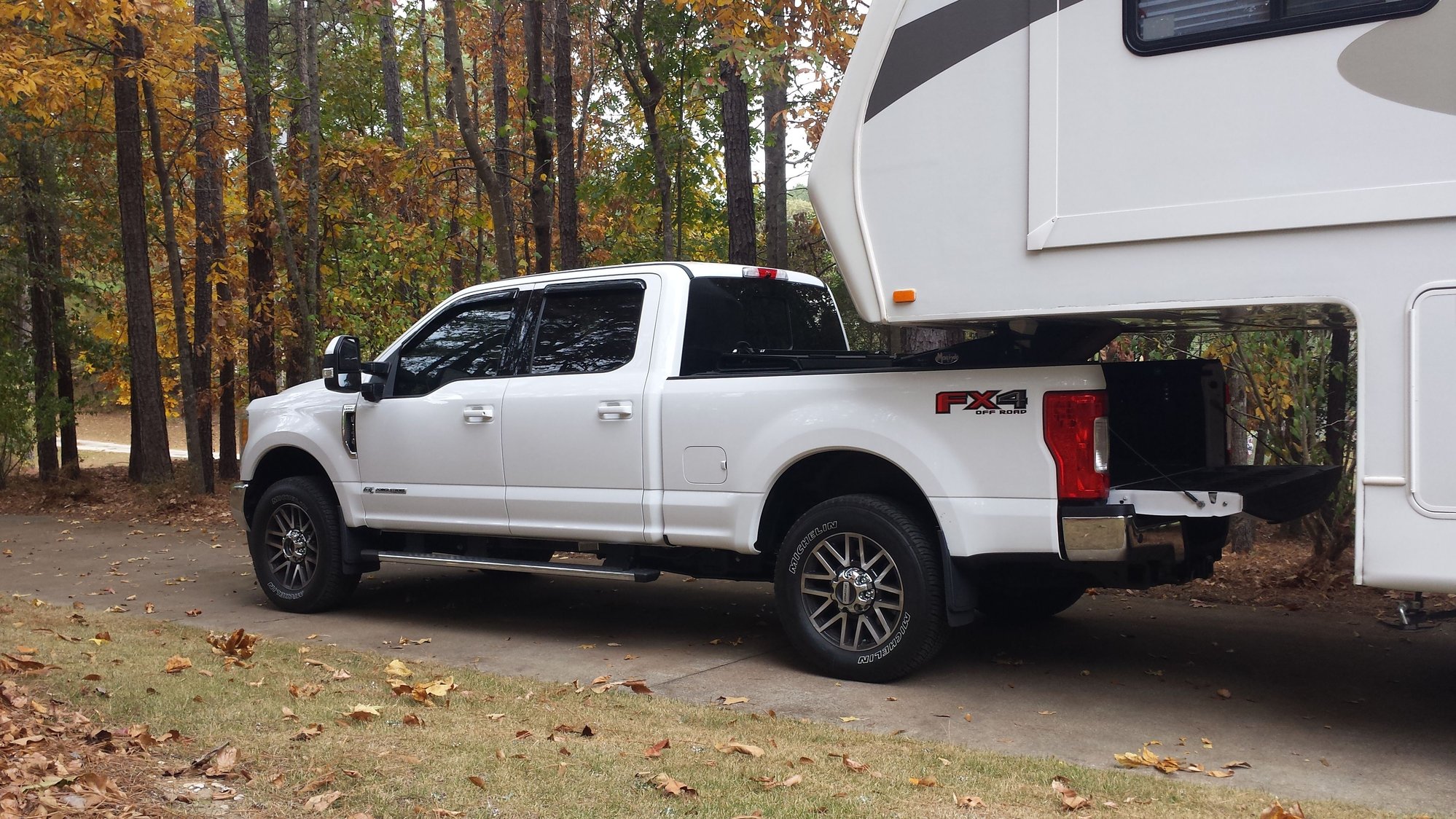

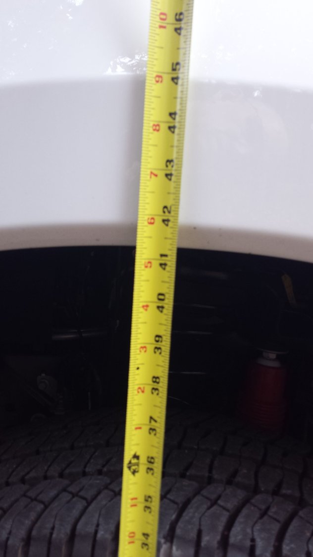

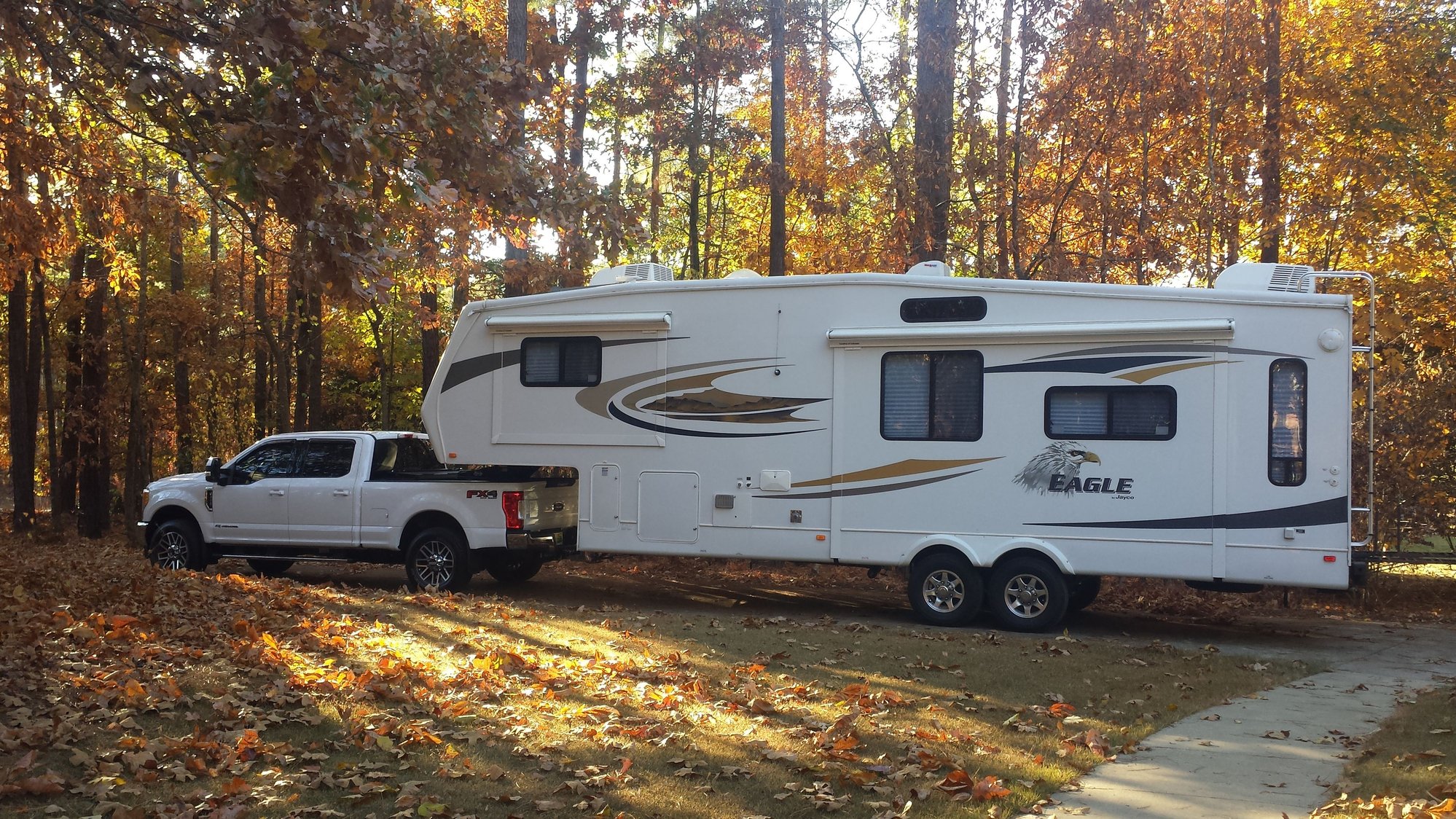

Finally got around to hooking it up. Will probably take it out in a couple of weeks.
All in all I think it looks pretty good. I just do have 6" of bed clearance. Drive way has a down hill slope. Trailer looks pretty level.
I had a lot more bed clearance on the 08 but hopefully this will work.
Front
Rear

Nice!! You leave your tailgate down?..or is it just that ay for the pic?

Just for photos.
Witch makes me think. Is there a tailgate down warning on this truck I will have to look.

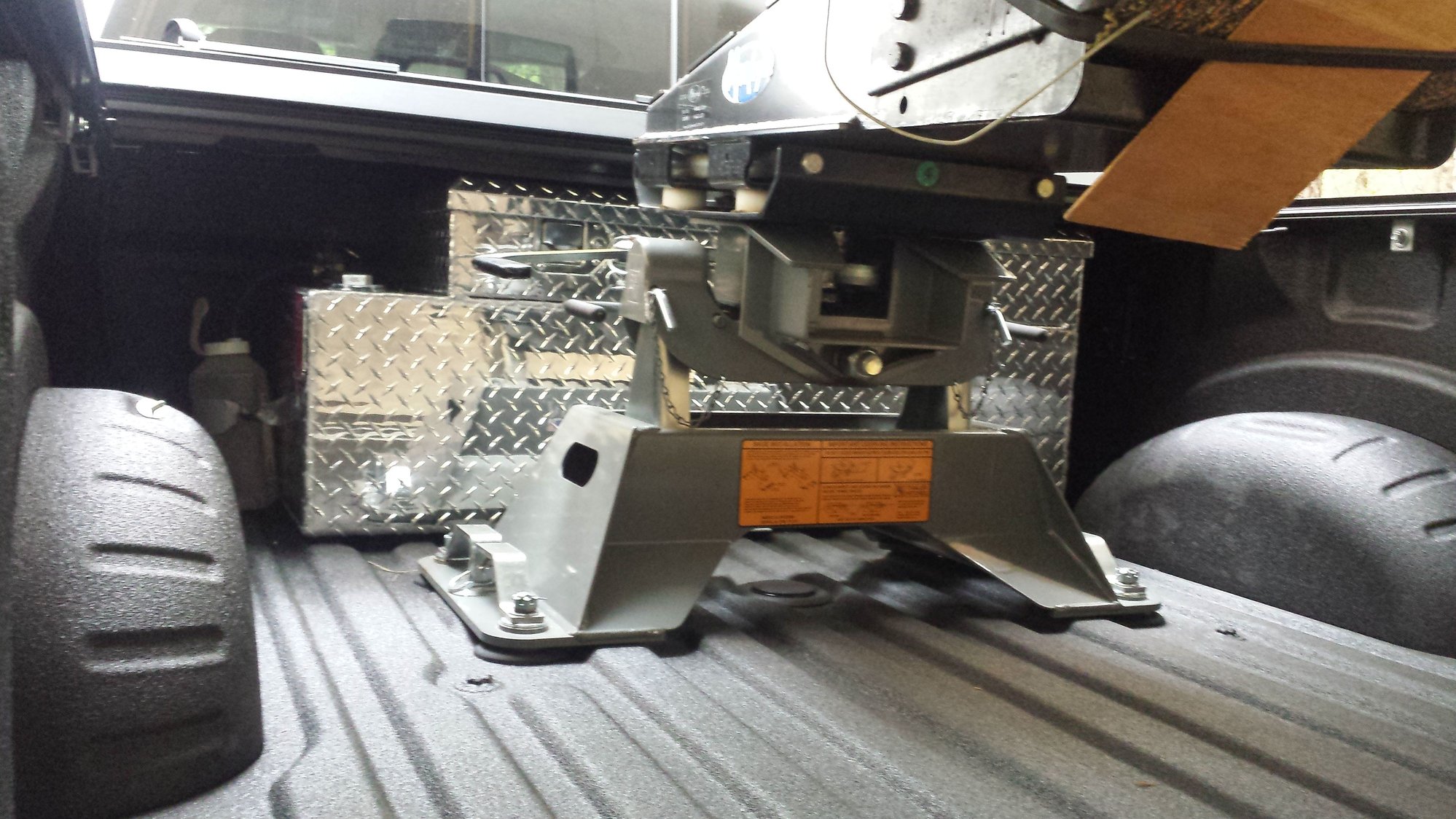

Do you know what the tongue weight of your trailer as loaded in the picture? What is the measurement from ground to the top of the bed rail when it has the tongue weight on the truck? Do you have your aux tank full in this picture? What setting do you have your B&W Companion hitch set at?

What is the B&W vertical set?

If you have another adjustment on the B&W that would make the trailer perfectly level and give a hair more bed rail clearance.

That's what I was thinking also. The first picture seems to show that the fifth wheel is slightly nose down. Raising the hitch height could help the bed clearance and level the trailer.

I agree. The trailer is slightly nose-down to my eye. You could set the hitch up one notch and it would be perfect.

Could be an optical illusion that the trailer is nose down. It looks like its going down a hill. If it was nose down, would'nt the bed rail clearance be uneven? Less in the front and more at the rear of the bed? It looks pretty even.

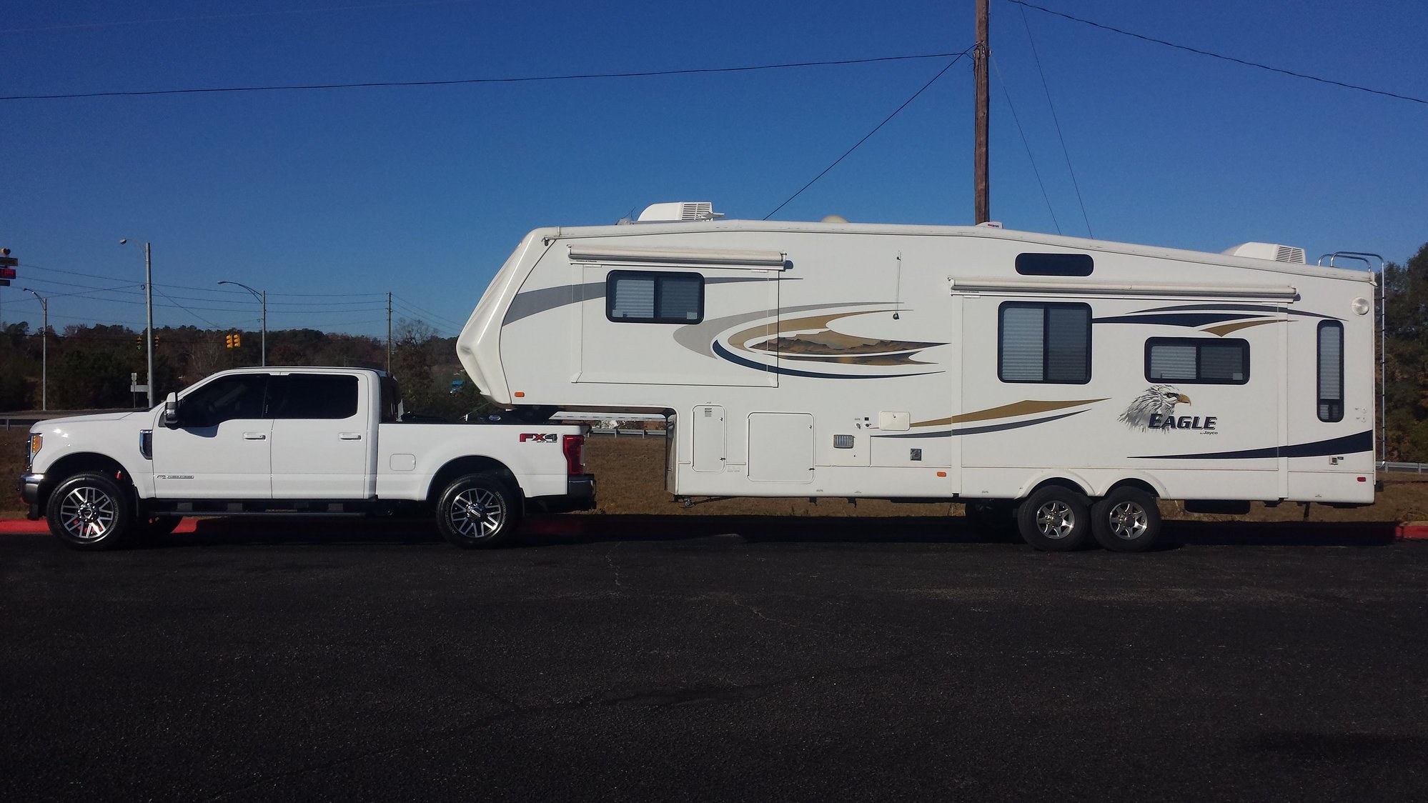

Moved hitch up one it is 18.5" off bed.

Cat Scale<br/>Steer Axle. 4940<br/>Driver Axle 7080<br/>Trailer Axle 9620<br/>Gross Wt. 21640

That looks better. What is the bed rail clearance now?

8" on the front 7.5" at the tailgate.
