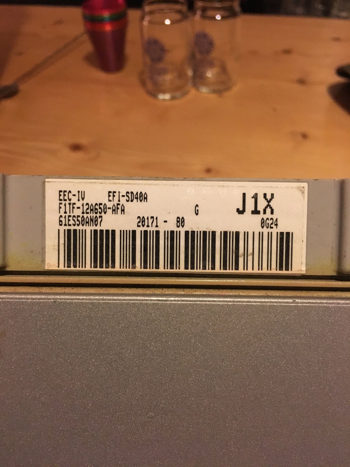

What in the truck can cause the computer to fail? Anything else that I should be tracking down in addition to the computer? Here is the label off mine...going to suck if there is an alternative...I'm already out $140 from having this one rebuilt...

F1TFA-AFA is a PCM with California emissions. That's why it's a bit tougher to find. Rockauto has Cardone brand (personally not a favorite) for ~$87. There is a whole list of compatible PCMs for this engine/transmission combination with the one caveat they are all Federal emission versions.
If you do not live in California I would snap up one of the more common versions.
