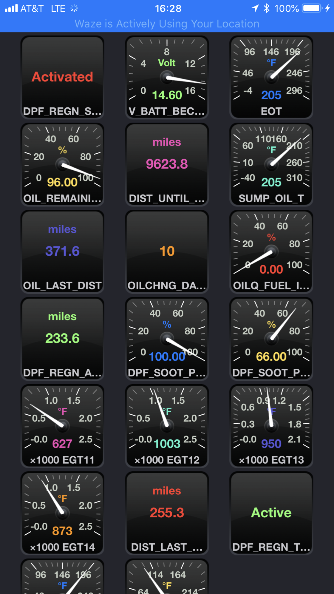

Juza - you are not alone, I'm listening and watching the conversation.
there are so many monitoring points its crazy....
I have seen the 2nd (yellow) dpf reading go down significantly even after the regen is completed (here in one picture it reads 66% when ReGen activates).
I also noticed today EGT #14 stayed over 1000* (f) even after the ReGen was no longer active....I could hear it burning fuel even though regen was no longer active.
During activated ReGen EGT12 is very high 1000, 1100 even 1400 (f).

Roadpilot must have a heavy right foot (like I do)....Around town, (you can see, in my screenshots) I'm averaging 233 miles between regen.
I have seen ReGen occur in as little as 90 miles (drive it like a rental).
