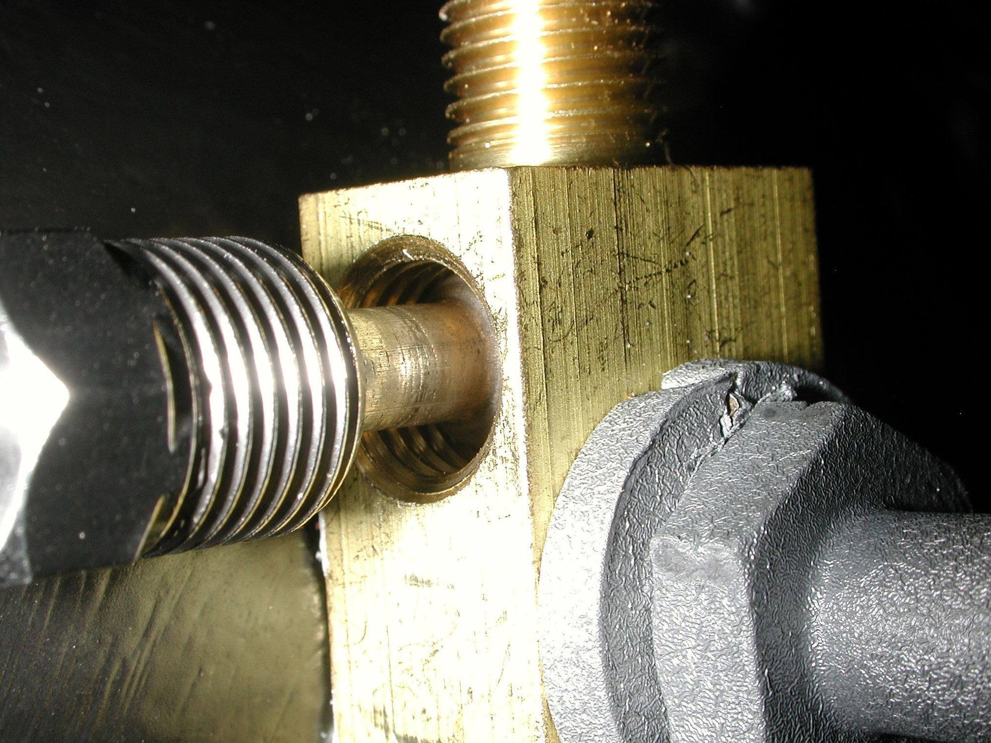

I ordered their pre-bent brake line kit in stainless steel as well as their brake hose kit in braided stainless. The parts arrived in short order and looked good. However, when I tried to install the left rear tube it wouldn't fit as the bends weren't right. It took me probably 30 minutes to massage all of the bends to get it to fit correctly from the wheel cylinder to the tee or banjo where it connects. But, when I tried to connect it to that banjo it wouldn't fit. It turns out that the original banjos take a 7/16" fitting on the left, but Inline Tube's banjo was set up for a 3/8" fitting. So, the 7/16" fitting on the tube wouldn't fit - as shown here:

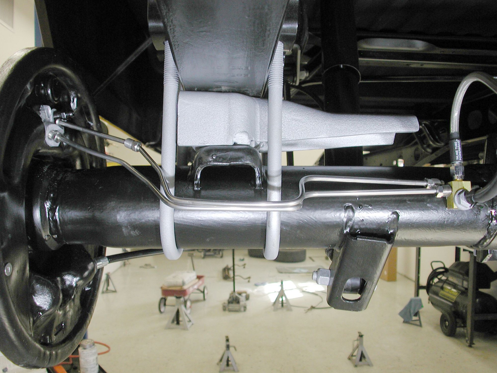

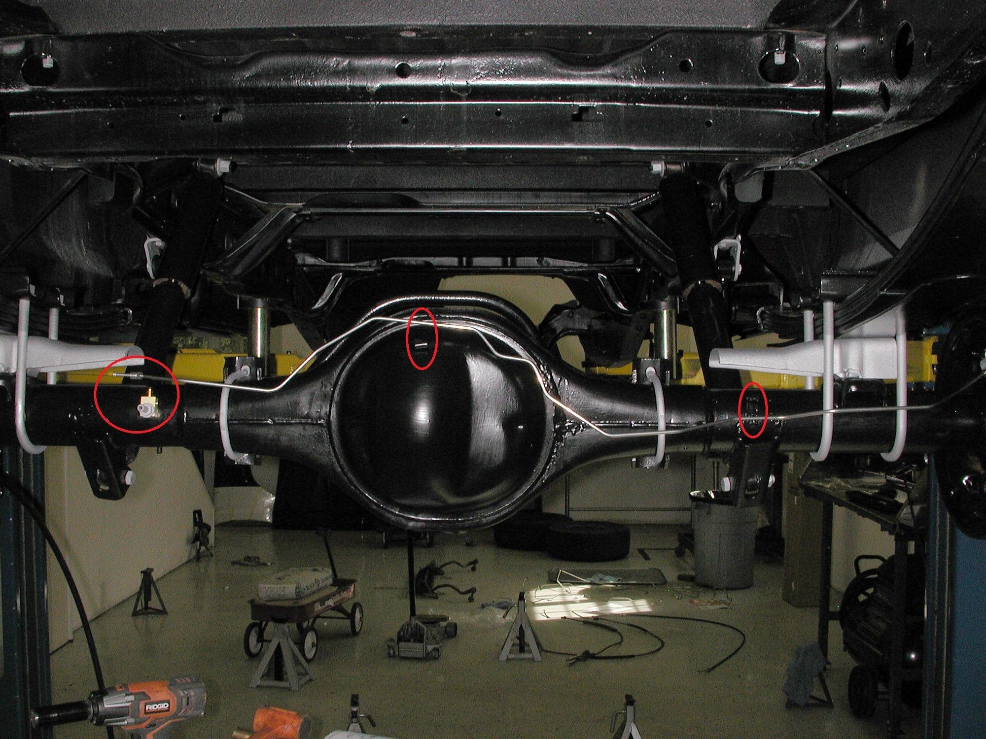

Then I tried to install the right rear brake tube, and here's what I found. Note that the line is 2" too long and doesn't come close to going into the two clips. And that took me another 90 minutes to resolve by tweaking each and every bend.
Well, today I talked with Dan at Inline Tube. They've sent me a replacement LR tube. But, when I asked why neither of the tubes I've tried to use fit anywhere close to where they should, he said that they have problems getting things to fit Fords. In fact, he said they basically are there for GM vehicles, not Fords.
