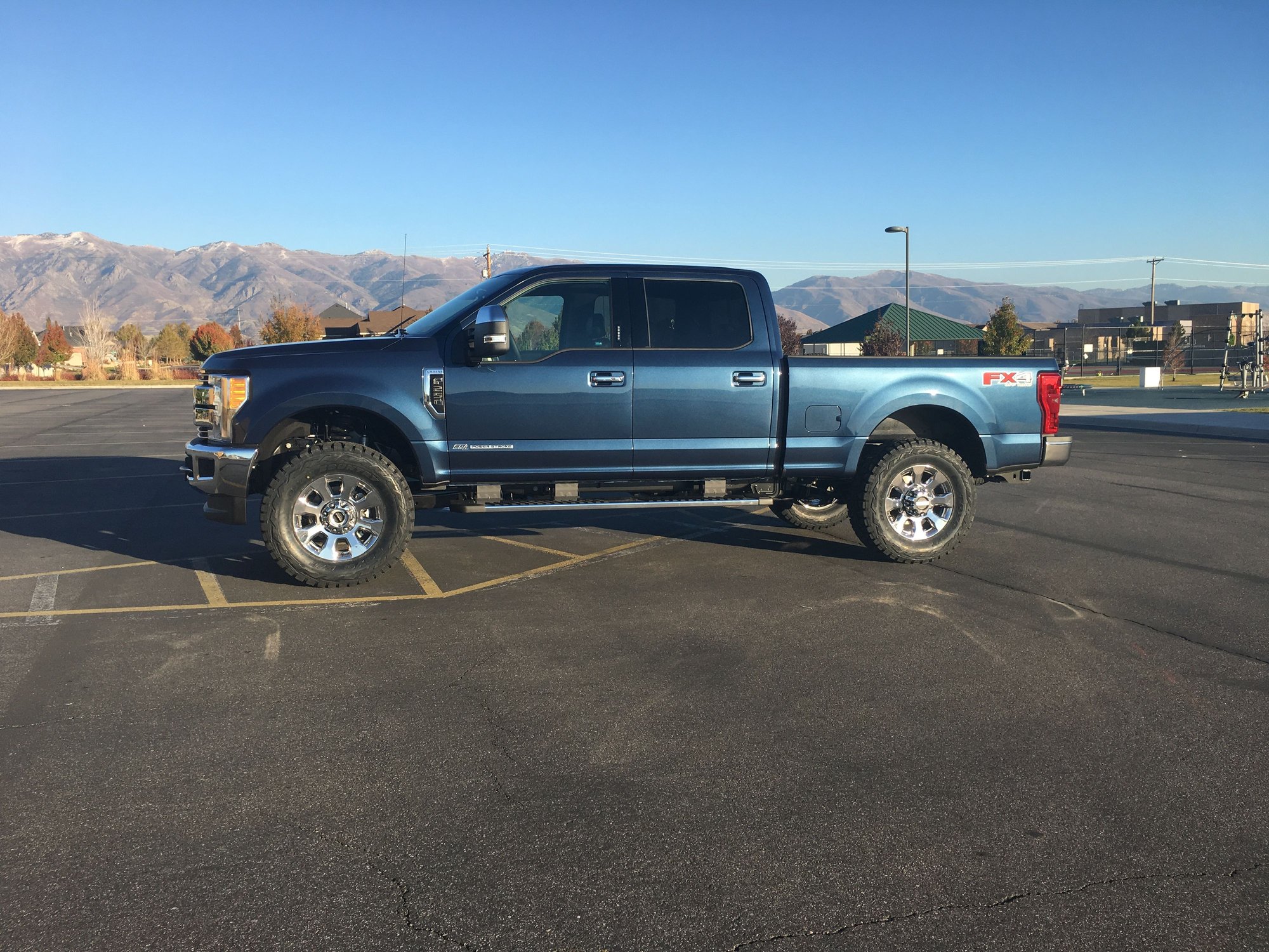

They rub slightly on the radius arms at full lock. It's a BDS 2" level kit with fox shocks on all four corners. Love the ride. There is some vibration in the steering wheel when I hit a bump so I am anxiously waiting to find a dual steering stabilizer that clears all hardware with the level kit. So far, no one will commit. I'm also looking for a true adjustable track bar, but verdict is out on that also.

Looks great. Blue Jeans kickin' it in the sun.

Thanks. My last truck was the Blue Pearl that was discontinued but this is almost as good.

Truck looks awesome!

It looks great. I'd bet that the vibration you're feeling in the steering wheel is actually a wobble caused by the loss of caster angle after the level. I agree that the track bar needs to be re-positioned but you should run your truck down to a quality, repeat quality alignment shop. They can change out your factory caster bushings with different ones that will restore the proper amount of caster. Rutcutter was the first to go through this and kind of blazed the trail for the rest of us. He recorded his experience in his Leveling Kit thread.

Awesome looking!
Can you post a picture from a little distance? Want to see the rake the 2" kit left, if any.
Also, do you have snow plow package? One last thing... can you measure ground to bottom of wheel well opening on front and back?

I'll get the measurements tomorrow

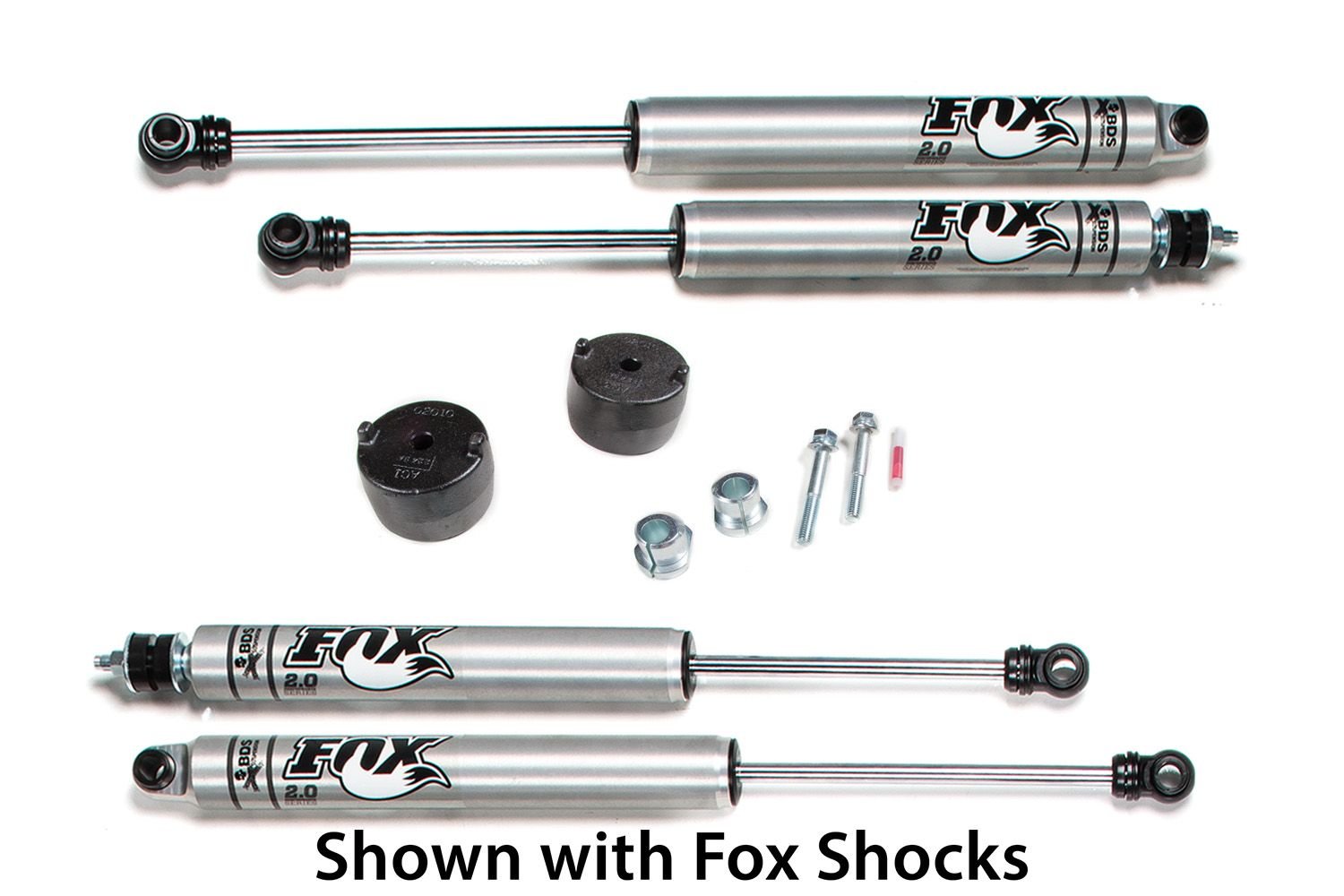

Looking at the same kit... How do you compare the Fox Shocks compared to the factory ride?

they look cooler. Ha ha. Really, I just think the Rancho are junk, and the fox should last longer. I think I noticed a slight difference, but it is more peace of mind that I will get longer use from them

It was mentioned above about the caster shims... Your BDS kit should have come with them, I know the BDS 2" level that I put in my 2010 F350 came with them. They are in the center of the picture above, which is the kit for the 2017.

Did you ever get those measurements? I wanna know how much rake is left with a 2 inch kit.
