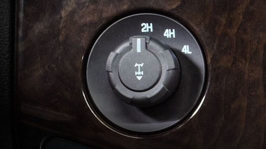

Is your truck 4wd?
Do you have the e-locking rear end?

Yes it is 4wd not sure about elock.

On my 2016, I pull the 4x4 switch straight out to activate locker.

I just turn **** to 4wd not sure if it pulls out

Alot of the newer rigs will have the 4x4 with the E-locker, the symbol in the center of this picture is denoting the E-locker, sometimes its not dead center but instead its on the left side of the ****, take a look and see if you have it. if you do that will help quite a bit as some of the F150 pickups had limited slip rear ends, so it was a locker that would kick in automatically when one side started slipping more than the other.
As everyone said, a good quality tire will help you out the most, If you have stock street tires on your pickup, go get some AT (all terrain) or MT (mud terrain) tires on that pickup.
