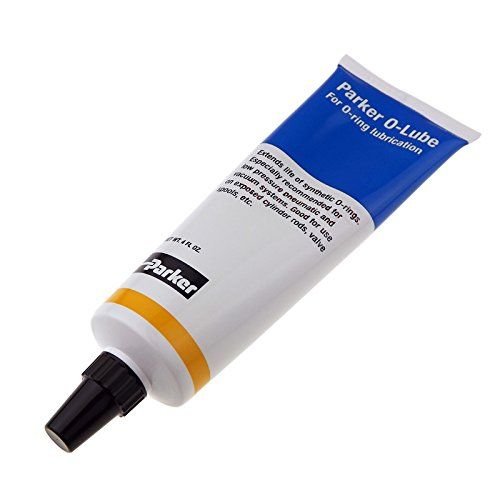

Dryer is a great start. Replacing all the o-rings, and of course coating the replacement o-rings with appropriate lubricant during installation.
Air bag systems are a basic system. Replacing the dryer regularly is a real good preventative maintenance activity. People often suggest the air springs (bags) have a ten year life expectancy, but I have never seen any data to back that up.
