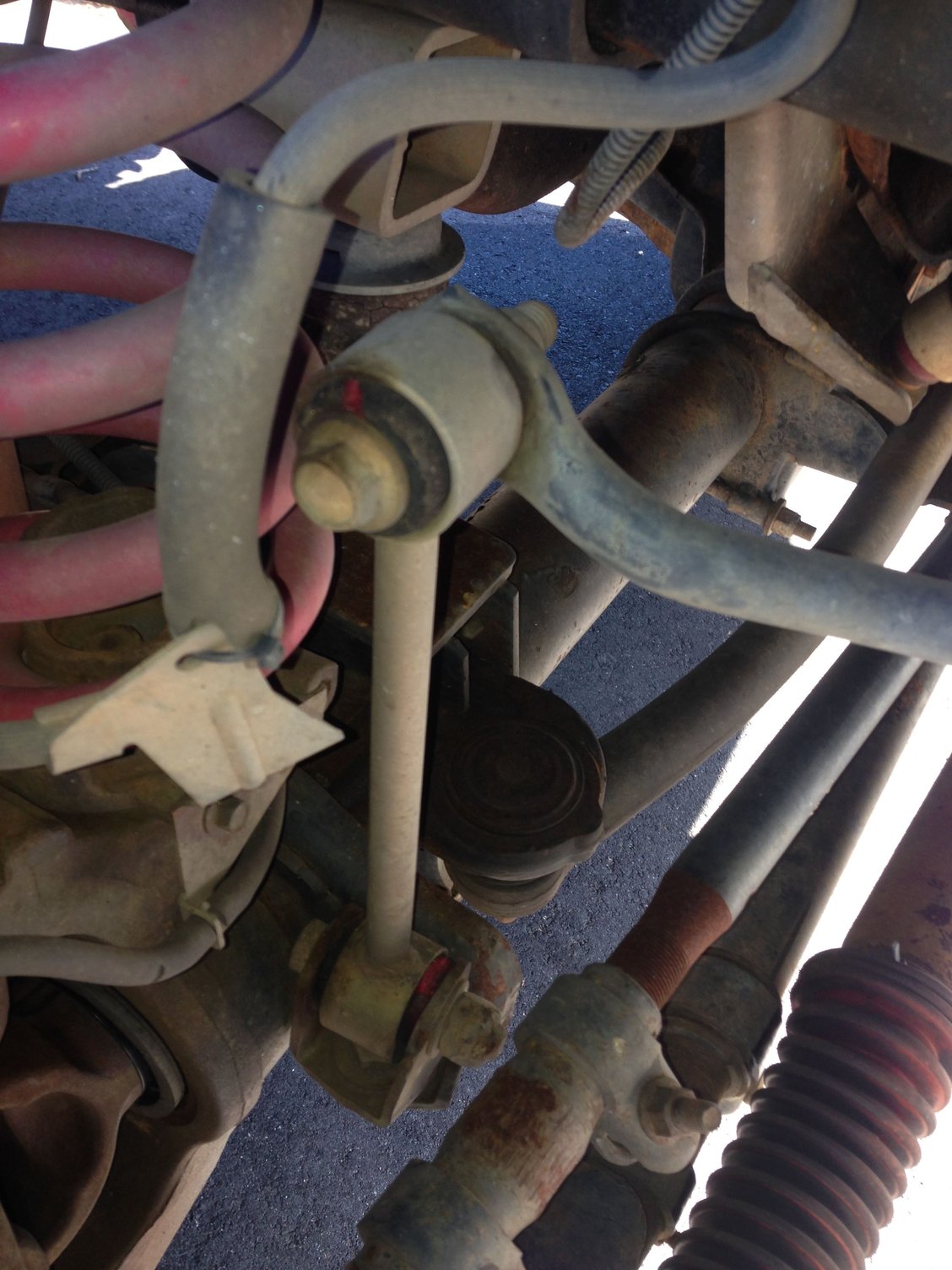

this is probably a really simple question but I can't seem to find out what the name of these rubber bolt covers are or if anyone sells like a pack of 2 or 4 of them. Does anyone know the actual name or who sells them?
This one is missing and making a noise when I hit bumps. Probably just going to replace all of them they look to be in bad shape
Here is one I need the piece the bolt is inserted through

Not sure what you are refering to, but if it is the vertical piece with the 2 round ends at 90 degrees to each other, those are the stabilizor bar links. I have never found replacement rubber bushings for them, they come as an assembly ford part number 6C3Z-5K483-AA about $55.00 each at Autonation Ford for an 05 F250 4X4 possibly cheaper from the aftermarket. They are also available with polyurethane bushings which are tougher than stock from several suspension companys.

So you have to buy the whole bar? You can't just purchase the bushings?

Check out energysuspensionparts.com

What year is your truck and who made the lift? Is that bottom bracket bolted on to the axle? The bottom of the link should be a two piece bushing.
