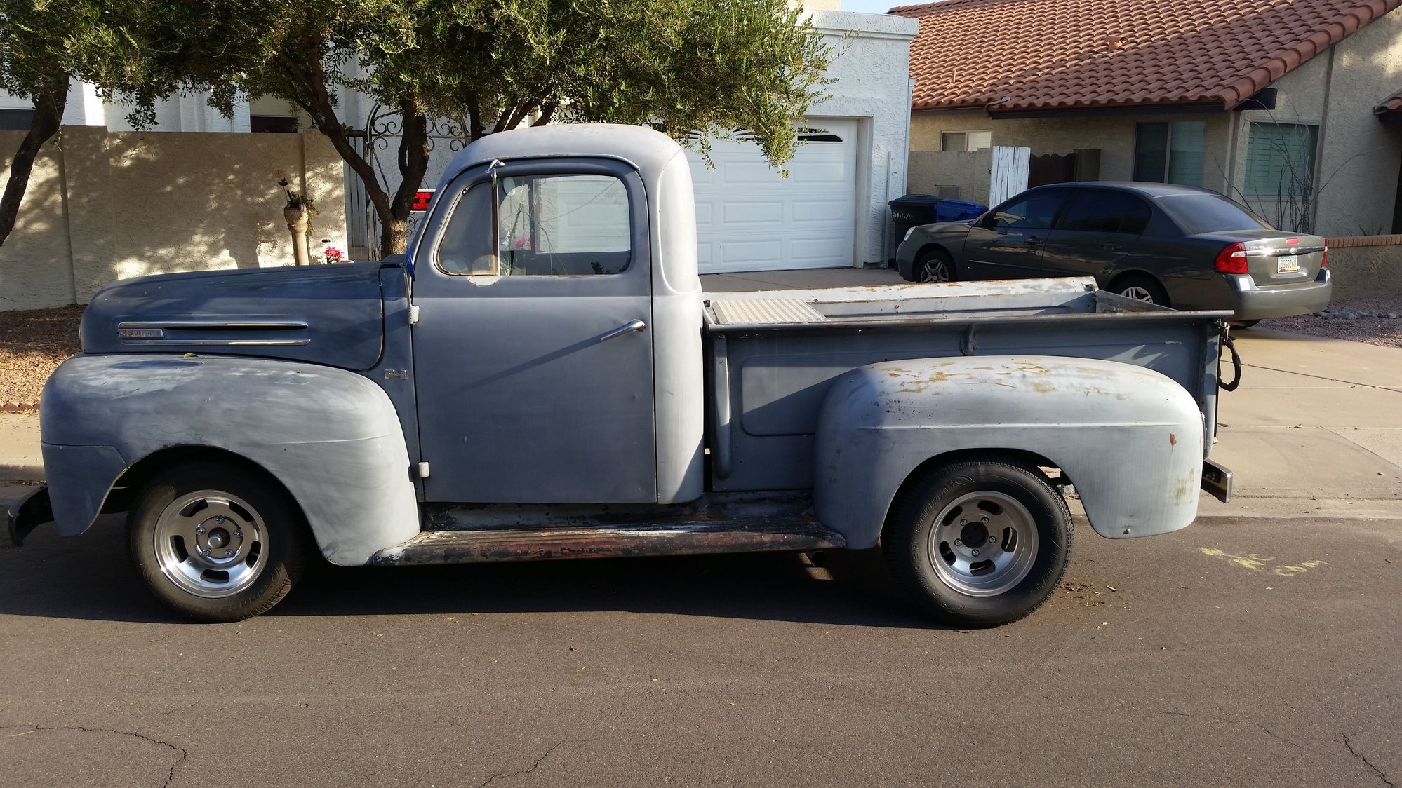

Nice side view. I like the hotrod look
Nice wide tires, but no tubs needed.

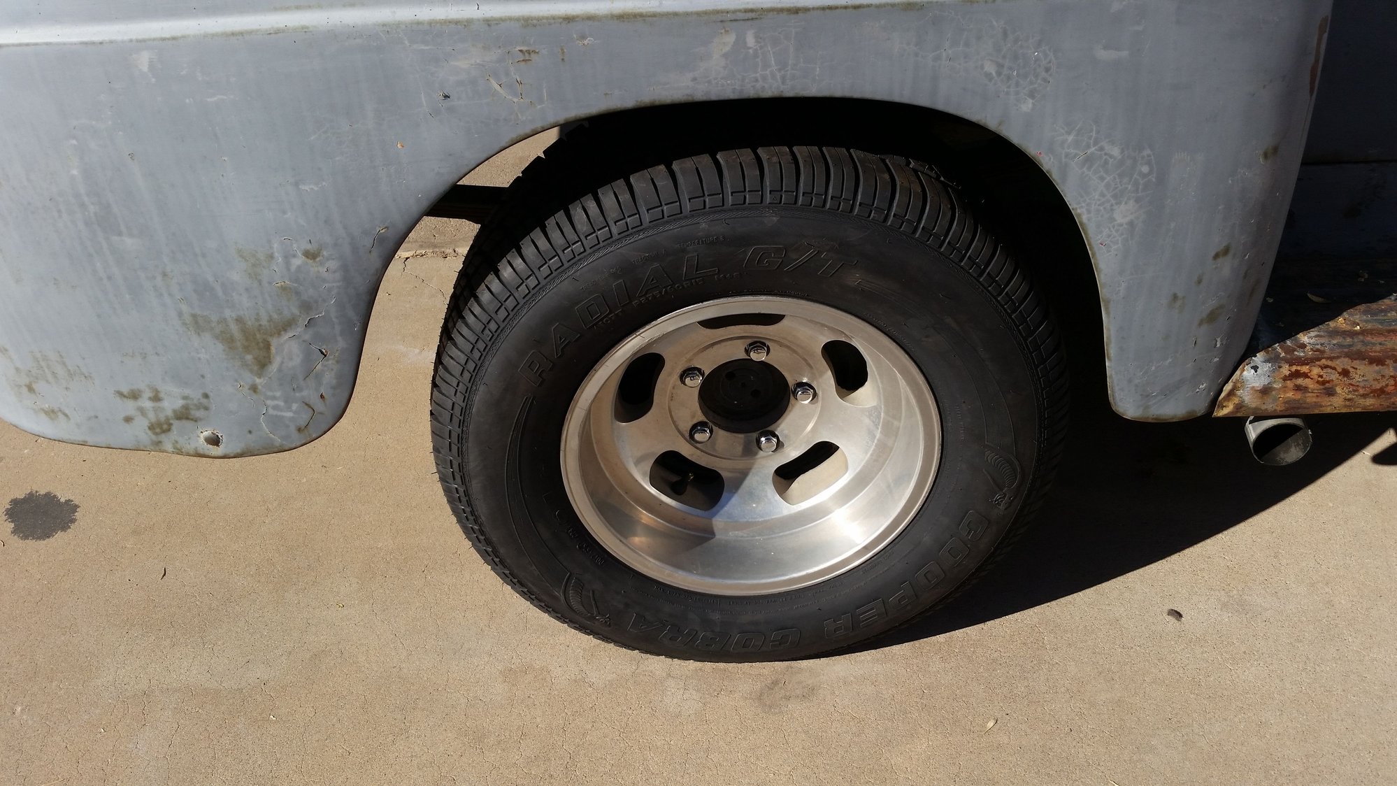

275/60R15 rear tire files up the wheel well
235/60R15 on front
On my '49 F1 I'm running 275/60R15 (15x8.5 wheels) on the back of mine and I love them... the fronts are 235/60R15 (15x7 wheels).
Specs on your 205/75/15
Dia : 27.1"
Width: 8.1"
Side Wall: 6.1"
My 275/60R15 (Rear)
Dia : 28"
Width:10.8"
Side Wall: 6.5
My "Correct tire size" 235/60R15 (Front)
Dia : 26.1"
Width: 9.2"
Side Wall: 5.5"
Last edited by Moe Craig; Oct 17, 2016 at 02:20 PM. Reason: Put down my old tire size

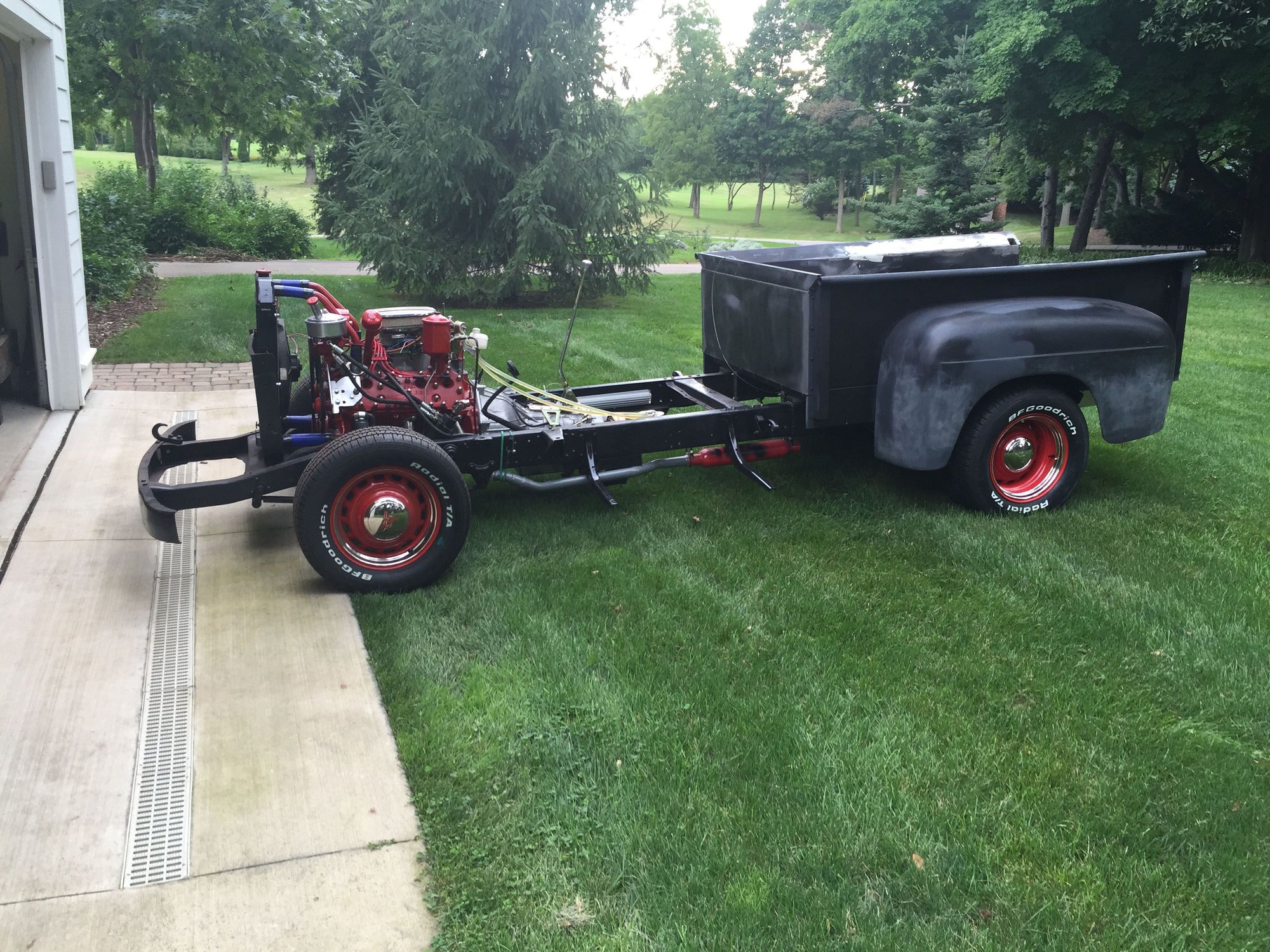

How close is your tire to the box side Moe, once I have this truck of my reassembled I'll be needing to size up rims and tires, I like the width you have out back..

56panelford, I have an 1-1/2" between the tire sidewall and bed side... I have a Ford 9" rear end...
Correction on front tire size P235/60R15. The tires are Cooper Radial GT.
