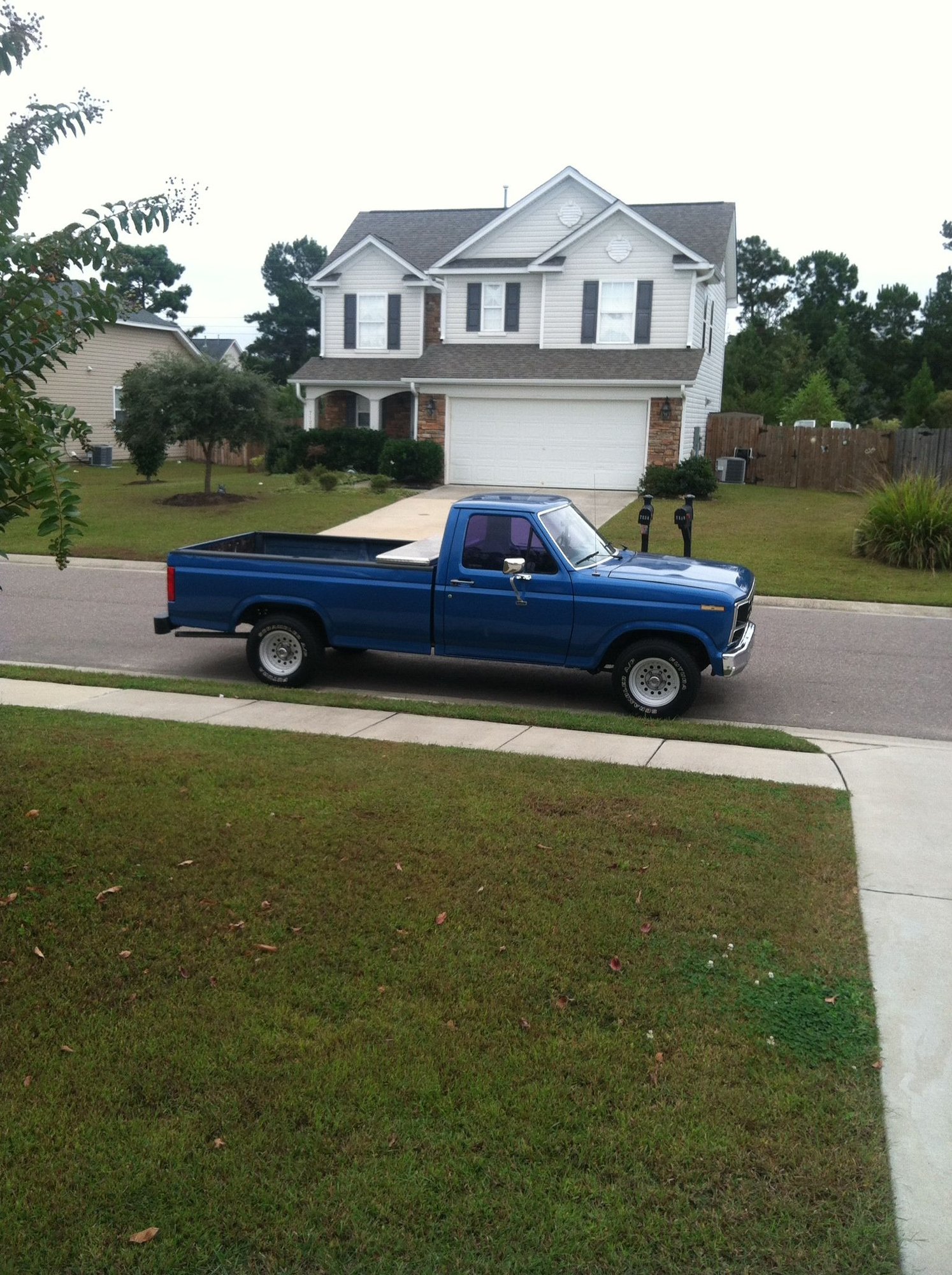

Posts: 412
From: sc
well i was able to get these photos added. that is the bracket that lokar had that would fit the demon carb to hold their cables on. they told me that the other bracket wouldn't work due to the way the carb was made but i don't know & at the time i didn't feel like taking any chances so i bought it. that front bracket is just a return spring bracket that i haven't removed for some odd reason but, it will be removed soon.
Old Oct 17, 2016 | 06:42 AM
ladelld33's Avatar
ladelld33
Joined: Jun 2008
Posts: 412
From: sc
here's what i'm working on..

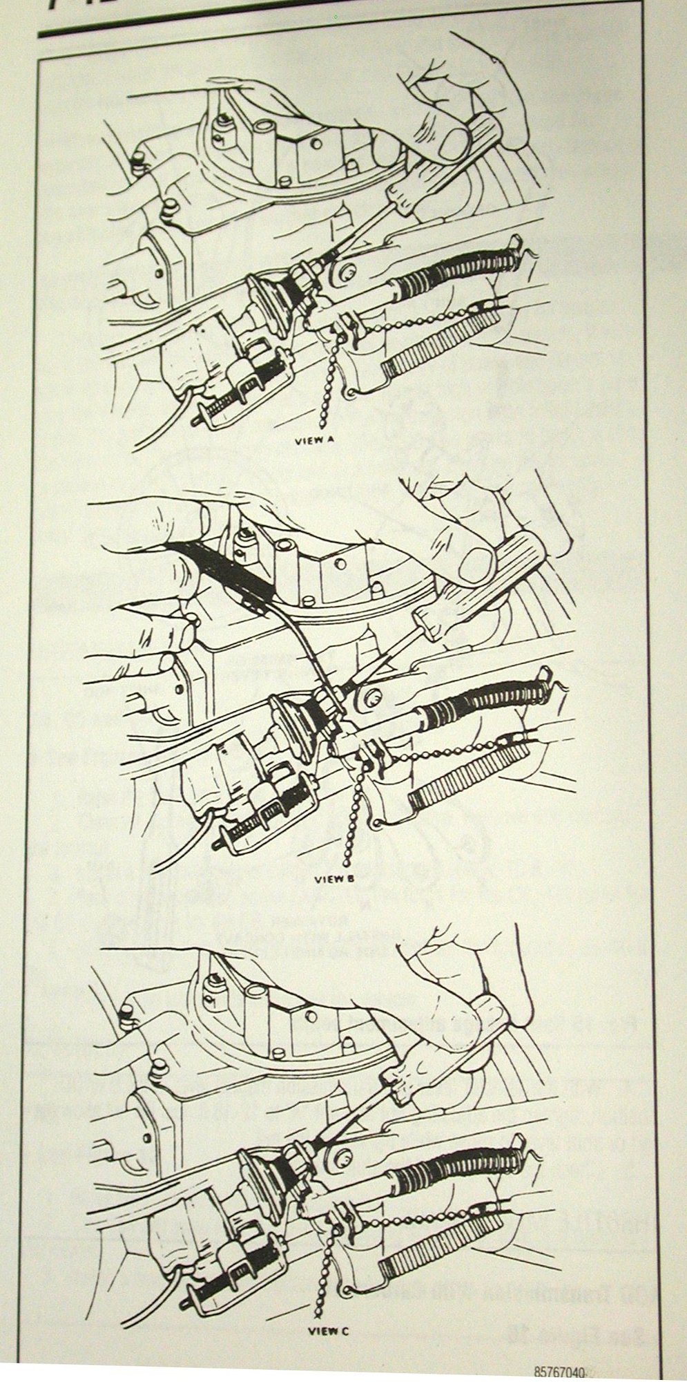

The AOD is not included in the 1981 shop manual. But, it is in the Chilton book I have, with the following instructions:
