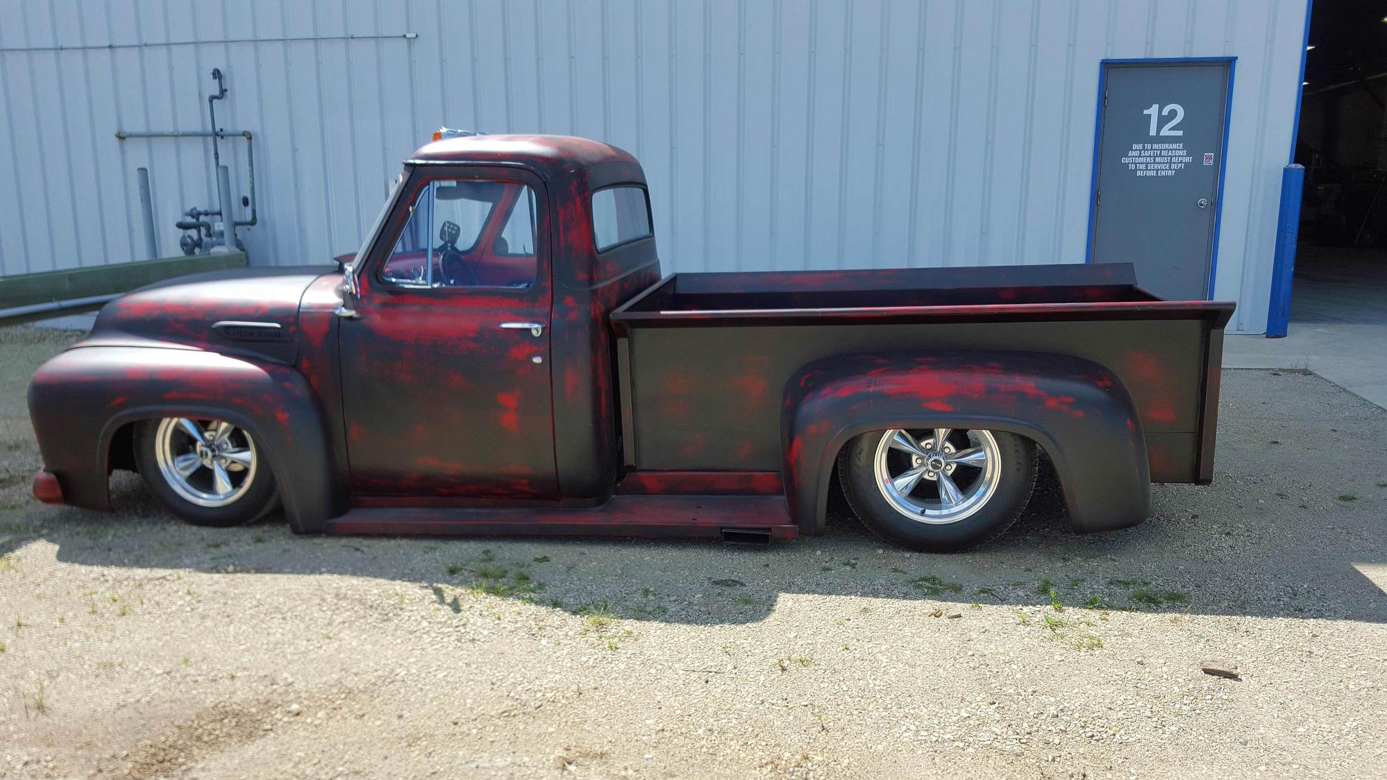

I've built a few bagged trucks, the latest is using an s10 chassis,my running boards are 3/4 inch off the ground up front,
1st figure out your tire height, 17 inch rims can have the same tire height as 15 inch(just as an example ) tire height has a significant effect on how low you can go! The rest is pretty easy! What front end are you using?

Here's a pic of how low mine sits!
