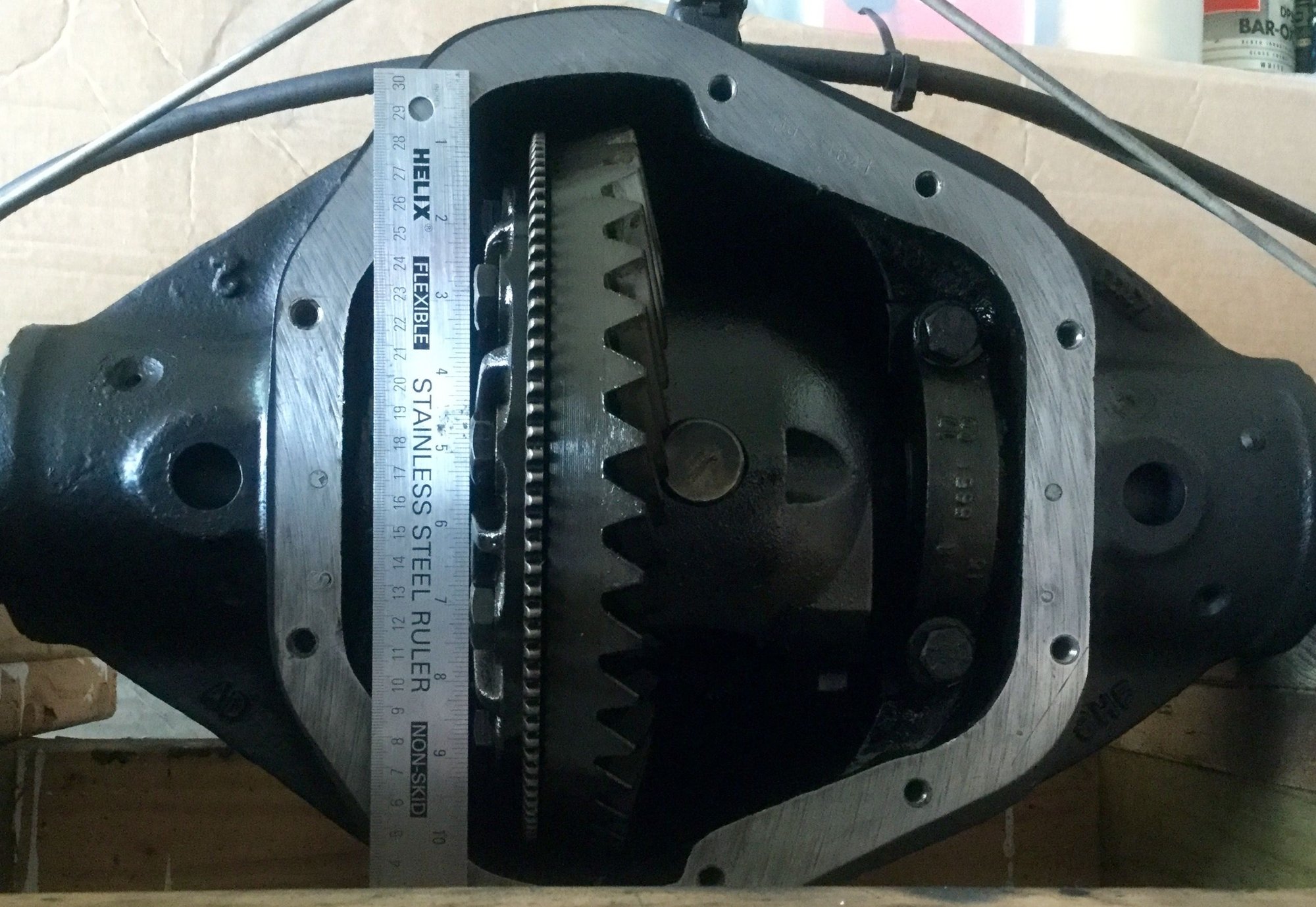

That'll work great! Here's the D70 FF Wide Track opened up:
