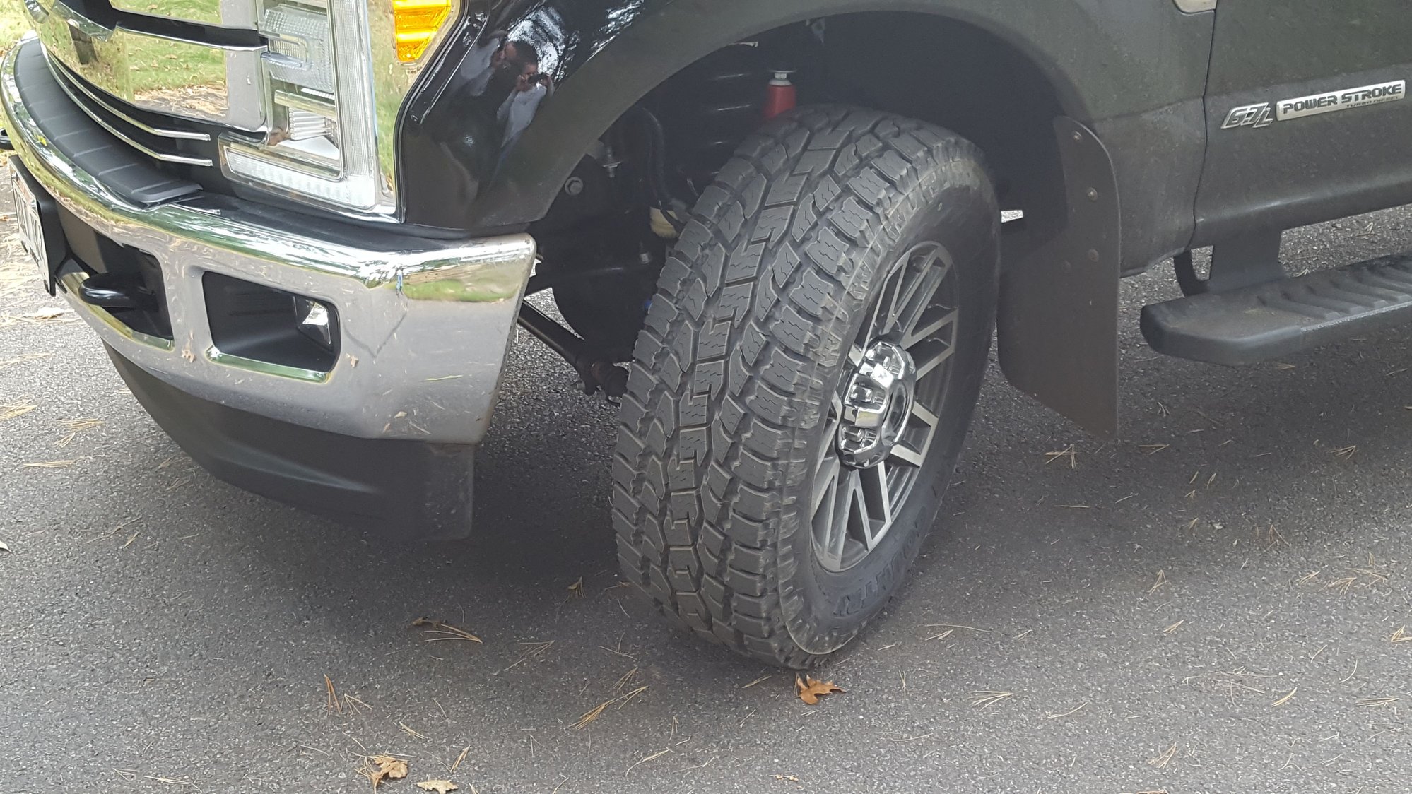

Originally Posted by Bat4x4
Toyo at 2 they are 35.1 compared to the 295 mud terrain is 35.4
295 65 r20 fit perfectly, no rubbing.
M

Are the factory michelin at/2's any count for light mud and what not? Ive heard that the original at's werent all that great, but the at/2's are better. Im not the type that goes looking for mud but would like to be able to get through the light stuff when i have to.
Old Oct 14, 2016 | 08:01 PM
PFG's Avatar
PFG
Joined: Mar 2016
Posts: 262
Thanks for the pictures Bat. The 295s match up well with the 20s. Nice proportions of tires and wheel.

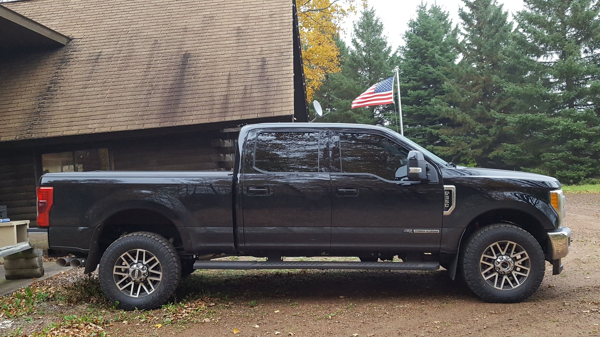

Bat, can you take a full side shot of the truck?
I like em!
I like em!
Old Oct 15, 2016 | 12:24 PM
Mayberry's Avatar
Mayberry
Joined: Jun 2016
Posts: 129
From: SEC Country
Awesome! Thanks. Looks as good as I had hoped.
I like the size for a non leveled truck. Looks like this is my answer!
Thanks.
Good looking ride.
